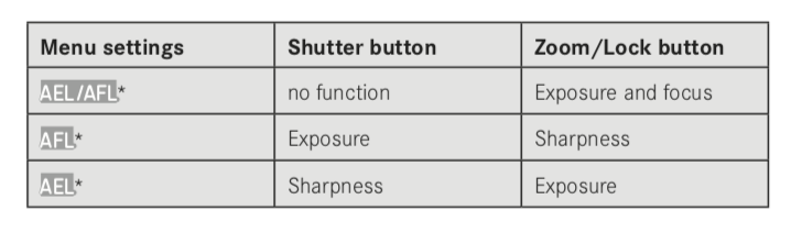

On 3/10/2019 at 6:19 PM, jonoslack said:
Hi There
That’s what should happen, but it isn’t what does happen - the focus (or Exposure) is only removed from the shutter release While You Are Pressing the Zoom lock button.
1 Example with static exposure point and Zoom Lock button set to AFL
2 point the cross at granny’s nose
3 press the zoom lock button to focus
4 Let go of the zoom lock button
5 point the cross at the tree out of the window
6 press the shutter and the camera will re-focus on the tree outside.
If in 4 you keep the zoom lock button pressed then focus will remain on Granny.
All the best
Jono
Does anyone know whether that behavior has changed to proper back button focus behavior? In other words, to
6) press the shutter and the camera will NOT re-focus and keeps the granny's nose in focus (given Ms Granny did not move around ...)

Better late than never?  I was curious as well and just read through this conversation.  On the new Q2M, I can use the back button for focus and do not need to hold it.
In the menu, set Customise Control, Zoom/Lock button to AF-L.  Then turn the focus ring to AF.  Press the back button and it focuses.  When I then half-press the shutter button, it does not refocus.  (It does close down the aperture and lock exposure, so it may seem to focus if you had set a narrow aperture...).  After taking a photo it will start afresh and if you don't focus with the back button, the shutter button will also trigger focus.
Finally, I noticed I may need to hold the back button for a moment until it establishes focus.  A very short press does not always work.

The implementation in Q2 and Q2M is not what is conventionally called BBF. BBF completely disables focusing via shutter and triggers AF every time the rear button is pressed.

I would say it is implemented as designed. You do not need to hold the button, one press locks the focus ... until you half-press/press the shutter. Yes the button is tiny, but it worked OK for me on Q.
Unfortunately on the Q2, even with the latest software, this is not the case. Unless one keeps the back button pressed it refocuses when one presses the shutter button. It surprises me that this is not the case with the Q or the new Q2M
2 hours ago, RoySmith said:
Unfortunately on the Q2, even with the latest software, this is not the case. Unless one keeps the back button pressed it refocuses when one presses the shutter button. It surprises me that this is not the case with the Q or the new Q2M.
My Q2 works the same as my Q2M. Assign AF-L to Zoom/Lock button, press once to lock focus. Pressing the shutter to take picture does not refocus, but it unlocks the focus.
Gosh, this is so confusing for this simple photographer.
So, Assign AF-L to Zoom/Lock button, press once to lock focus. Then the shutter button will not refocus  and the shot is taken with the pre selected focus point. Please tell me this is the case, as in any half decent back button focussing set-up.
Apologies for reviving this old thread, but for someone who has been considering buying a Q2 this has been a concern.
When you assign AF-L to Zoom/Lock button, pressing the button will focus and lock focus until you take a picture. After taking a shot, the focus will be unlocked and activated via the shutter button unless locked again with the Zoom/Lock button.
With multiple shots, you have to lock the focus repeatedly. It is not the typical BBF behavior.
