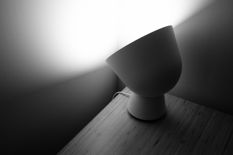

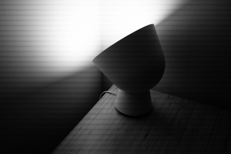

hteasley Posted August 12, 2018 Share #1 Â Posted August 12, 2018 Advertisement (gone after registration) So I set the electronic shutter on the CL, for completely silent shooting, and a bunch of photos have bad banding in them. I took a few of my daughter on the couch, and saw terrible banding: Â https://www.dropbox.com/s/4wizwu0llbr9bw5/electronicshutterbug1.png?dl=0 Â I didn't suspect the electronic shutter, but just now, I was just testing some things out, and I saw it again, and I thought to try to find the culprit, and it is indeed the electronic shutter. Below is the same scene, without and with electronic shutter. Â https://www.dropbox.com/s/b05mutst08q4yhn/electronicshutterbug2.png?dl=0 Â I'm guessing this might be an "electronic shutter + certain artificial lights" thing: the first, my daughter is a few feet away from a large television, and the the test images, I have a couple computer monitors behind me that might be influencing the scene lighting, so maybe it's a 60hz refresh thing. Â But I hate it, as all right thinking people should. Even if it is only in certain circumstances, neither of these were photos where it would have occurred to me to change the shutter setting because of the lights present. Which means I'm just not going to use it. Pity, as it's nice and silent. Link to post Share on other sites More sharing options...

FrozenInTime Posted August 12, 2018 Share #6 Â Posted August 12, 2018 When using sequential read electronic shutters under artificial electronic lighting, the shutter speed needs to be low enough to average out the flickering. The light here is an Ikea electronically dimmable LED Â Â Â The one with banding is 1/160s , without 1/13s on TL2 ( CL will be the same ) Test your lighting ... you may be okay at half the AC line frequency. Link to post Share on other sites More sharing options...

scott kirkpatrick Posted August 18, 2018 Share #14  Posted August 18, 2018 Looking back to the earlier posts in this thread, I see two very different effects. The usual LED banding is at twice the power line frequency, which for 50 or 60 Hz gives you 5 or 6 horizontal black lines. The Ikea dimmable LED shots in the first post of this thread have many more bands, and the effect is weaker. I understand that that is because the dimmable LEDs change the average light intensity by cycling the lights in short pulses at a much higher frequency than the line frequency. Here's my example of the 2X line frequency effect:  C1080026 by scott kirkpatrick, on Flickr Link to post Share on other sites More sharing options...
