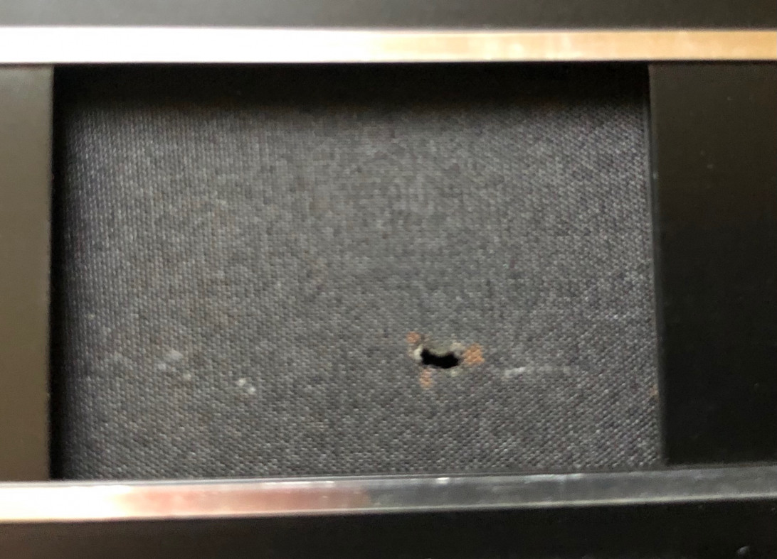

Advertisement Posted August 24, 2017 Posted August 24, 2017 Hi pico, Take a look here I burnt through my shutter cloth :(. I'm sure you'll find what you were looking for!
Ronazle Posted August 24, 2017 Share #42 Posted August 24, 2017 (edited) If you are prepared to drive about an hour from Antibes to Tourtour, I could lend you another film Leica, say an M4 or CL. Wilson Wilson, How very decent of you. Regards, Ron For the non-oldsters among the readers: The sun/shutter problem plagued Leica most of its life; obviously the lightweight cloth shutter had numerous advantages. The Contax advantage was the metal shutter in those years. My IIIC had a locally applied square patch on the shutter all the time I owned it. ron Edited August 24, 2017 by Ronazle 1 Quote Link to post Share on other sites More sharing options...
