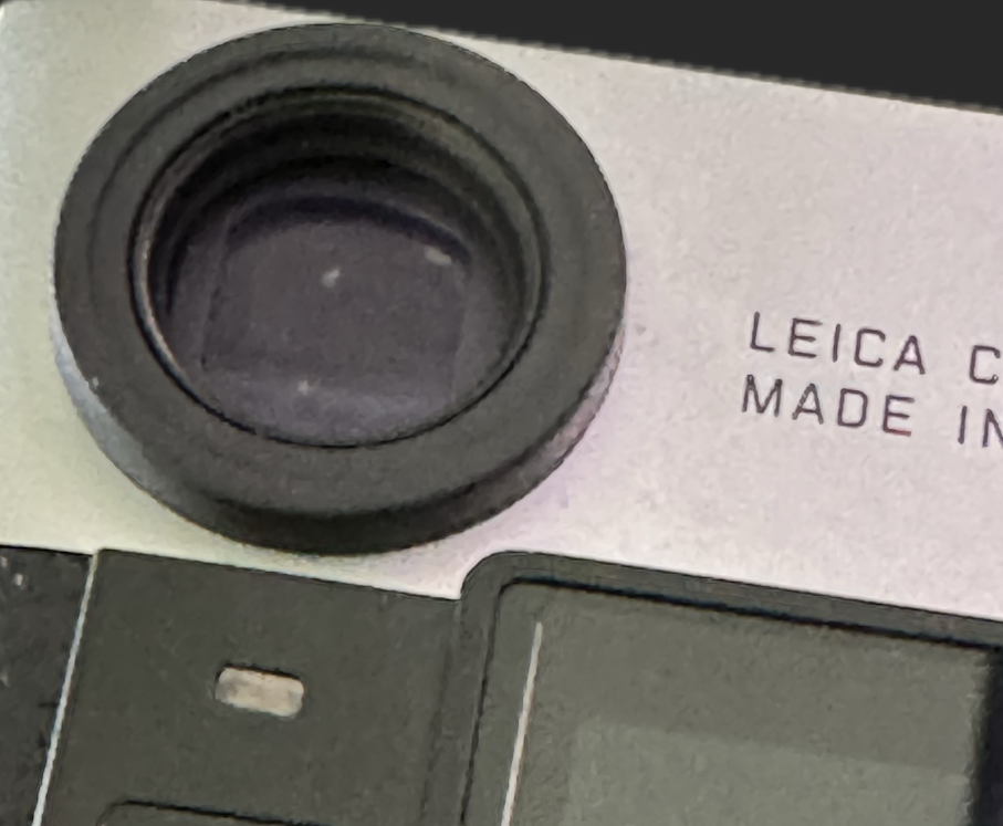

microCuts Posted August 25, 2024 Share #50 Posted August 25, 2024 My M10 has a few white spots on the viewfinder. I opened the top plate and wiped the viewfinder cover glass, managed to clean a few spots. However, there are also spots lied inside the viewfinder glass, not outside. Anyone has experience disassemble the viewfinder? I mean just tear down a few pieces maybe so I can clean the inner part of the viewfinder. Also any know which cable on the top plate responsible for the viewfinder numbers (digit) display? Mine has a character missing a segment.. Link to post Share on other sites More sharing options...
jaapv Posted August 25, 2024 Share #51 Posted August 25, 2024 A missing segment is normally caused by a defect on the display itself. The viewfinder does not need disassembly to clean. Nor do the flex cables need to be disconnected. Just raise the top a few mm and use a blower. Look at Mark Norton’s “anatomy” thread. Link to post Share on other sites More sharing options...

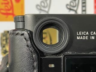

microCuts Posted August 25, 2024 Share #52 Posted August 25, 2024 (edited) 2 hours ago, jaapv said: A missing segment is normally caused by a defect on the display itself. The viewfinder does not need disassembly to clean. Nor do the flex cables need to be disconnected. Just raise the top a few mm and use a blower. Look at Mark Norton’s “anatomy” thread. Welcome, dear visitor! As registered member you'd see an image here… Simply register for free here – We are always happy to welcome new members! You mean this part? Yes I managed to wipe this part (photo borrowed from another post), however there are still spot visible..likely located on the other side of the glass, the inner part. This is how mine looks like. I already assembled back the body. See the spots? Don't look like dusts for me..maybe oil? Hopefully not fungus... Edited August 25, 2024 by microCuts Link to post Share on other sites Simply register for free here – We are always happy to welcome new members! You mean this part? Yes I managed to wipe this part (photo borrowed from another post), however there are still spot visible..likely located on the other side of the glass, the inner part. This is how mine looks like. I already assembled back the body. See the spots? Don't look like dusts for me..maybe oil? Hopefully not fungus... ' data-webShareUrl='https://www.l-camera-forum.com/topic/273041-dust-in-m10-viewfinder/?do=findComment&comment=5500607'>More sharing options...

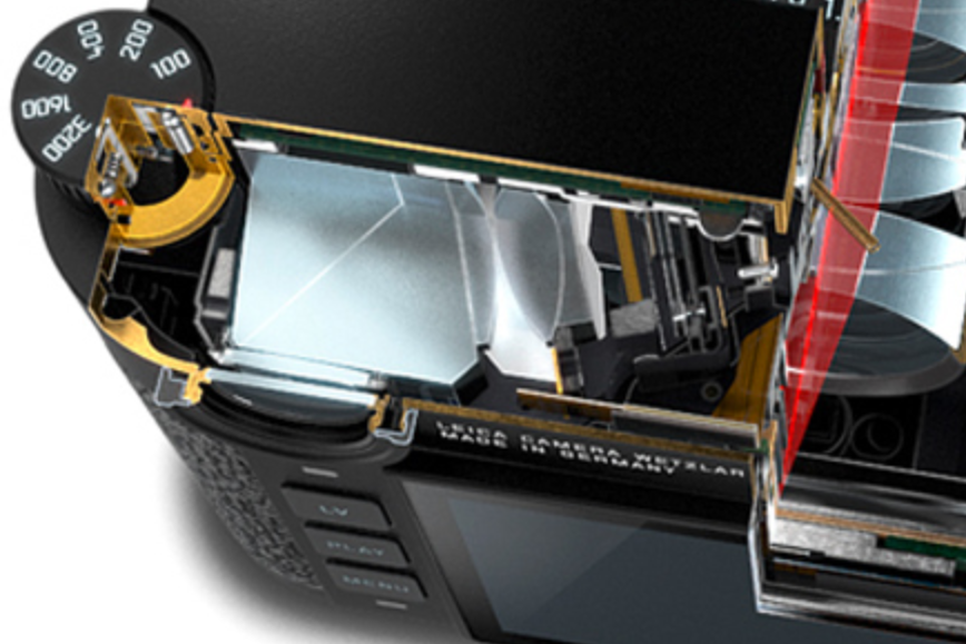

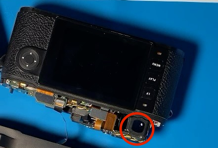

yukosteel Posted August 26, 2024 Share #53 Posted August 26, 2024 If there is a suspicion of possible fungus, I'd use UV lamp or direct Sun light to kill it. The finder diagram is showing area mounted to the top plate as a single glass element on Leica site: https://leica-camera.com/en-US/node/3468 Welcome, dear visitor! As registered member you'd see an image here… Simply register for free here – We are always happy to welcome new members! I'd check the rear surface of the glass, most likely it should be possible to clean the spot from the inner side. I had a white spot under the front finder glass of my previous M10, and sent it to Leica US for cleaning, but spot remained there after service. So I opened top plate and simply wiped the spot in similar way like wet cleaning of camera sensors but only in the corner area. Link to post Share on other sites Simply register for free here – We are always happy to welcome new members! I'd check the rear surface of the glass, most likely it should be possible to clean the spot from the inner side. I had a white spot under the front finder glass of my previous M10, and sent it to Leica US for cleaning, but spot remained there after service. So I opened top plate and simply wiped the spot in similar way like wet cleaning of camera sensors but only in the corner area. ' data-webShareUrl='https://www.l-camera-forum.com/topic/273041-dust-in-m10-viewfinder/?do=findComment&comment=5503034'>More sharing options...
