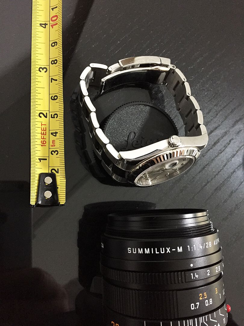

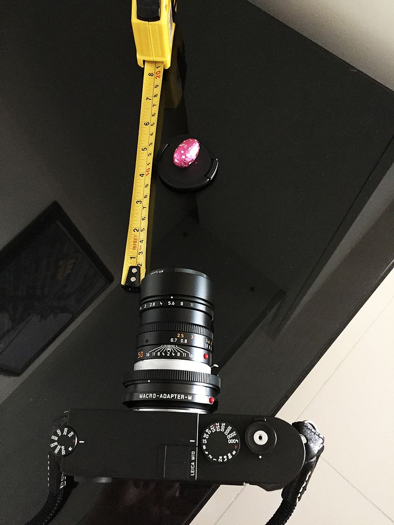

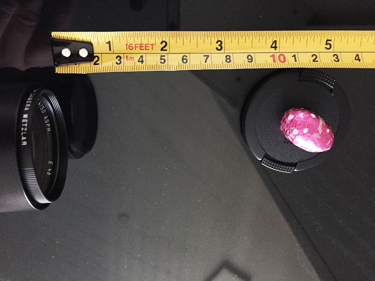

Magic Posted April 21, 2017 Share #13 Posted April 21, 2017 (edited) Grey is all the theory..... This is the image: (M10, Summilux 50mm, Macro Adapter fully extended, f=5.6, 1/15s, ISO6400, in Photoshop only resized): Here is the setup: ...and the result....tadaaa.... (apologies for the dust) Edited April 21, 2017 by Magic 2 Link to post Share on other sites More sharing options...

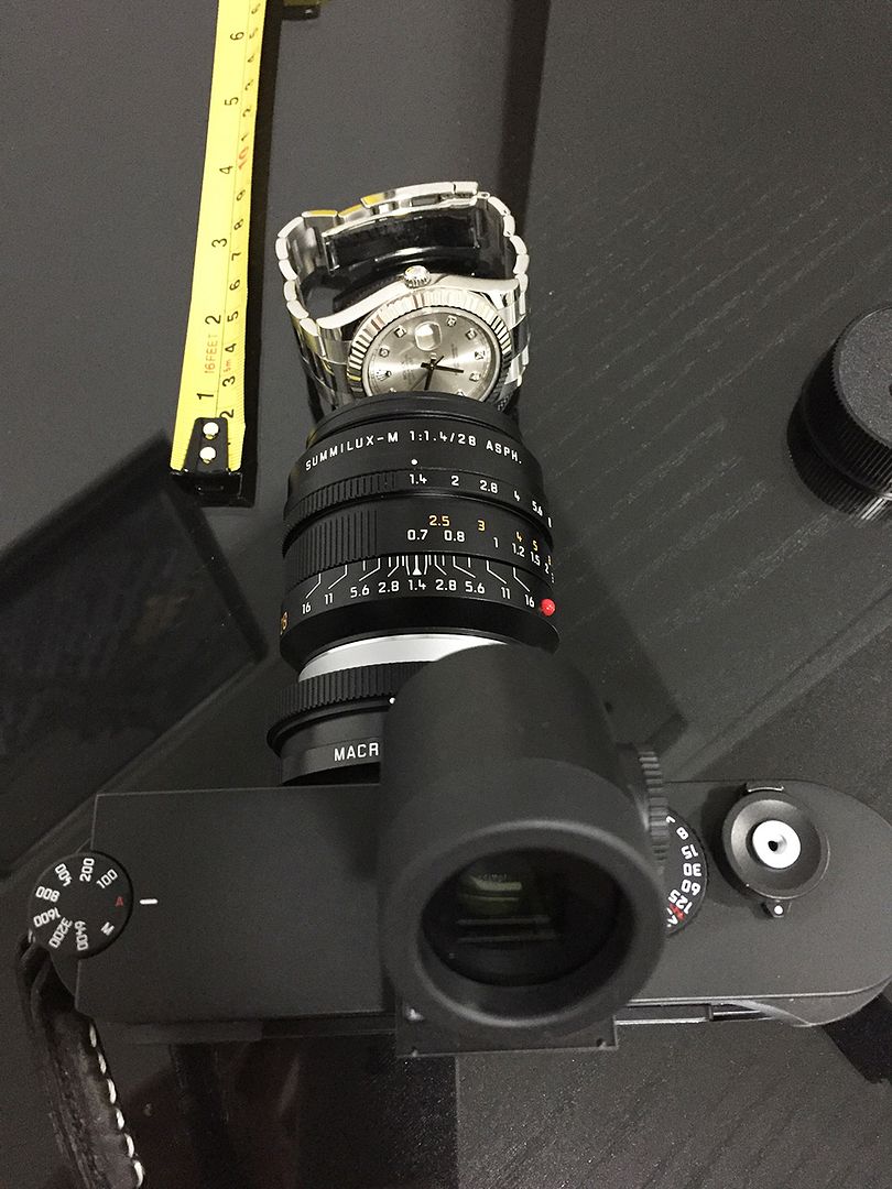

Magic Posted April 24, 2017 Share #20 Posted April 24, 2017 (edited) I know this was not the question but I was curious to try out the Summilux 28.... (focus on the "O" of "ROLEX"), f=1.4, ISO 800, 1/60s setup: (the Visoflex 020 is phantastic...) result: Edited April 24, 2017 by Magic 2 Link to post Share on other sites More sharing options...
