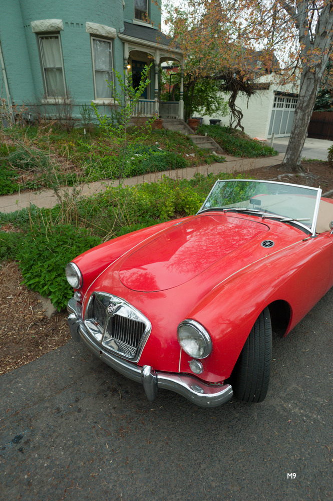

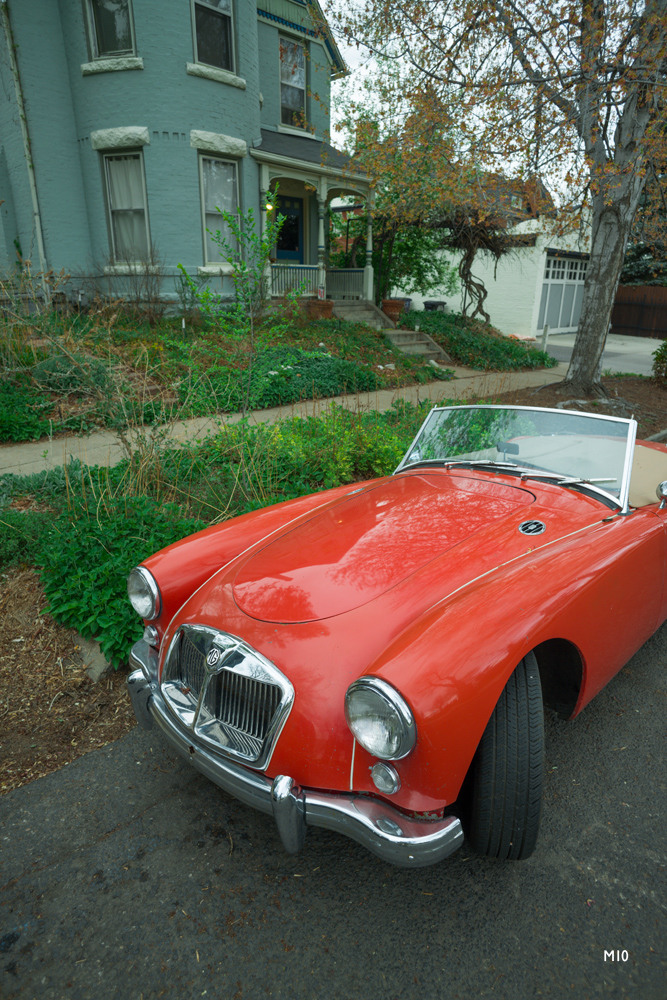

As a followup to the above, here are sample pix I made with the M9 and my new M10 in 2017. Both are processed identically, with the default "embedded" (i.e. from Leica) color profiles.
To go back to my color-space "room" and color profile "moving the furniture" analogies:
The M9 profile "moved" the car's oranges towards red (inaccurately), while moving the foliage and house greens towards yellow.
Or conversely, the M10 profile "moved" the  greens towards cyan/blue a bit. While capturing the car's orange color perfectly.
The M9 has more contrast and saturation, the M10 opens up the shadows under the porch and trellis just a bit (but that lower contrast desaturates most of the colors).
The M9 has a slightly yellower native "white point."
The differences are not large though. Playing with the Camera Calibration sliders for hue, and the Basic sliders for contrast and saturation (in the post-processing software - LR, ACR, etc.), could make either picture look like the other. That constitutes the photographer going into the "room" and "moving the furniture" him/herself. Which moves can be saved as a new custom camera profile, to be applied to any picture in the future..
I must be ever so slightly color blind because it is very difficult for me to distinguish the green house and the hues. To test this, I showed my wife without telling her and she was able to pick out the hues instantly, barely having to look. Thanks for the posted examples.
Triple wow!!!!   I eventually got to see what you mean, but I couldn't get my eyes off your MGA!!!!!!   I used to own a 1960 MGA, and now I essentially own the same car but without needing a mechanic in my back pocket, a 2012 Mazda MX-5.
About your photos - from what I read, the M10 is very close, and the M9 has issues.  Is this fixable in-camera?  I doubt it, as if you're shooting raw, the data on the sensor doesn't know anything about color, it just records the sensor data.
