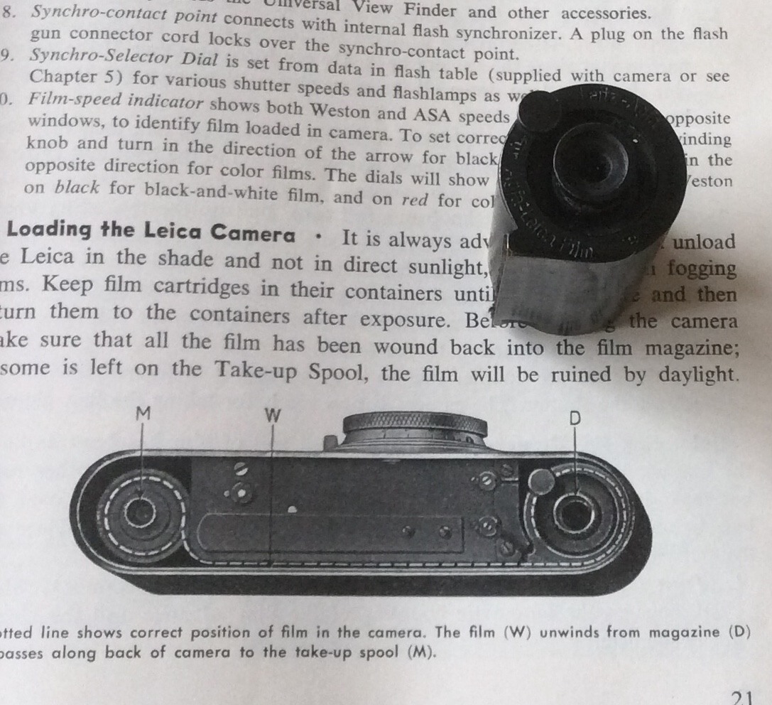

Pyrogallol Posted April 27, 2019 Share #50 Posted April 27, 2019 (edited) I just bought a Leitz-Agfa cassette and then noticed that this is the shape of cassette that appears in the Morgan and Lester manuals in the illustration of the film path through the camera. The same illustration was used up to the 1950’s and possibly only dropped when they started illustrating the M series cameras. The top brass end of the cassette will unclip, but the leaflet shown above in post #44 describes it as only to be used once and “torn open”. Welcome, dear visitor! As registered member you'd see an image here… Simply register for free here – We are always happy to welcome new members! Edited April 27, 2019 by Pyrogallol 1 1 Link to post Share on other sites Simply register for free here – We are always happy to welcome new members! ' data-webShareUrl='https://www.l-camera-forum.com/topic/255938-filca-a-b-and-c-wheres-d/?do=findComment&comment=3730431'>More sharing options...
TomB_tx Posted April 27, 2019 Share #51 Posted April 27, 2019 Yes, I have a couple of these now, and they are nicely made in brass and intended for re-use. I’ve read that these were introduced with the model II Leica, and that early on the Leica II purchase included 2 of these cassettes, and that the Leica baseplate of these models had no “key” to operate the FILCA cassette. (Although the baseplate has generally been upgraded to work with FILCA by now.) The period where the D cassette was used was quite brief. Leitz then went back to the B version, which is the only one that actually used the FILCA part number. The construction is quite unlike the Leica made A, B, & C cassettes, and I’d guess these were provided to Leitz by Agfa to promote Agfa film. I believe Agfa sold pre-spooled film, paper wrapped, to easily refill the D cassettes. I notice the small round button on the lower end of the D is positioned so it hits the baseplate probe on the Leica that normally unlocks the FILCA latch spring. On the D cassette this keeps the shorter D positioned high enough so the film centers in the film rails, preventing the cassette moving down “off the rails” as can happen with conventional pre-loaded cassettes. I notice these D cassettes fit my Ia (converted to II) better than my A or B cassettes. 1 Link to post Share on other sites More sharing options...

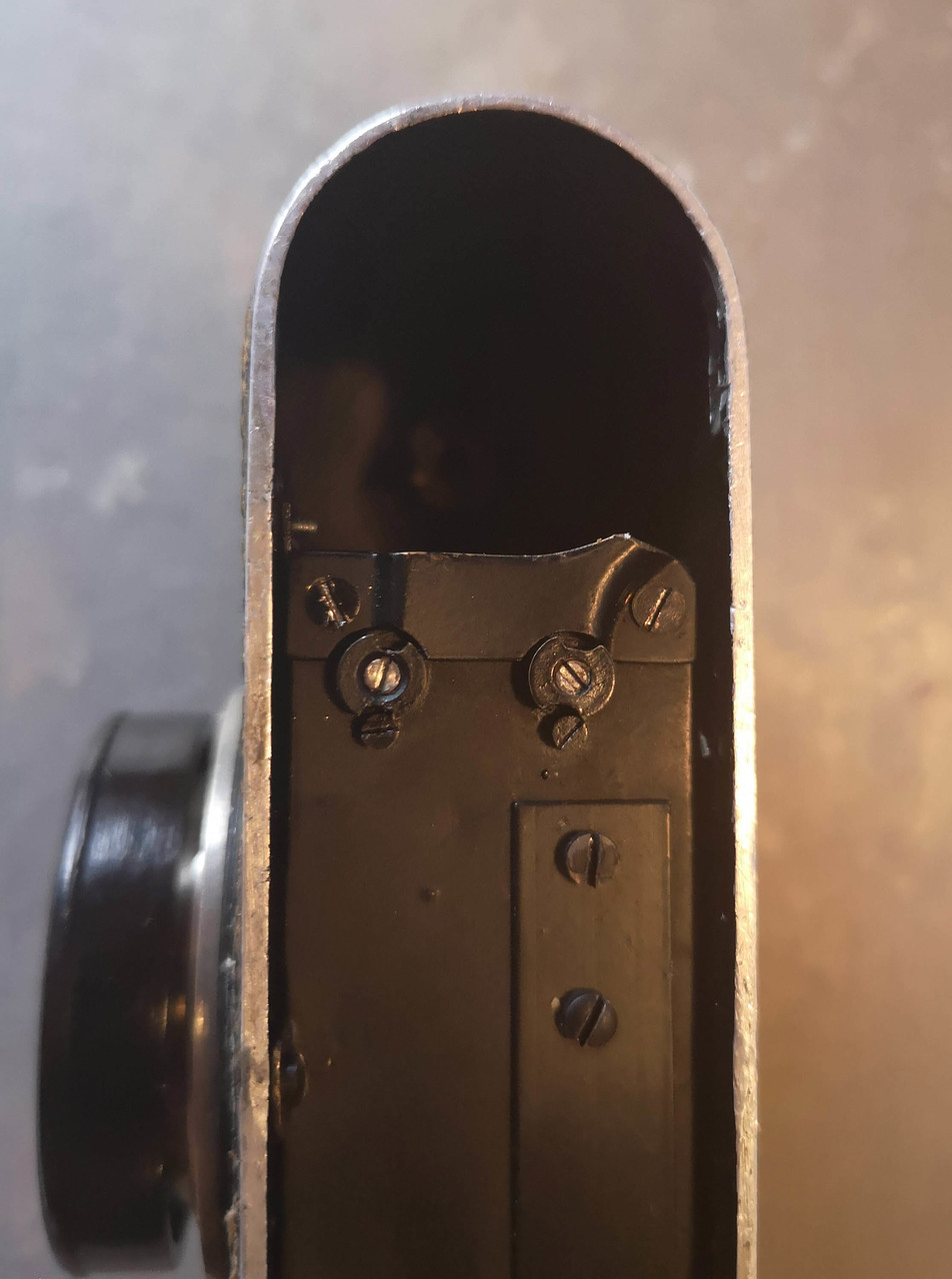

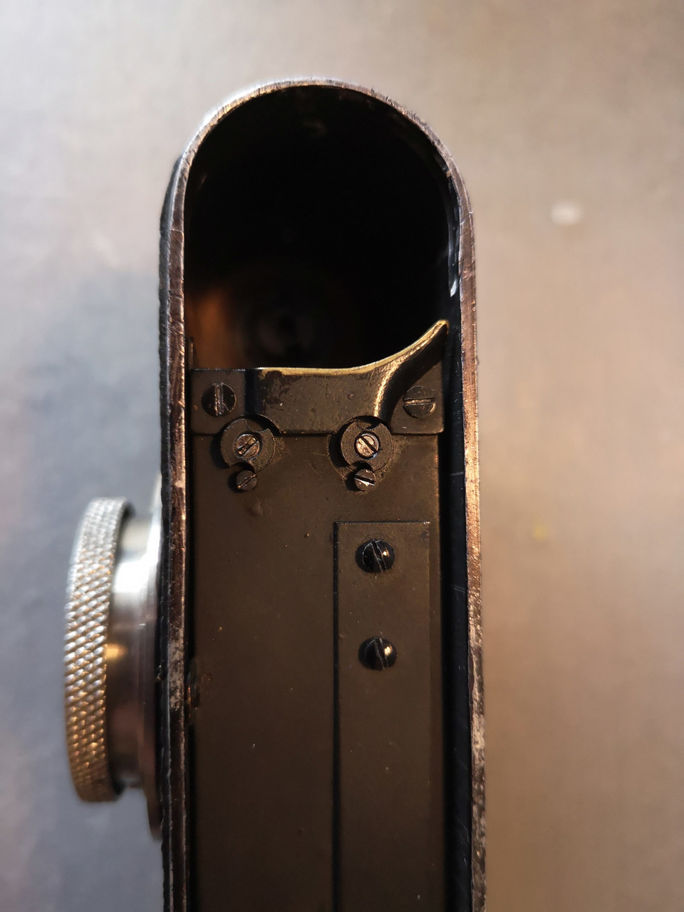

Anbaric Posted January 31, 2021 Share #54 Posted January 31, 2021 (edited) On 10/13/2018 at 1:37 PM, willeica said: I should have asked Jim Lager about FILCAs when we were cruising down the Rhine together last Sunday. We discussed instead 'restorations' and 'special editions'. Neither of us liked these. Jim felt that my completely brassed I Model A SN 1661 had been stripped down with a view to a restoration, but that whoever owned it decided to sell it rather than to restore it. I like it in its brassed state and I also like the SN which reflects my 6th of June birthday. The previous owner had used FILCAs as it still had the long film clip, which would not allow a modern Kodak cassette to be inserted, as shown below. I swapped it instead for the shortened clip from SN 1783 which will allow a modern cassette to be inserted. I hope that the photos below are in the right sequence. The new website has made inserting images incredibly 'clunky' compared with the old website and does not, for example, allow text to be inserted around images. I hope that Andreas is listening. As for the D cassette, Alan posted a photo of what might have been one here some years ago, but I have not seen one confirmed as such. The FILCA C only lasted a few months and Leica then reverted back to the B. The D was then due to appear, but it seems to have been replaced very quickly by the Agfa Leica/Leitz cassette. I am not sure that Vith's book adds anything to the issue as it was presumably was based on information supplied by Leica. I hope that, eventually, the new Leica Archives will provide answers to what is fascinating little side avenue in the Leica story. William Welcome, dear visitor! As registered member you'd see an image here… Simply register for free here – We are always happy to welcome new members! Revisiting this thread, I'm curious about the change from the long locking device (which is I guess what the IIIa manual calls the 'V1 lock') and the shorter version ('V2 lock'). Did V1 work with all versions of the FILCA, or was it perhaps incompatible with the later versions? Did Leitz change from V1 to V2 purely to allow the use of disposable cassettes, or had they already done so, perhaps when they changed the FILCA? If the change to V2 was just to accommodate disposable cassettes, it seems a bit odd that these cassettes would be designed in such a way that the Leica would need to be retrofitted with the V2 lock. Perhaps there just wasn't a good way of getting this type of cassette to work without a redesigned lock, or there were by then several different marginally incompatible 35mm film chamber designs (Contax, Kodak, etc.) and at least one of them would have to be changed slightly so that a universal disposable cassette could be made? Edited January 31, 2021 by Anbaric Link to post Share on other sites More sharing options...
willeica Posted January 31, 2021 Author Share #55 Posted January 31, 2021 49 minutes ago, Anbaric said: Revisiting this thread, I'm curious about the change from the long locking device (which is I guess what the IIIa manual calls the 'V1 lock') and the shorter version ('V2 lock'). Did V1 work with all versions of the FILCA, or was it perhaps incompatible with the later versions? Did Leitz change from V1 to V2 purely to allow the use of disposable cassettes, or had they already done so, perhaps when they changed the FILCA? If the change to V2 was just to accommodate disposable cassettes, it seems a bit odd that these cassettes would be designed in such a way that the Leica would need to be retrofitted with the V2 lock. Perhaps there just wasn't a good way of getting this type of cassette to work without a redesigned lock, or there were by then several different marginally incompatible 35mm film chamber designs (Contax, Kodak, etc.) and at least one of them would have to be changed slightly so that a universal disposable cassette could be made? See my post No 47 above. I had to replace a 'long lock', presumably the V1 with a 'short lock' , presumably the V2, in order to use a modern film cassette in a 1926 I Model A. The Leitz Agfa cassette was one of the 'prototypes' of the modern film cassette and it would seem that at some point Leica accepted that was the direction of travel for future cassette design. I have a lot of FILCAs and cameras to check in order to confirm this eg, which have long and which have short locks (the latter being the majority, I imagine) and I also have quite a few FILCAs, maybe about 20. When I can find the time, I will check this. I recently checked a number of my 1930s cameras with the FILCA B, which contained my 70 year old Swiss Photos, and the FILCA worked in all of them, but some were more smooth than others. William 1 Link to post Share on other sites More sharing options...
