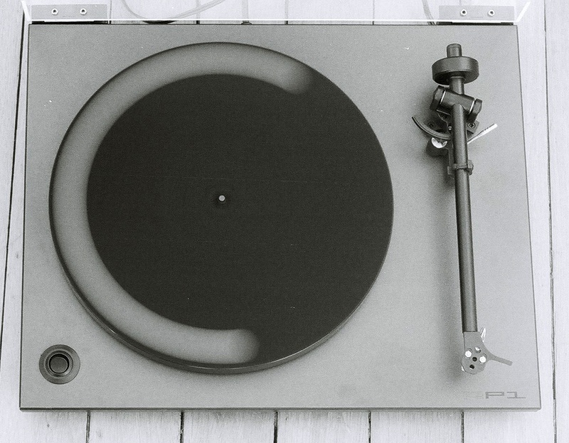

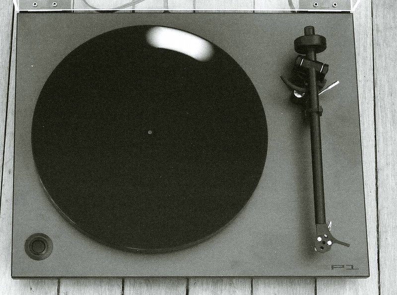

There is a very simple procedure to measure the long times, say 1/10th and longer:
The well behaved turntables turns at 33 1/3 RPM which is exactly 200°/sec. The picture shows my first test with a newly bought M2. Using a smaller and brighter marker will make the measures a bit more accurate.
Here's a shorter time:
