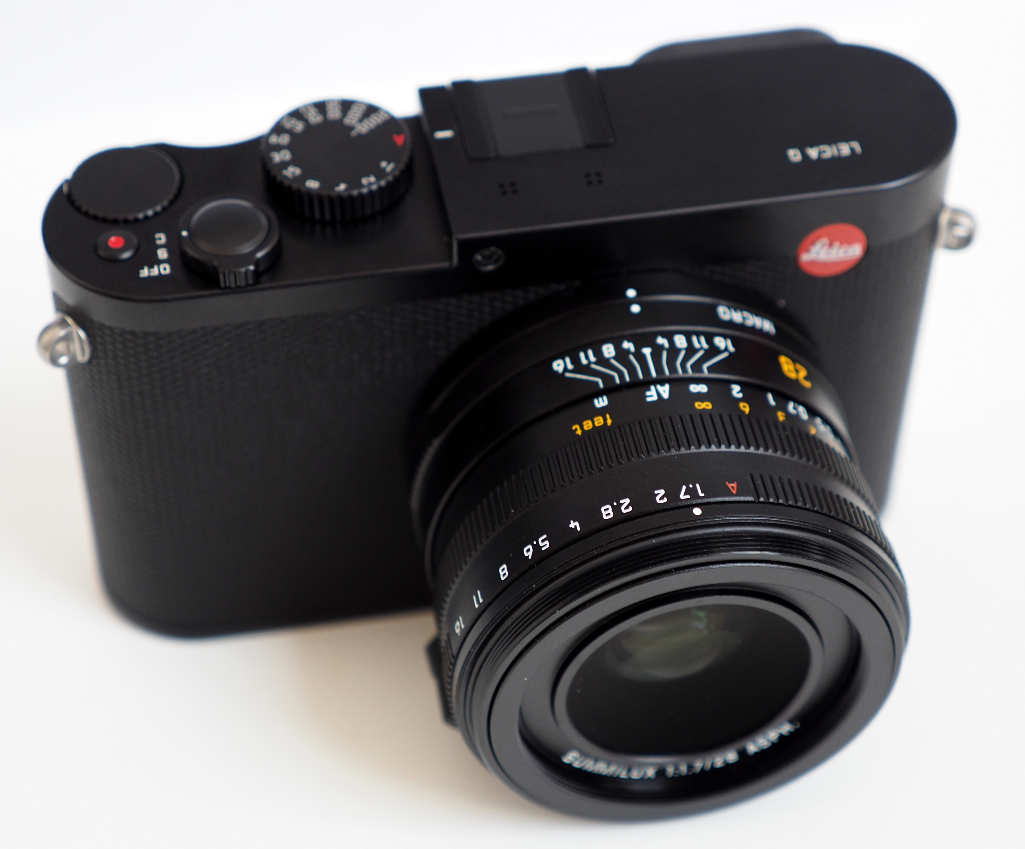

Feudal1 Posted June 15, 2015 Share #1 Posted June 15, 2015 Advertisement (gone after registration) Picked up my Q today. So far,very pleased. But I have an issue with the lens hood - it does not appear to lock into place after screwing it into the thread at the end of the lens. It's not a tight fit, and there doesn't appear to be a locking mechanism to keep it from rotating in use. I'm hoping I'm missing something here. Thoughts? Link to post Share on other sites More sharing options...

bernie.lcf Posted June 15, 2015 Share #2 Posted June 15, 2015 Mine is so tight, I had to use some minor force to screw it in all the way to the end. Are you sure it is all the way in? There will be a hard stop at the end of the thread. Link to post Share on other sites More sharing options...
Carbon111 Posted June 15, 2015 Share #3 Posted June 15, 2015 Yep, hard stop at the end. Mine is nice and firm. Link to post Share on other sites More sharing options...
Daedalus2000 Posted June 15, 2015 Share #4 Posted June 15, 2015 Same here it is very firm and I had to use quite a lot of power to put it in position. Keep pushing but be careful not to damage your lens! :-) Link to post Share on other sites More sharing options...
digitalfx Posted June 15, 2015 Share #5 Posted June 15, 2015 you didn't go far enough...just keep threading until it reaches a hard stop. The first few times its very tight. Link to post Share on other sites More sharing options...
Feudal1 Posted June 15, 2015 Author Share #6 Posted June 15, 2015 Must be an issue with mine - it's loose, right up to a very firm stop. No tightening at all. I'll talk to the dealer, I guess. Thanks for the feedback guys. Link to post Share on other sites More sharing options...
digitalfx Posted June 15, 2015 Share #7 Posted June 15, 2015 Advertisement (gone after registration) and just to be sure, you did remove the retaining ring first right? and FYI- that last bit seems like you went too far...mine is super tight Link to post Share on other sites More sharing options...
Feudal1 Posted June 16, 2015 Author Share #8 Posted June 16, 2015 and just to be sure, you did remove the retaining ring first right? and FYI- that last bit seems like you went too far...mine is super tight Yes, I removed the retaining ring first (the ring that reveals the thread onto which the hood is screwed). There was no tightness at all anywhere in the process of screwing the hood on. Its was super-loose all the way through, right up to the hard stop. I didn't apply any pressure because I didn't have to, thanks to it being loose. And BTW, the retaining ring screws in very tight. So I suspect the issue is with the hood itself, maybe having a thread that is one or two twists too deep/long. Link to post Share on other sites More sharing options...
jdlaing Posted June 16, 2015 Share #9 Posted June 16, 2015 If it's the same as the Dlux 109 when you think it is up against a hard stop it is just a hair away from locking into place. Link to post Share on other sites More sharing options...
spylaw4 Posted June 16, 2015 Share #10 Posted June 16, 2015 Really, really tight - at least mine was. But it does make it awkward to change a filter (UV to Polariser e.g.). Seems like one'll have to remove hood first . Link to post Share on other sites More sharing options...
viramati Posted June 16, 2015 Share #11 Posted June 16, 2015 I presume this should be like the hood on the WATE which just comes up against a stop at the right moment but doesn't actually 'lock' into place. Sounds like something maybe wrong if it is really loose. Anyway I am wondering if this lens really needs the hood? I hardly ever used mine on the summicron 28 asph as it was so resistant to flare and 99% of the time I saw no actual improvement in IQ due to it's use Link to post Share on other sites More sharing options...
Guest Posted June 16, 2015 Share #12 Posted June 16, 2015 Probably not, but it looks cool (Also offers a bit of protection of course.) Link to post Share on other sites More sharing options...
Feudal1 Posted June 16, 2015 Author Share #13 Posted June 16, 2015 Probably not, but it looks cool (Also offers a bit of protection of course.) The protection is the most import aspect of the hood for me. I'm going to work with the dealer and am contacting Leica to see what they can do. The camera itself is really great, but I'm very disappointed in the hood issue. Link to post Share on other sites More sharing options...
Guest Posted June 16, 2015 Share #14 Posted June 16, 2015 Yes agreed, that's mainly why I use it too (I don't bother with a lens cap then). Sorry to hear about your issue, mine is fine in this respect too (although there's no separate "lock position" as I think some have implied - it just screws up very tight). Link to post Share on other sites More sharing options...
Feudal1 Posted June 16, 2015 Author Share #15 Posted June 16, 2015 Got off the phone with Leica - understandably, they don't have any parts for the Q, and little knowledge of issues yet, being it's a new camera. The guy I talked to mentioned that perhaps there was a missing rubber/silicone ring from in the hood or on the lens. You guys see anything like that? I would be surprised if that was the case - the protective ring that you unscrew to reveal the hood thread screws in pretty tight itself. It really feels like a manufacturing issue with my particular hood and the threads that were routed into the hood interior. How many full rotations does it take for your hood to reach the point where it's tight? I rotate my hood 3 full rotations before it hits the hard stop and can go no further. Thanks very much! I'm trying to get all the information I have to try to get this figured out. Link to post Share on other sites More sharing options...
Guest Posted June 16, 2015 Share #16 Posted June 16, 2015 It's three rotations here too. There actually is a silicon ring on the lens, at the base of the thread. It's very thin and I wouldn't have noticed it if you hadn't mentioned it. Link to post Share on other sites More sharing options...
earleygallery Posted June 16, 2015 Share #17 Posted June 16, 2015 Return the lot to the dealer and ask for a replacement camera. I'm sure Leica could manage to post out a new hood if they really wanted to help! Link to post Share on other sites More sharing options...
bernie.lcf Posted June 16, 2015 Share #18 Posted June 16, 2015 Check the ring - the one that you take off the camera in order to reveal the thread for the hood. Chances are, the rubber or silicon ring is stuck to this part and was removed with it. Other than that - of course, you can just go back to the dealer and have him take care of this (as suggested above) Link to post Share on other sites More sharing options...
Guest Posted June 16, 2015 Share #19 Posted June 16, 2015 You can see the ring on this image: http://www.ephotozine.com/articles/leica-q-hands-on-review-sample-photos-27644/images/highres-Leica-Q-4_1433939399.jpg (I agree they should be replacing the whole lot for you with no questions asked.) Link to post Share on other sites More sharing options...
Feudal1 Posted June 16, 2015 Author Share #20 Posted June 16, 2015 The issue with replacing the whole camera is that none are available. I've been chatting with Leica, and my camera is indeed missing that thin rubber/silicone ring. Parts aren't available as of yet, so I'm checking on what my options are. Link to post Share on other sites More sharing options...
