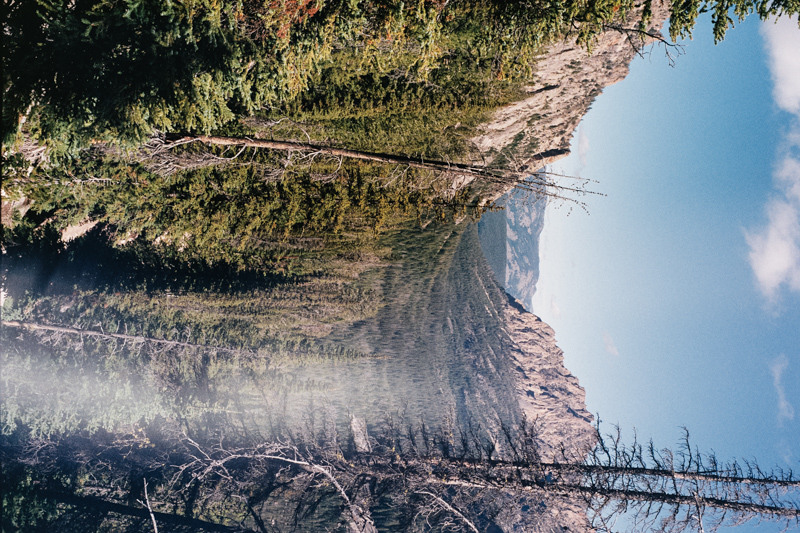

  1. I just got this very clean M3 and I’m experiencing these unusual light leaks. I have shinned a light inside and tried to find the source, but I can’t figure it out. I thought it could be the curtains, but they look brand new. Any ideas?

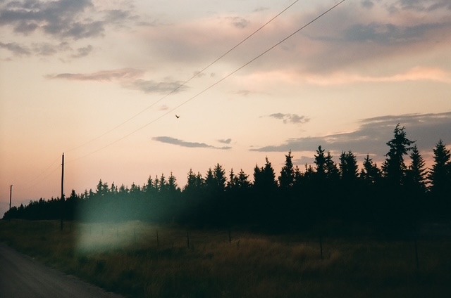

  3. Hi! I've been noticing uneven exposures, usually on the right side of the photo. Have you guys experienced the same thing? What could be the cause?

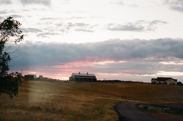

  5. I've had a camera with this sort of light leak in the past, and never got to the bottom of it. I've started to notice in the occasional frame from my last few rolls a little light left of photo suggesting it's coming in from the right hand side. The door seal looks good I can't see any grit. Could the light be finding its way in via the viewfinder or rewind release lever? Pete
