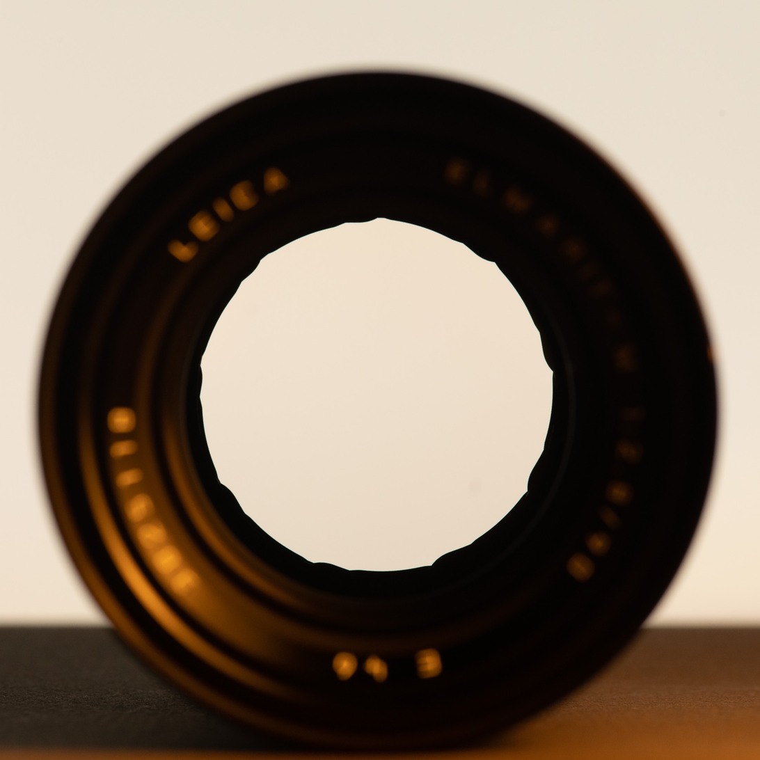

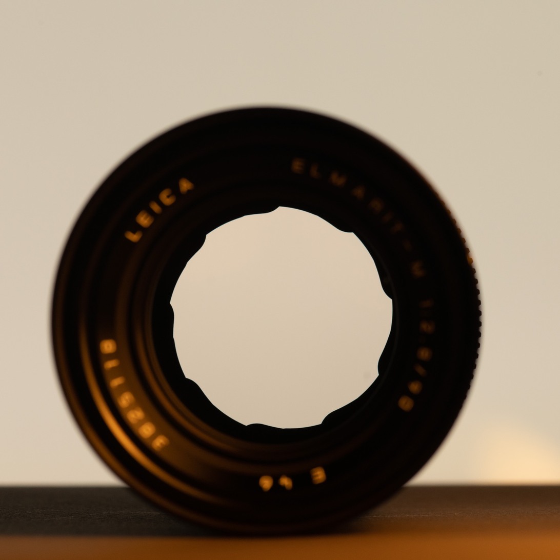

  1. Hi all, a while ago I've bought a used Elmarit-M 90mm (latest version) for which I found a few days ago by accident that the aperture blades do not fully disappear when the lens is used wide open. Consequently, the bokeh balls aren't circular, but have a more "saw blade"-like shape. If I turn the aperture ring beyond 2.8, which is possible by a tiny bit, the blades retract a bit more, but never completely (cp. attached images). As I wasn't sure whether this is by design or a defect, I have contacted Leica Support and they tell me that this is the normal behaviour, but offer a CLA for the lens nonetheless. Could any other owner please check with his or her lens? Thanks in advance, Rolf
