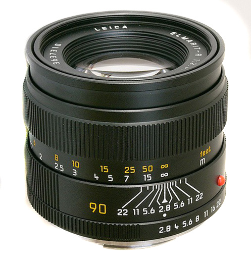

Annibale G. Posted March 23, 2009 Author Share #3 Posted March 23, 2009 about leica and leitz could you tell me something more about quality? Mainly because I'm looking for the Leica R elmarit 90mm f/2,8 and I've found only the Leitz version. What do you think? what are the differences in quality? Thanks awfully Link to post Share on other sites More sharing options...

earleygallery Posted March 23, 2009 Share #6 Posted March 23, 2009 As already explained, Leitz and Leica are one and the same. They just changed their branding from Leitz to Leica at some point, the name doesn't affect the quality of the lens. Link to post Share on other sites More sharing options...
Annibale G. Posted March 23, 2009 Author Share #7 Posted March 23, 2009 Advertisement (gone after registration) fine. thanks so the Leitz R 90 mm f/2,8 Elmarit is as good as the Leica R Elmarit 90mm f/2,8 . Right? Link to post Share on other sites More sharing options...
adan Posted March 23, 2009 Share #8 Posted March 23, 2009 It's a bit more complex than that: Leitz built a 90 f/2.8 R lens from 1964 to 1983 then Leitz redesigned it optically (major change) and built the new lens 1984-1986 then the name changed to Leica and Leica continued building the new lens Leitz redesigned. Both versions are good - the newer version is contrastier, and physically smaller. Erwin Puts describes them as (older design) "an excellent performer..medium-to-high contrast...very even edge-to-edge definition of very fine detail" (Newer design) "best 2.8/90 ever in Leica history...overall contrast is high...at f/2.8 equal to the previous version at f/4" A LEICA 90 f/2.8 will definitely be the newer design. A LEITZ 90 f/2.8 could be either design, with the odds greater that it is the older. The NEW lens looks like this - 4 pieces of glass in the design - lens shade slides UNDER focusing ring for compactness: http://www.photodo.com/imgs/lenses/full/1151505381.jpg The OLD lens looks like this - longer, 5 pieces of glass used, lens shade slides back TO the focusing ring, not under it: Leica R7 with 90mm 2.8 Elmarit-R lens on Flickr - Photo Sharing! Link to post Share on other sites More sharing options...

Overgaard Posted March 23, 2009 Share #10 Posted March 23, 2009 fine. thanksso the Leitz R 90 mm f/2,8 Elmarit is as good as the Leica R Elmarit 90mm f/2,8 . Right? To answer this, if the design was unchanged; YES. If the design was changed, there would be some difference, and look at Erwin Putts article for that. You can also look up serial numbers on the net so as to determine which design a lens is of. You can refer to my list of Leica/Leitz lenses for reference: leica.overgaard.dk - Thorsten Overgaard's Leica Pages - Leitz and Leica Lens Compendium Link to post Share on other sites More sharing options...
