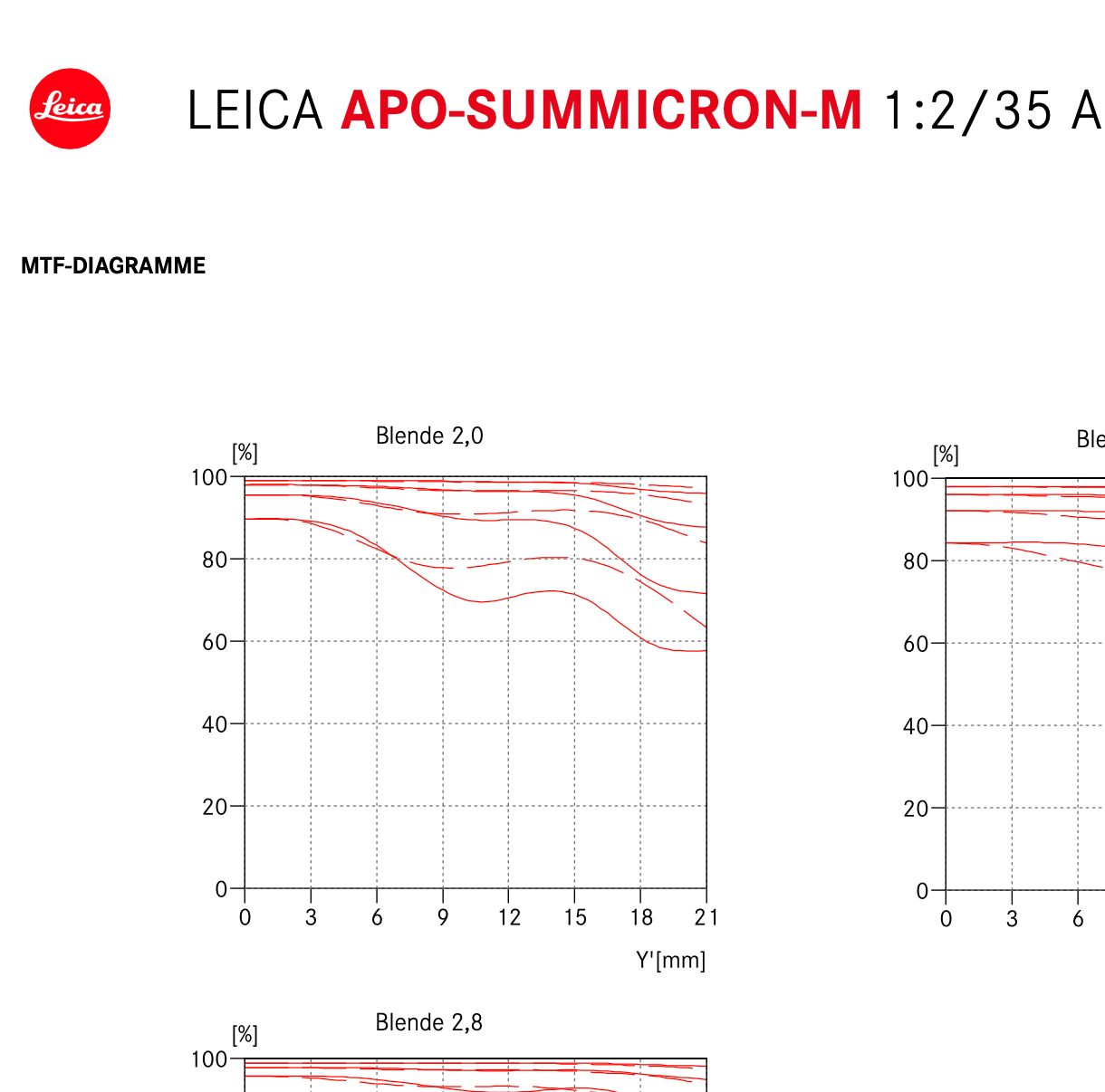

lct Posted December 25, 2024 Share #8 Posted December 25, 2024 Better have deep pockets to reduce vignetting but even then it is not insignificant. Summicron 35/2 apo : Welcome, dear visitor! As registered member you'd see an image here… Simply register for free here – We are always happy to welcome new members! Link to post Share on other sites Simply register for free here – We are always happy to welcome new members! ' data-webShareUrl='https://www.l-camera-forum.com/topic/418086-leica-mp240-35mm-summicron-withwithout-lens-hood-vignetting/?do=findComment&comment=5728656'>More sharing options...
jankap Posted December 25, 2024 Share #9 Posted December 25, 2024 (edited) In this example you see, that at f/stop 2.8 in the far corners only 40% of the light reaches the sensor. That means a vignetting of more than one f/stop. Four corners, so at these 4 extreme places of the sensor the lens is only an f/4 lens. Interesting here is the f/5.6 curve. A viewfinder camera gives the lens designer a constraint. The lens must be small, otherwise the user sees the lens in the viewfinder instead of the subject. The no-go is of course shadowing the rangefinder field in the viewfinder. In a small lens, the glass elements can only be small. And small glass elements transmit less light. Edited December 25, 2024 by jankap Link to post Share on other sites More sharing options...
