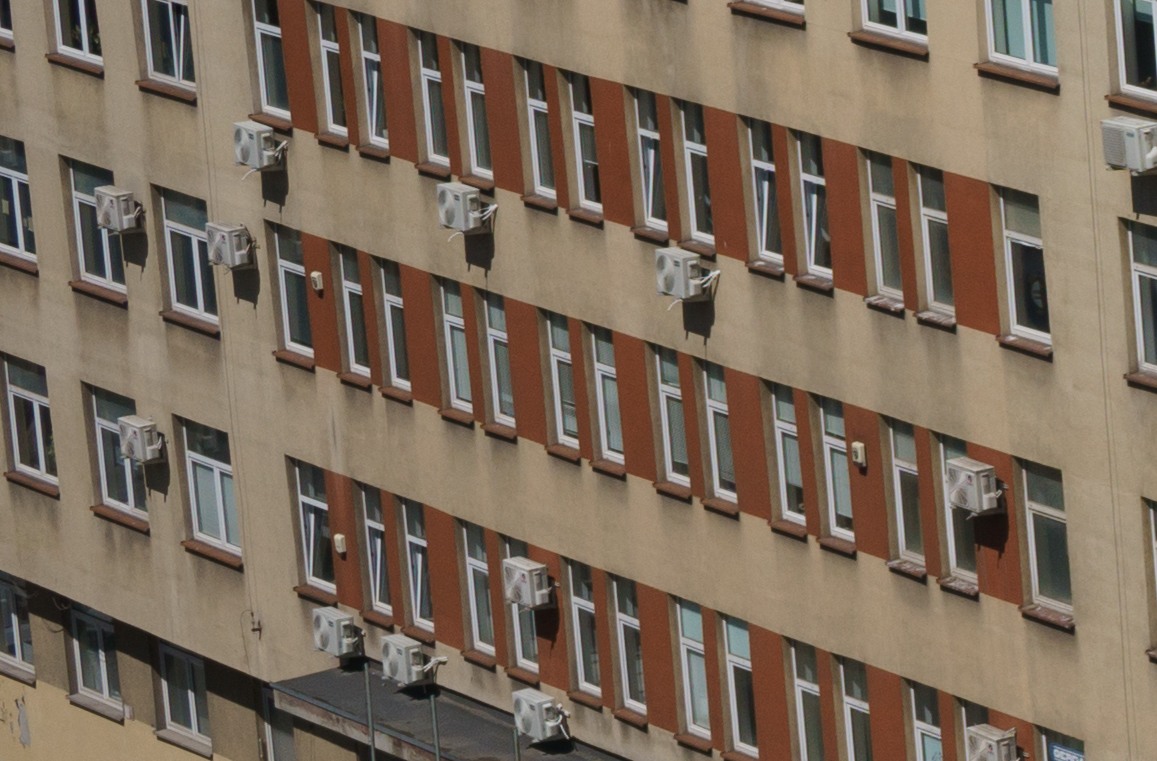

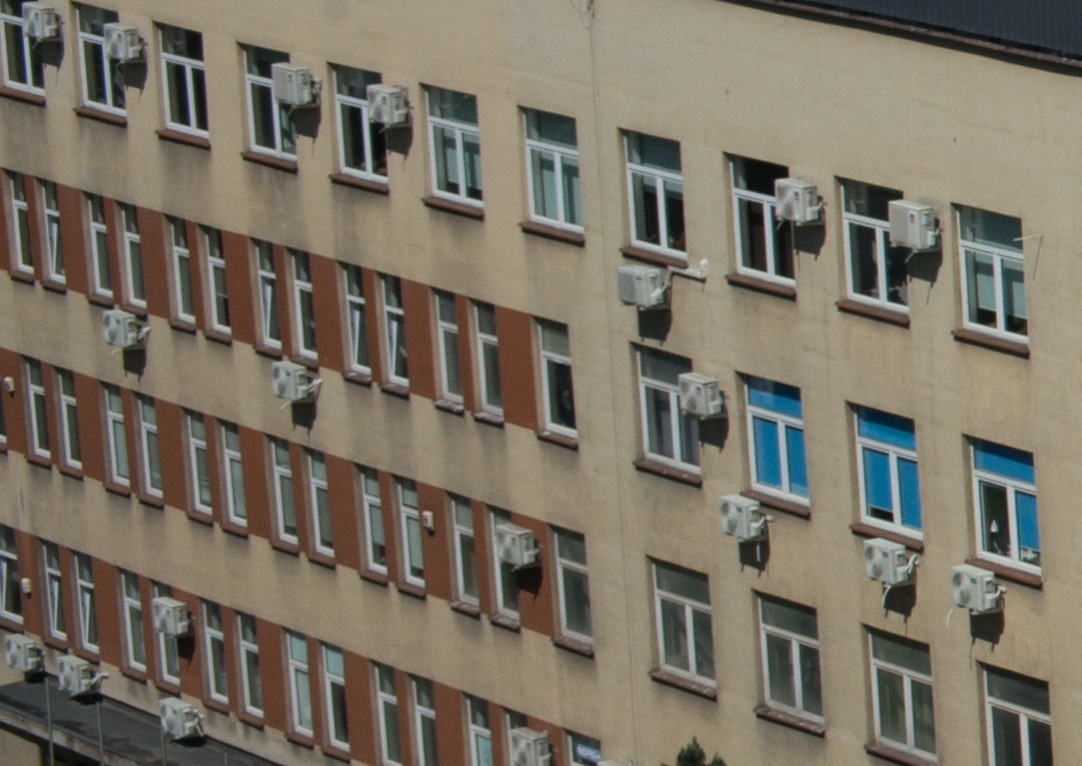

jarekzon Posted June 2, 2024 Share #1  Posted June 2, 2024 (edited) Advertisement (gone after registration) Good morning. I bought my first Lecia and was immediately disappointed. The Leica magic was gone. An excellent lens, the Voigtlander Nokton 35/1.2 Aspherical II, attached to the Leica M240 gives very poor results. For example, at f8 only the center of the frame is sharp, the edges and corners are soft and blurry. Additionally, there is a clear vignette. The same lens, attached to the Sony A7RII camera, gives excellent results. At f8 the frame is sharp, from corner to corner. The vignette is small. Can someone explain this to me? After all, the lenses were supposed to work better on Leica. What this is about ? My second Voigtlander Nokton 50 mm f/1.5 Asp lens already gives good results. In the attachment, I add small crops from the edge of the frame for comparison. The top one is Sony, of course, the bottom one is Leica. Welcome, dear visitor! As registered member you'd see an image here… Simply register for free here – We are always happy to welcome new members! Edited June 2, 2024 by jarekzon Link to post Share on other sites Simply register for free here – We are always happy to welcome new members! ' data-webShareUrl='https://www.l-camera-forum.com/topic/395370-voigtlander-nokton-3512-aspherical-ii-leica-m-leica-m240-the-problem-of-poor-results/?do=findComment&comment=5320320'>More sharing options...

jaapv Posted June 2, 2024 Share #7  Posted June 2, 2024 Advertisement (gone after registration) If you think Andy does not know what he is talking about, you are way out of line. We don’t tolerate this type of aggression in this forum. Anyway the explanation is extremely simple. You were lucky that you focused your Sony shot halfway out. This lens has a vintage-level field curvature and that is what you are seeing on the Leica shot which you focused in the center. Your observation is completely normal for this lens. Read up on its characteristics in reliable reviews: https://www.fredmiranda.com/forum/topic/1784972/ When used properly it will be better on the Leica than on the Sony. And yes, it is also completely normal for a wideangle lens to have weaker corners than its longer counterpart. 5 3 Link to post Share on other sites More sharing options...

jaapv Posted June 2, 2024 Share #17 Â Posted June 2, 2024 If we study the comparison images carefully, we notice that the Sony image is marginally more in focus than the right hand side, the Leica image is just the other way around, suggesting slightly different planes of focus. Link to post Share on other sites More sharing options...
