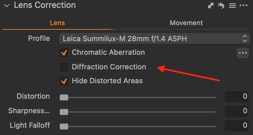

LBJ2 Posted April 25, 2024 Share #21 Posted April 25, 2024 (edited) Advertisement (gone after registration) 58 minutes ago, Photoworks said: Welcome, dear visitor! As registered member you'd see an image here… Simply register for free here – We are always happy to welcome new members! Many programs already have it as an option to correct. Plus AI is getting stupid good to refocus. I would say don't shoot at f22 if you don't need to. I have noticed stronger in macro photography. Interesting. What is this app? Edit, oh I see it's C1, never noticed this setting before. Edited April 25, 2024 by LBJ2 Link to post Share on other sites More sharing options...
