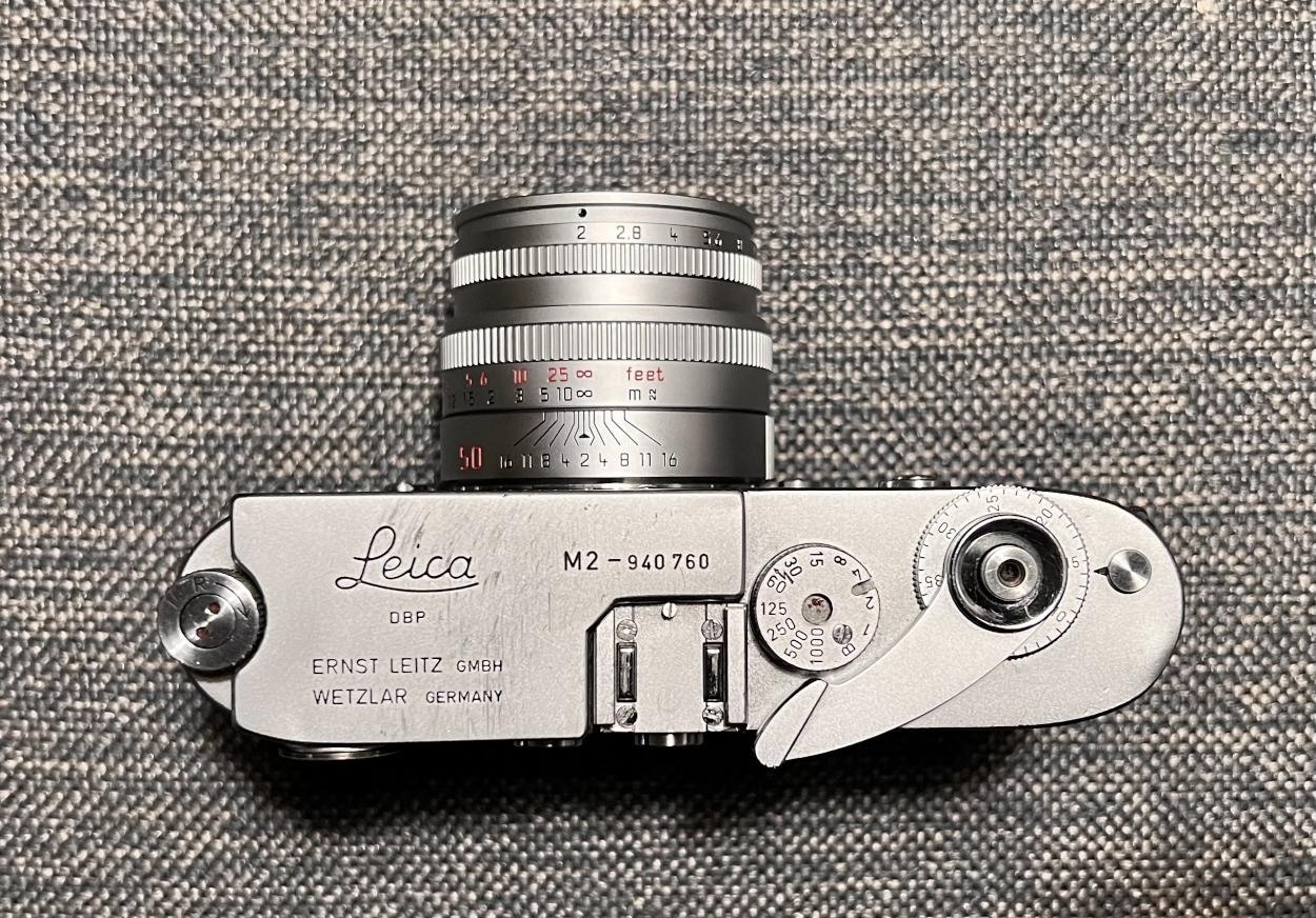

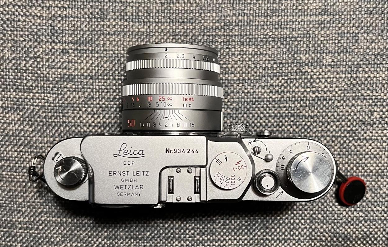

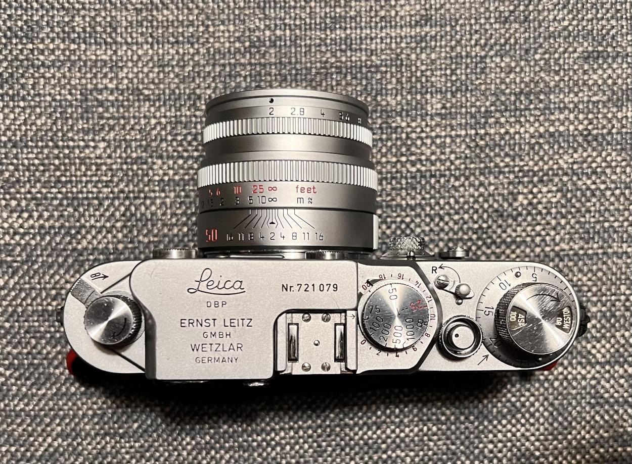

Here is a 50mm Summicron (#11619), rather than Summilux (#11621), but from the same set of "modern" LTM lenses from 1999, on an M2, a IIIf, and a IIIg. It is offset slightly left on each of them, by slightly varying amounts.   It focuses quite accurately on all three cameras, which I regard as somewhat miraculous.
Edited by qqphot
16 minutes ago, qqphot said:
Here is a 50mm Summicron, rather than Summilux, but from the same set of "modern" LTM lenses from 1999, on an M2, a IIIf, and a IIIg. It is offset slightly left on each of them, by slightly varying amounts.   It focuses quite accurately on all three cameras, which I regard as somewhat miraculous.
Wow, thanks for the comparison pictures. Out of curiosity, aryou using the Leica adapter??
Yes, it's as far as I know the "official" one.
I haven't tried it extensively with other ones because I don't want to discover discrepancies I'd then feel compelled to address. :)
Edited by qqphot
