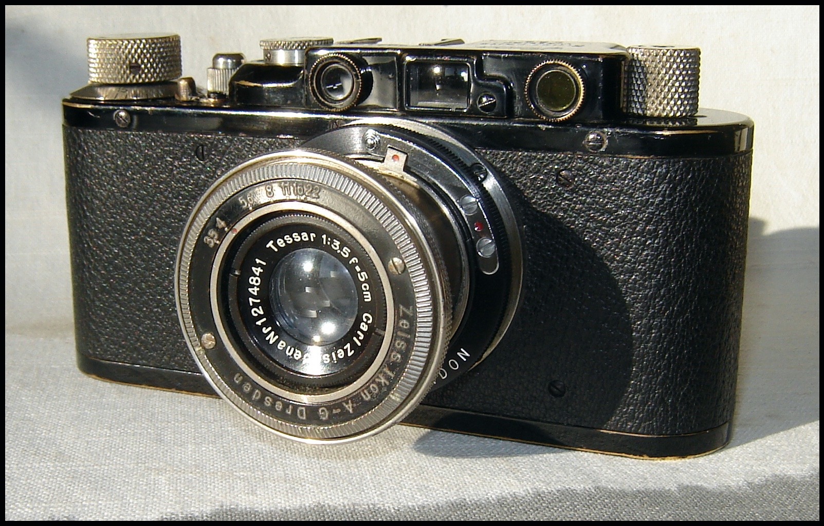

UliWer Posted February 18, 2024 Share #5 Â Posted February 18, 2024 Your question inspired me to an unconventional test with my collapsible Sonnar and the pre-war close focussing device: Â Â 1 Link to post Share on other sites More sharing options...
Pyrogallol Posted February 18, 2024 Share #6  Posted February 18, 2024 (edited) I have an old Cooke and Perkins adaptor for Contax internal bayonet lenses to Leica screw. It is fixed a infinity and doesnot allow focussing. Welcome, dear visitor! As registered member you'd see an image here… Simply register for free here – We are always happy to welcome new members! Edited February 18, 2024 by Pyrogallol 2 Link to post Share on other sites Simply register for free here – We are always happy to welcome new members! ' data-webShareUrl='https://www.l-camera-forum.com/topic/389352-adapter-carl-zeiss-sonnar-52-collapsible-to-leica-m/?do=findComment&comment=5045089'>More sharing options...
