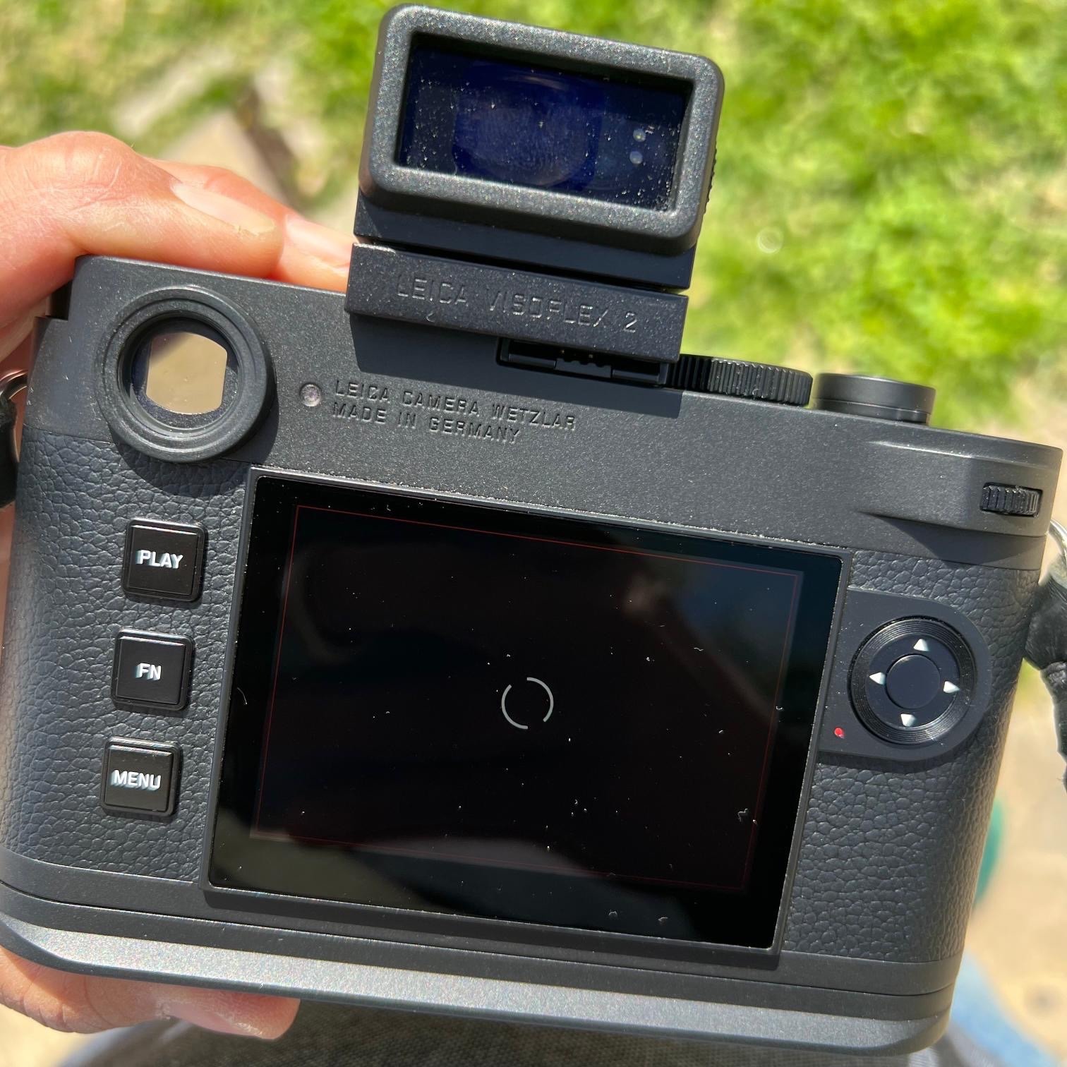

Lockups happen rarely, but they still happen- The last five to six times under the following conditions.
  • Using Visoflex 2 - Close focus on 35APO, 50mm Summicron-DR, with/without SD card. It happens with batteries under 20% charge and twice on fully charged batteries.
  • Live View - After the M11 has gone to sleep for a long time with a 35APO lens attached, and there is no SD card. I don't remember what the battery charge was at this point.
  • I don't remember it happening without Live View engaged, but I may be in error.
The solution is to remove the battery and put the battery back in.

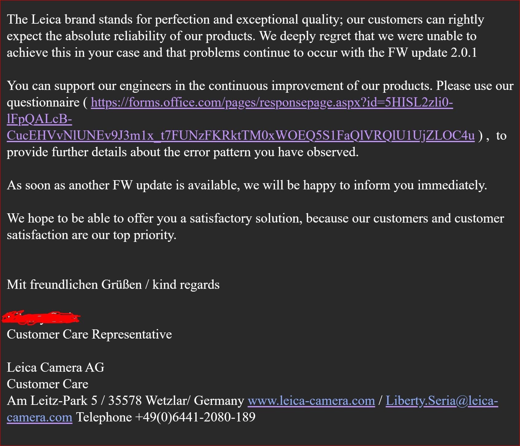

Please, please Leica, fix this freeze problem after exactly 3 months waiting time, or give us the possibility to downgrade to firmware 1.6X. I am afraid Leica could simply sit and wait until the M12 is on the shelves and stops thinking about fixing the M11 freezes...:-(

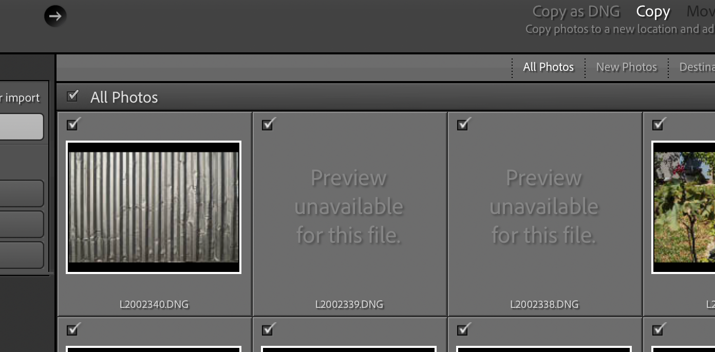

My first occurrence with corrupted DNG files came earlier this month while testing two new close focusing Summilux lenses; the 50mm ASPH and 35mm ASPH.
So another forum post promoted me to establish whether it's perhaps 6 bit code related to the Summilux 50mm ASPH lens. Another forum member wrote about the coincidence somewhere, so I thought it was worth a shot.
So today I coded my Zeiss Planar 50mm as a Summilux 50mm ASPH...
Lo and behold, corrupted DNG files on the first outing!
Leica FOTOS connectivity is OFF.
Shutter speed and ISO was set manually.
Camera was on for well over 10 seconds before taking the shot!
Live View was ON
My M11 shows these files as "File unreadable"
EDIT: Reported the above to Leica. Also suggested it wouldn't be unreasonable for Leica to actually communicate something in the light of these issues, and especially clarify what they meant with, "This error will be remedied shortly.” in their last firmware release notes. Perhaps even offer a custom firmware to go back to 1.6.1. (Pipe dream)

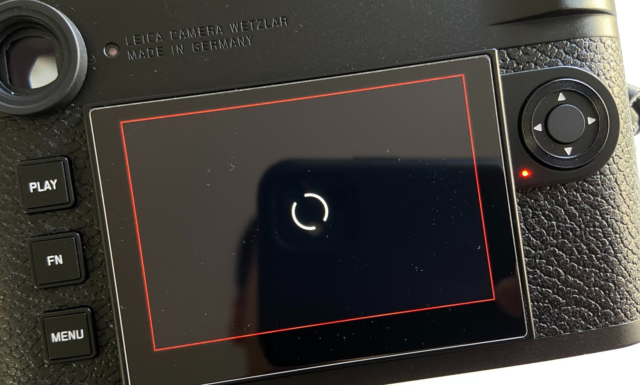

M11 Firmware 2.0.2 , Lexar 256g sdxc 250MB/s (purchased from Leica store)
35mm Apo shooting session yesterday, camera froze twice with red frame shown in other posts here.
 Needed to reinsert the battery and sd card to get going again
