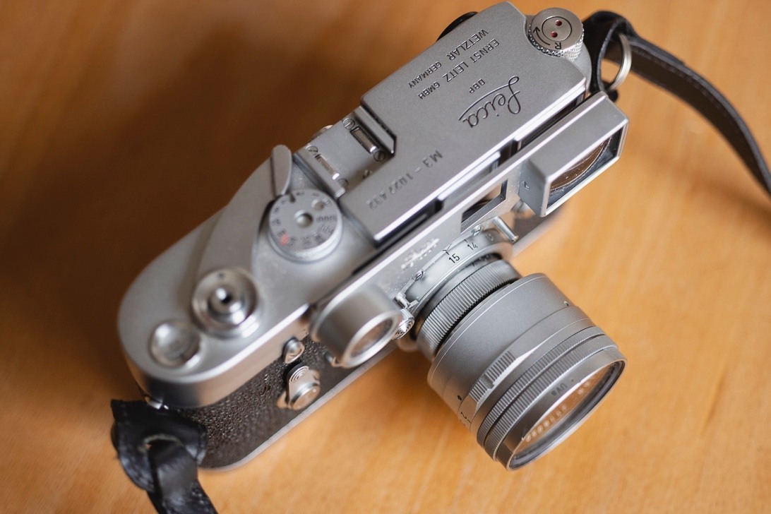

streetpussy Posted January 13, 2024 Share #1 Â Posted January 13, 2024 Advertisement (gone after registration) I recently got a Rigid on eBay (recently CLA'd) and to my surprise I noticed that it unscrews in half. With a racing heart, I immediately screwed it back into place when I accidentally started to unscrew it. Then I read online that it was designed to unscrew in half but I cannot figure out why. Is it in order to clean it? Would it be safe to take it completely apart to blow some dust out or is it a pain to put back together when completely taken apart? Link to post Share on other sites More sharing options...

hepcat Posted January 14, 2024 Share #2  Posted January 14, 2024 All of the lens elements in the Rigid and DR Summicrons are in a "sealed" unit. The lens head on lenses from that period were removable so as to be able to be used on bellows and with a Visoflex. All that separates from the lens elements is the focusing helix and "M" mount.  Pulling the lens head out makes it easier to (VERY carefully) clean the rear element, but doesn't give you access to any of the internal elements.  All of the lenses (IIRC) from that era separated similarly. The 90mm and 135mm lenses actually had a shorter Visoflex-specific focusing helix that the lens element head could be screwed into for Visoflex use. 1 Link to post Share on other sites More sharing options...
streetpussy Posted January 14, 2024 Author Share #3  Posted January 14, 2024 Ohh, interesting. Is that so people could use it as an enlarger lens too? I got mine for $650 shipped with the 12585 hood and a Leica UVa filter. It was serviced by YYE and 2022 and everything is smooth. The cosmetics aren't perfect but the lens has no haze, fungus or scratches.. Only downside is some cleaning marks in the coating but my test rolls reveal no problems. One question though.. I know there is a non-DR version and a DR version, but I didn't realize there's a Type 1 and Type 2 as well. Looks like I got a Type 1 from 1958. Is the only difference between the Type 2 and the Type 1 the barrel design? Also, I've only ever used B+W Clear filters for protection and never a UV filter in my life actually. Stupid question I'm sure but is the UV filter going to alter my pictures or should I pop my B+W filter on? Welcome, dear visitor! As registered member you'd see an image here… Simply register for free here – We are always happy to welcome new members! Link to post Share on other sites Simply register for free here – We are always happy to welcome new members! ' data-webShareUrl='https://www.l-camera-forum.com/topic/387248-unscrewing-rigid-50-in-half/?do=findComment&comment=4987154'>More sharing options...
UliWer Posted January 14, 2024 Share #4  Posted January 14, 2024 vor 8 Stunden schrieb hepcat: The lens head on lenses from that period were removable so as to be able to be used on bellows and with a Visoflex. Other than 90 or 135mm lenses the 50mm Summicron is too short, so it doesn't make much sense to unscrew the lens head to use it with Visoflex or bellows. Though there was a special device which you could use for getting closer than normal with the unscrewed lens head: the SOOKY-M or SOMKY shown here with the adapter UOORF (16508). Perhaps it wasn't as elegant as the "dual range" Summicron, but it did the same job:  Welcome, dear visitor! As registered member you'd see an image here… Simply register for free here – We are always happy to welcome new members! vor 6 Stunden schrieb streetpussy: is the UV filter going to alter my pictures or should I pop my B+W filter on? In most cases you won't see any difference. Perhaps for pictures taking on high altitude and/or with snow the UV filter might be helpful. 1 Link to post Share on other sites Simply register for free here – We are always happy to welcome new members! In most cases you won't see any difference. Perhaps for pictures taking on high altitude and/or with snow the UV filter might be helpful. ' data-webShareUrl='https://www.l-camera-forum.com/topic/387248-unscrewing-rigid-50-in-half/?do=findComment&comment=4987434'>More sharing options...
hepcat Posted January 14, 2024 Share #5  Posted January 14, 2024 To my knowledge, the lens head can't be used as an enlarger lens. At least I've never heard of it being done. Your lens looks very nice.  Feel free to use the UV filter. It won't alter your images, it'll just cut through blue haze. I have used them for fifty years without issue. As far as the variations between versions, I'm pretty sure that up until v4, the same optical design was used. The coatings may have changed, of course, but I believe that the only changes were in the lens barrel cosmetics. Others with a more extensive background may give you a better answer. Link to post Share on other sites More sharing options...
hepcat Posted January 14, 2024 Share #6  Posted January 14, 2024 4 minutes ago, UliWer said: Other than 90 or 135mm lenses the 50mm Summicron is too short, so it doesn't make much sense to unscrew the lens head to use it with Visoflex or bellows. Though there was a special device which you could use for getting closer than normal with the unscrewed lens head: the SOOKY-M or SOMKY shown here with the adapter UOORF (16508). Perhaps it wasn't as elegant as the "dual range" Summicron, but it did the same job:  Welcome, dear visitor! As registered member you'd see an image here… Simply register for free here – We are always happy to welcome new members! In most cases you won't see any difference. Perhaps for pictures taking on high altitude and/or with snow the UV filter might be helpful. To be honest, having the removable lens group in the 50mm never made much sense to me either for that reason, but it IS consistent with the 90 and 135 of the day. THAT is an interesting accessory that, in 50 years of using Leica, I've never seen before. Thanks for sharing it. Link to post Share on other sites More sharing options...
UliWer Posted January 14, 2024 Share #7  Posted January 14, 2024 Advertisement (gone after registration) Here a very quick example with the SOOKY-M with UOORF and lens head of 50mm Summicron (from Laney p. 411): Welcome, dear visitor! As registered member you'd see an image here… Simply register for free here – We are always happy to welcome new members! There have been many similar devices with "goggles" since the times of screwmount cameras. The SOMKY or SOOKY-M with UOORF for the Summicron lens head was the last incarnation of these devices for 50mm lenses. Link to post Share on other sites Simply register for free here – We are always happy to welcome new members! There have been many similar devices with "goggles" since the times of screwmount cameras. The SOMKY or SOOKY-M with UOORF for the Summicron lens head was the last incarnation of these devices for 50mm lenses. ' data-webShareUrl='https://www.l-camera-forum.com/topic/387248-unscrewing-rigid-50-in-half/?do=findComment&comment=4987450'>More sharing options...
Anbaric Posted January 14, 2024 Share #8 Â Posted January 14, 2024 6 hours ago, streetpussy said: Also, I've only ever used B+W Clear filters for protection and never a UV filter in my life actually. Stupid question I'm sure but is the UV filter going to alter my pictures or should I pop my B+W filter on? It's fine to use UV filters in general (they shouldn't absorb significantly in the visible range) but a vintage filter will probably be uncoated, so you may see flare in situations that a modern multicoated filter (like a B+W MRC or MRC-Nano) would handle better. Typically this would be when there is a light source in or just outside the frame. Link to post Share on other sites More sharing options...
TomB_tx Posted January 14, 2024 Share #9 Â Posted January 14, 2024 (edited) 8 hours ago, streetpussy said: One question though.. I know there is a non-DR version and a DR version, but I didn't realize there's a Type 1 and Type 2 as well. Looks like I got a Type 1 from 1958. Is the only difference between the Type 2 and the Type 1 the barrel design? Although the WIKI of this forum lists Type 1 as including both the collapsible and rigid, others note several changes in the optics between the collapsible Type 1 and the rigid (non-collapsible) which is commonly termed Type 2, with the rigid version marketed from 1957 to 1968. Lens diagrams look about the same for Type 1 and Type 2, but the rigid mount has revised elements, wider "throat", and wider spacing between the first and second elements. The more major Summicron change came in 1969 with the Type 3 with 6 elements instead of 7 and a more modern anodized aluminum black barrel. It supposedly traded a bit of resolution for increased contrast. I bought mine in 1969, and appreciated that the higher contrast made it appear sharper. BTW: The optical head of the Type 3 unscrews like the Type 2 and fits the same accessories. Edited January 14, 2024 by TomB_tx Link to post Share on other sites More sharing options...
