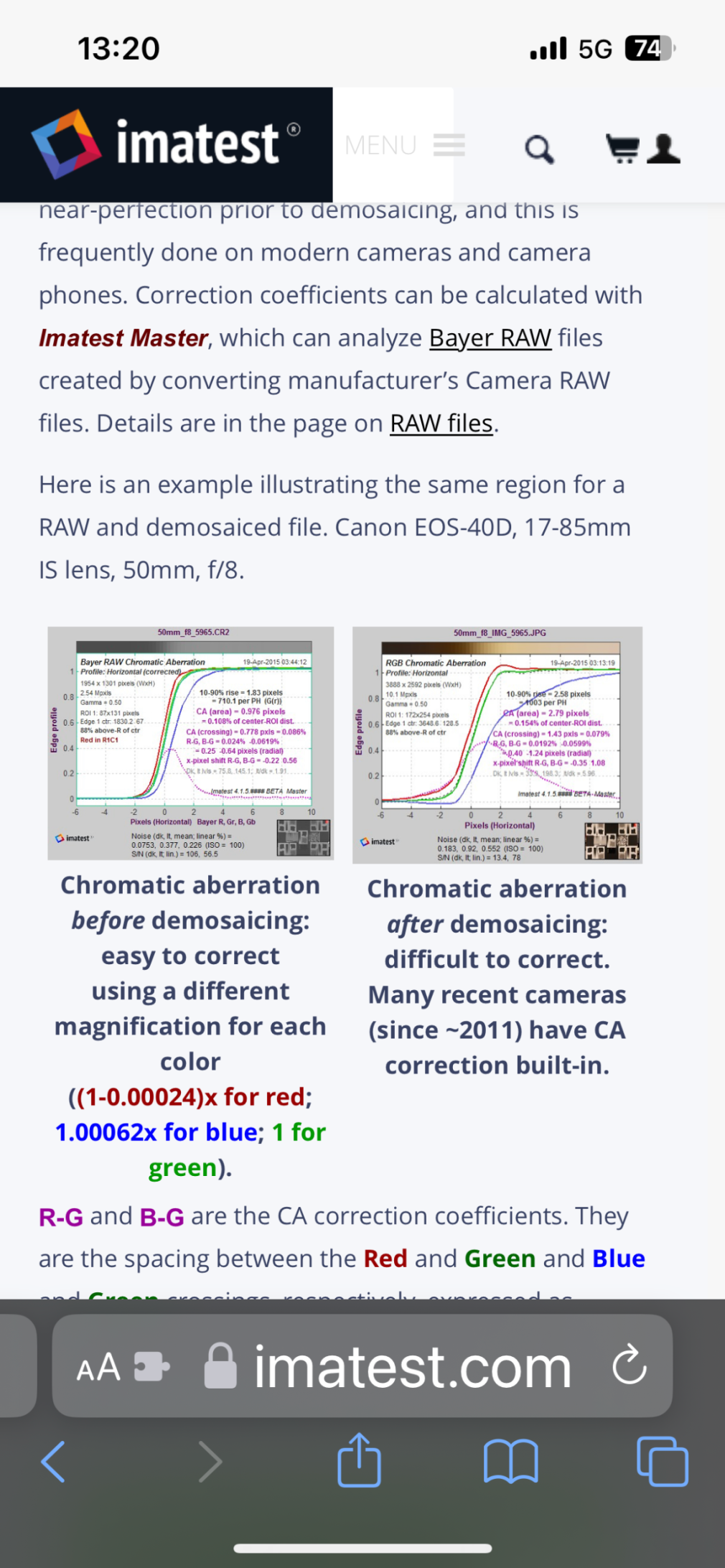

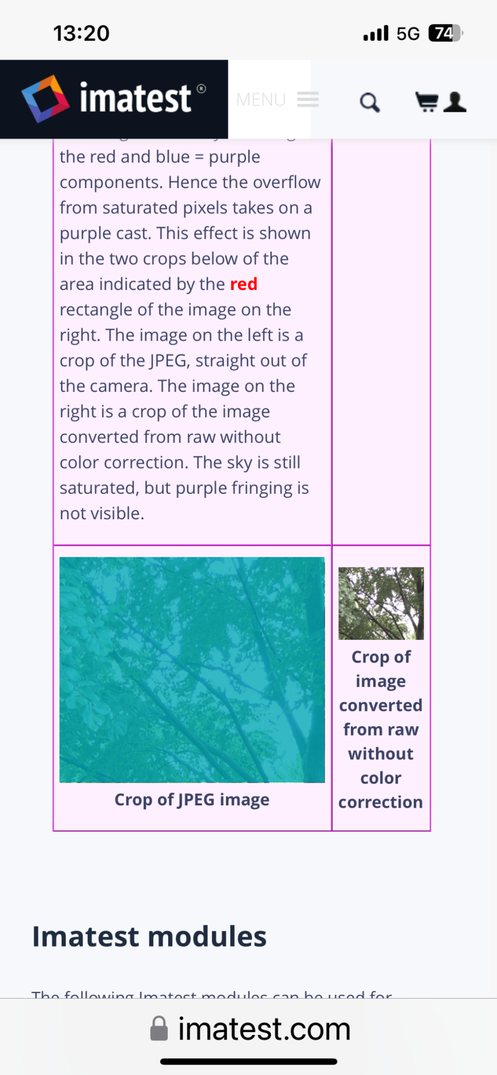

jaapv Posted March 22, 2024 Share #22  Posted March 22, 2024 That is most likely because it is corrected before demosaicing on the SL( see the Imatest article linked to) I wonder which camera body the poster was using. Welcome, dear visitor! As registered member you'd see an image here… Simply register for free here – We are always happy to welcome new members! 1 Link to post Share on other sites Simply register for free here – We are always happy to welcome new members! ' data-webShareUrl='https://www.l-camera-forum.com/topic/385967-why-does-the-leica-apo-summicron-sl-35mm-f2-asph-rate-poorly-at-dxo/?do=findComment&comment=5123963'>More sharing options...
