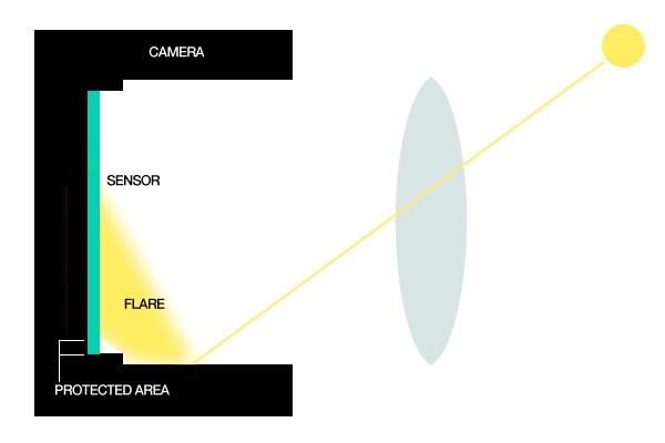

adan Posted September 29, 2023 Share #8 Posted September 29, 2023 You are getting a flare patch from stray sunlight hitting the inside of the camera (overall bright area) outside of the image area. But the set-back of the film (or sensor - either one) behind the shutter shades the edge of the image area for a couple of mm, producing the relatively dark band (which is actually simply normal exposure, minus the flare light). Welcome, dear visitor! As registered member you'd see an image here… Simply register for free here – We are always happy to welcome new members! Link to post Share on other sites Simply register for free here – We are always happy to welcome new members! ' data-webShareUrl='https://www.l-camera-forum.com/topic/382502-illumination-pattern-along-the-long-side-of-a-frame-in-bright-light/?do=findComment&comment=4866901'>More sharing options...
f8low Posted September 29, 2023 Author Share #9 Posted September 29, 2023 (edited) 28 minutes ago, adan said: You are getting a flare patch from stray sunlight hitting the inside of the camera (overall bright area) outside of the image area. But the set-back of the film (or sensor - either one) behind the shutter shades the edge of the image area for a couple of mm, producing the relatively dark band (which is actually simply normal exposure, minus the flare light). Welcome, dear visitor! As registered member you'd see an image here… Simply register for free here – We are always happy to welcome new members! That's super interesting, thanks for the explanation and the nice drawing. The geometry of this makes a lot of sense to me. Clearly there was a hell lot of light inside the camera - the scene was bright and I overexposed a bit. I have one follow up question though. Are such rays of light that hit the bottom of the camera also present in every 'well behaved' scene or are they so to speak 'stray light' that stems from reflections inside the lens? To put it differently, is this light that left the 'intended' path through the camera? If that's the case, the choice of lens (and me not using the hood) would amplify the situation. The Summaron definitely does not have the most modern coating... Edited September 29, 2023 by f8low Link to post Share on other sites More sharing options...

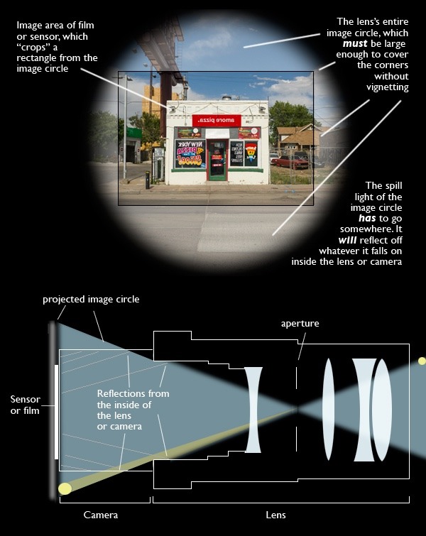

BernardC Posted September 29, 2023 Share #10 Posted September 29, 2023 1 hour ago, f8low said: Are such rays of light that hit the bottom of the camera also present in every 'well behaved' scene or are they so to speak 'stray light' that stems from reflections inside the lens? To put it differently, is this light that left the 'intended' path through the camera? If that's the case, the choice of lens (and me not using the hood) would amplify the situation. The lens projects a circular image, so some of that lands outside of the film area and can be reflected back to the film. A lens hood should help. You may also have a reflective surface inside the camera. Those can sometimes be touched-up with black paint. Link to post Share on other sites More sharing options...

adan Posted October 1, 2023 Share #12 Posted October 1, 2023 (edited) A follow-up diagram in support of BernardC. (The questions you are asking come up fairly often, so I've saved these informational graphics for re-use. ) Welcome, dear visitor! As registered member you'd see an image here… Simply register for free here – We are always happy to welcome new members! Ideally, one would use a lens hood that crops the scene in front of the lens to a rectangle the same shape as the film area. Thus minimizing such reflection-flare. Hollywood and cinematographers use those - but they are quite bulky for carry-around cameras. https://www.bhphotovideo.com/c/product/1346398-REG/cambo_99050324_compendium_and_lenshood_for.html/?ap=y&ap=y&smp=y&smp=y&smpm=ba_f2_lar&lsft=BI%3A6879&gclid=EAIaIQobChMI46fh9YvUgQMVVQx9Ch2fuQB3EAQYAiABEgI3u_D_BwE Leica has provided smaller rectangular hoods for some lenses, over the decades (including today). Not sure whether one exists for the 35 Summaron. https://wiki.l-camera-forum.com/leica-wiki.en/index.php/SOOBK https://wiki.l-camera-forum.com/leica-wiki.en/index.php/XIOOM https://wiki.l-camera-forum.com/leica-wiki.en/index.php/12459 Edited October 1, 2023 by adan Link to post Share on other sites Simply register for free here – We are always happy to welcome new members! Ideally, one would use a lens hood that crops the scene in front of the lens to a rectangle the same shape as the film area. Thus minimizing such reflection-flare. Hollywood and cinematographers use those - but they are quite bulky for carry-around cameras. https://www.bhphotovideo.com/c/product/1346398-REG/cambo_99050324_compendium_and_lenshood_for.html/?ap=y&ap=y&smp=y&smp=y&smpm=ba_f2_lar&lsft=BI%3A6879&gclid=EAIaIQobChMI46fh9YvUgQMVVQx9Ch2fuQB3EAQYAiABEgI3u_D_BwE Leica has provided smaller rectangular hoods for some lenses, over the decades (including today). Not sure whether one exists for the 35 Summaron. https://wiki.l-camera-forum.com/leica-wiki.en/index.php/SOOBK https://wiki.l-camera-forum.com/leica-wiki.en/index.php/XIOOM https://wiki.l-camera-forum.com/leica-wiki.en/index.php/12459 ' data-webShareUrl='https://www.l-camera-forum.com/topic/382502-illumination-pattern-along-the-long-side-of-a-frame-in-bright-light/?do=findComment&comment=4867876'>More sharing options...
