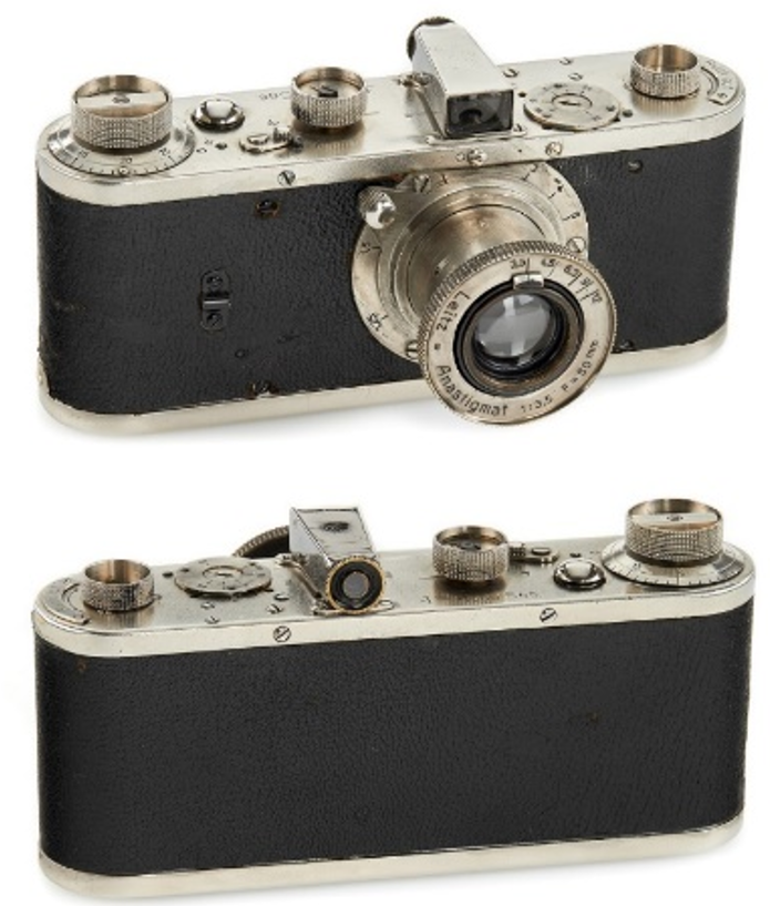

mingaun Posted August 14, 2023 Author Share #21  Posted August 14, 2023 Advertisement (gone after registration) https://www.dewitcameras.com/product/leica-ic-camera-converted-to-leica-2a/?lang=en When the camera was upgraded, is the black paint on the top plate and the printing original or repainted and reprinted. Link to post Share on other sites More sharing options...

nitroplait Posted August 14, 2023 Share #22  Posted August 14, 2023 35 minutes ago, mingaun said: https://www.dewitcameras.com/product/leica-ic-camera-converted-to-leica-2a/?lang=en When the camera was upgraded, is the black paint on the top plate and the printing original or repainted and reprinted. The camera didn't have a rangefinder when it was first upgraded, it was a IA - again, see Jerzy's comment. The top was added at a later time. The engravings looks correct for the 50's to me. Link to post Share on other sites More sharing options...

jerzy Posted August 14, 2023 Share #25  Posted August 14, 2023 vor 4 Stunden schrieb mingaun: When the camera was upgraded, is the black paint on the top plate and the printing original or repainted and reprinted. not a single part of this camera was on original IA, was brand new when came back from Leitz after conversion. As to the lens - mechanical details indicate that not only mount but as well optics has been renewed, thus this is red scale Elmar without serial number. From the user point of view - very good set. Only one thing - curtains from mid 50-ties tend to become dry and cracked, ask the seller abot condition Link to post Share on other sites More sharing options...

jerzy Posted August 15, 2023 Share #28  Posted August 15, 2023 vor 5 Stunden schrieb mingaun: What I don't get is why would a buyer go through the whole trouble of this change model IIa syn was never in regular production, it was created in the factory to preserve the value of previous investments. You could have buy model IIf as new but is it different camera. Original serial number was preserved after conversions beceause of 2 reasons: IA was not existing anymore (was kept in the factory) and with the same serial number buyer could avoid customs fee which he/she would have to pay when purchasing new IIf. As mentioned befotre - it was completly new camera that buyer received, none of the parts (including glass and body) was ever on original IA. Replying to your Elmar question - yes, you can use it on M3 but you need adapter with cutout, like on attached photo. Otherwise you will not be able to unlock the lens when in inifinity position. Welcome, dear visitor! As registered member you'd see an image here… Simply register for free here – We are always happy to welcome new members! 1 Link to post Share on other sites Simply register for free here – We are always happy to welcome new members! ' data-webShareUrl='https://www.l-camera-forum.com/topic/380796-is-this-leica-iii-nickel-or-chrome/?do=findComment&comment=4835564'>More sharing options...
jerzy Posted August 15, 2023 Share #29  Posted August 15, 2023 (edited) adding to the subject why to convert/upgrade... this was IA serial 8669. between 1928 and 1932 camera went 4 times back to the factory to implement modifications and do upgrades. I would add one more reason why people did convert - personal, emotional aspect Welcome, dear visitor! As registered member you'd see an image here… Simply register for free here – We are always happy to welcome new members! Edited August 15, 2023 by jerzy Link to post Share on other sites Simply register for free here – We are always happy to welcome new members! ' data-webShareUrl='https://www.l-camera-forum.com/topic/380796-is-this-leica-iii-nickel-or-chrome/?do=findComment&comment=4835582'>More sharing options...
