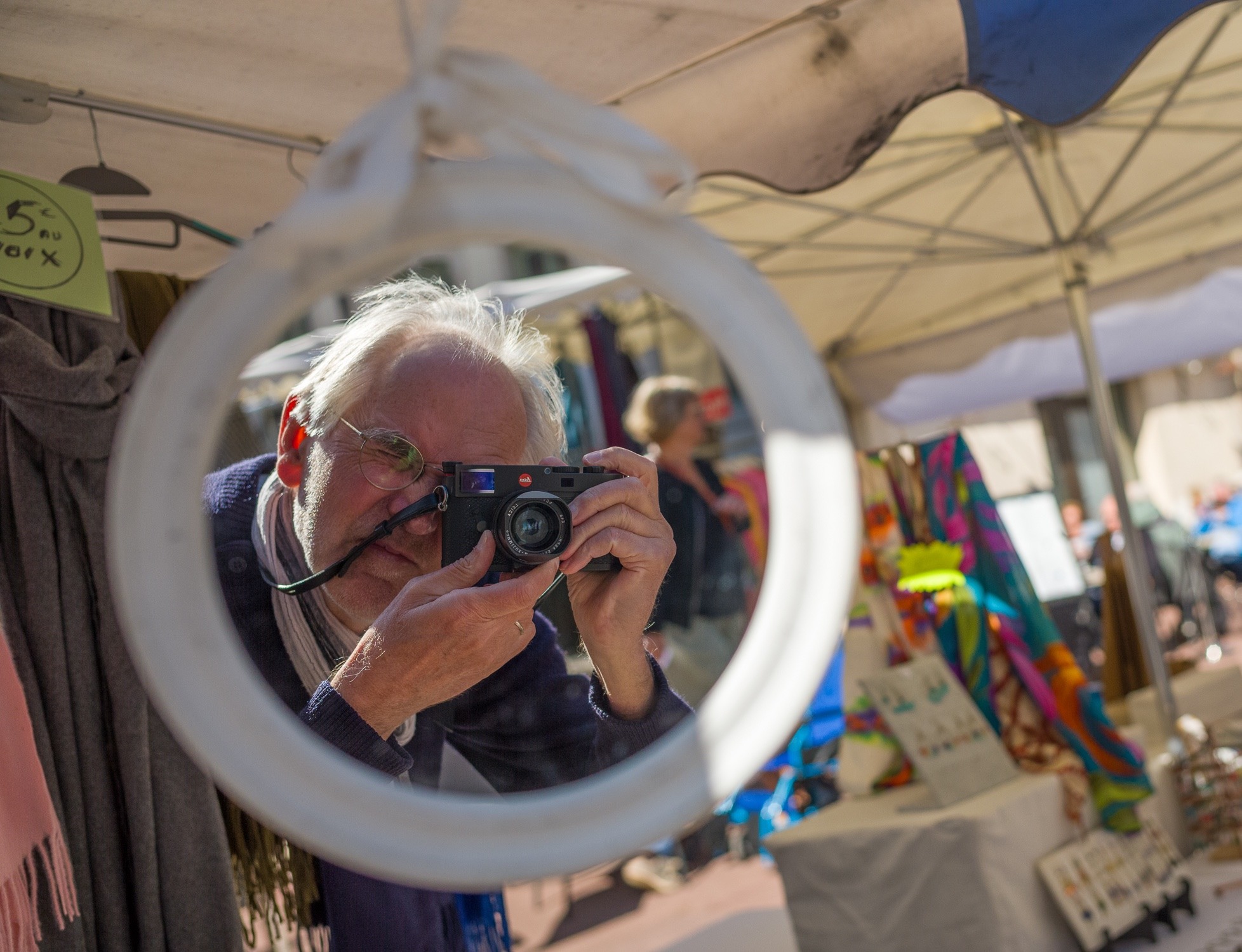

Alberti Posted May 1 Share #13 Posted May 1 (edited) On 6/10/2023 at 1:52 AM, Segal said: I like v2's ability to focus closer and the new hood, but I understand that not everyone cares about them I changed the hood of my FLE and replaced it with a hood of a Summarit 35/50: it is a perfect fit. And more: the lens has a [slight?? like Tappan notes] propensity to flare when the sun is in the lens, washing out the excellent contrast. The original cap is not that great in that respect; it is good for a 24mm . . My new combo is great. Welcome, dear visitor! As registered member you'd see an image here… Simply register for free here – We are always happy to welcome new members! I see no vignetting ever (checking it amateuristically). Edited May 1 by Alberti 5 Link to post Share on other sites Simply register for free here – We are always happy to welcome new members! I see no vignetting ever (checking it amateuristically). ' data-webShareUrl='https://www.l-camera-forum.com/topic/377956-summilux-35mm-asph-fle-version-1-vs-version-2/?do=findComment&comment=5794959'>More sharing options...
