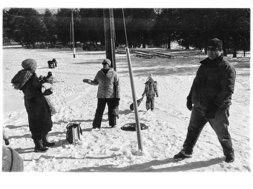

anonymous Posted February 28, 2023 Author Share #27  Posted February 28, 2023 Advertisement (gone after registration) 4 minutes ago, plaidshirts said: Does the position of the sun and the location of the bar/flare in your photos match adan’s diagram? What about the one with the bar on top AND bottom? I don’t see it but the effect is eerily similar. In some cases yes, but in some cases, no.  I would say there are a few where I definitely wasn't shooting into the sun but the effect is still present.  Here's an example from the same roll as the negatives I pictured earlier. Welcome, dear visitor! As registered member you'd see an image here… Simply register for free here – We are always happy to welcome new members! Quote Link to post Share on other sites Simply register for free here – We are always happy to welcome new members! ' data-webShareUrl='https://www.l-camera-forum.com/topic/368802-strange-horizontal-bar-on-negatives-driving-me-crazy/?do=findComment&comment=4703814'>More sharing options...

plaidshirts Posted February 28, 2023 Share #31  Posted February 28, 2023 (edited) 13 hours ago, anonymous said: In some cases yes, but in some cases, no.  I would say there are a few where I definitely wasn't shooting into the sun but the effect is still present.  Here's an example from the same roll as the negatives I pictured earlier. Welcome, dear visitor! As registered member you'd see an image here… Simply register for free here – We are always happy to welcome new members! This photo fits the conditions to a tee. The sun was above the lens almost directly in front. I wasn't using a hood on my Elmar 50/2.8. There's even a sliver of a darker, more distinct secondary bar on top. Edited February 28, 2023 by plaidshirts Quote Link to post Share on other sites More sharing options...
