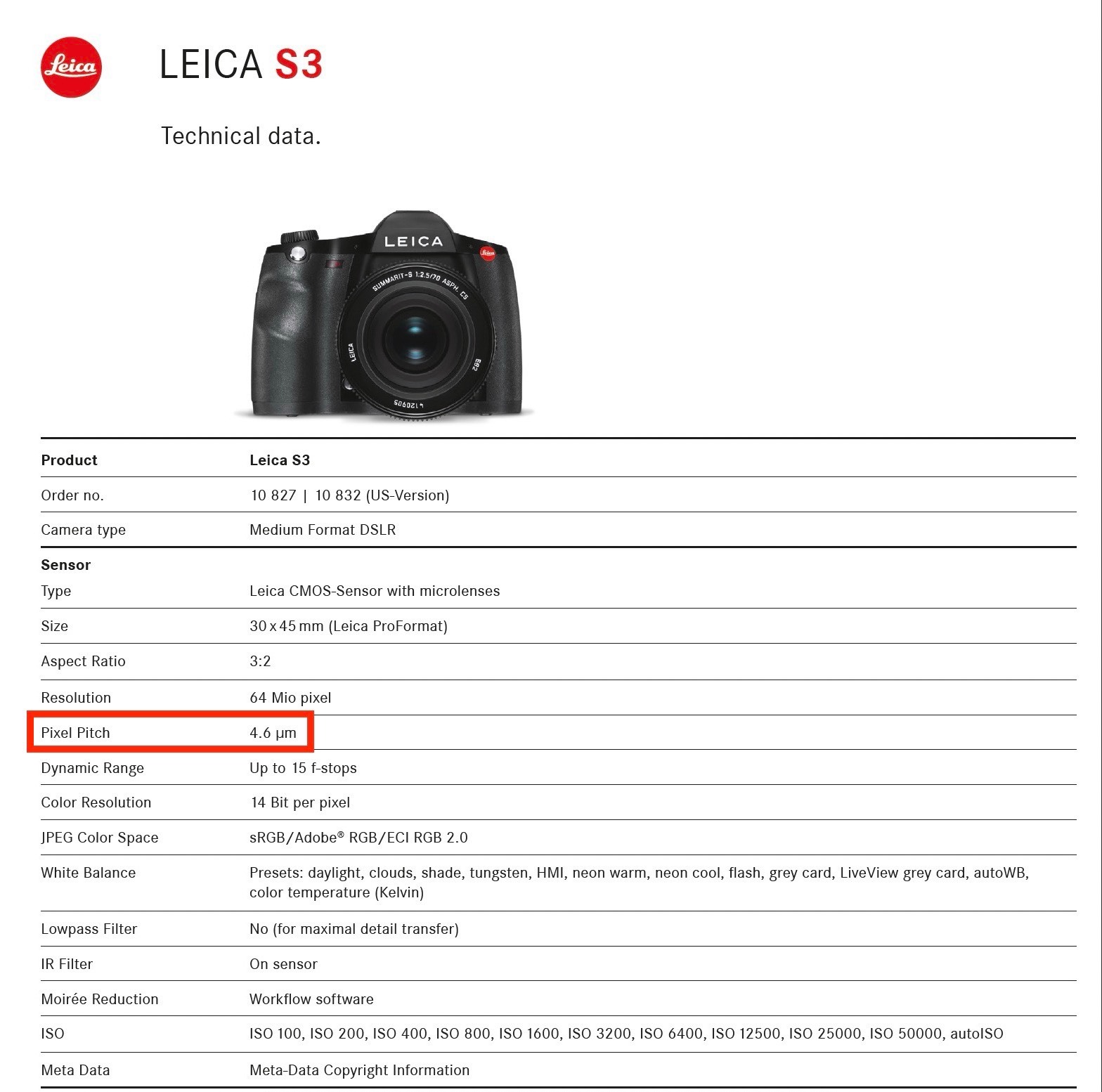

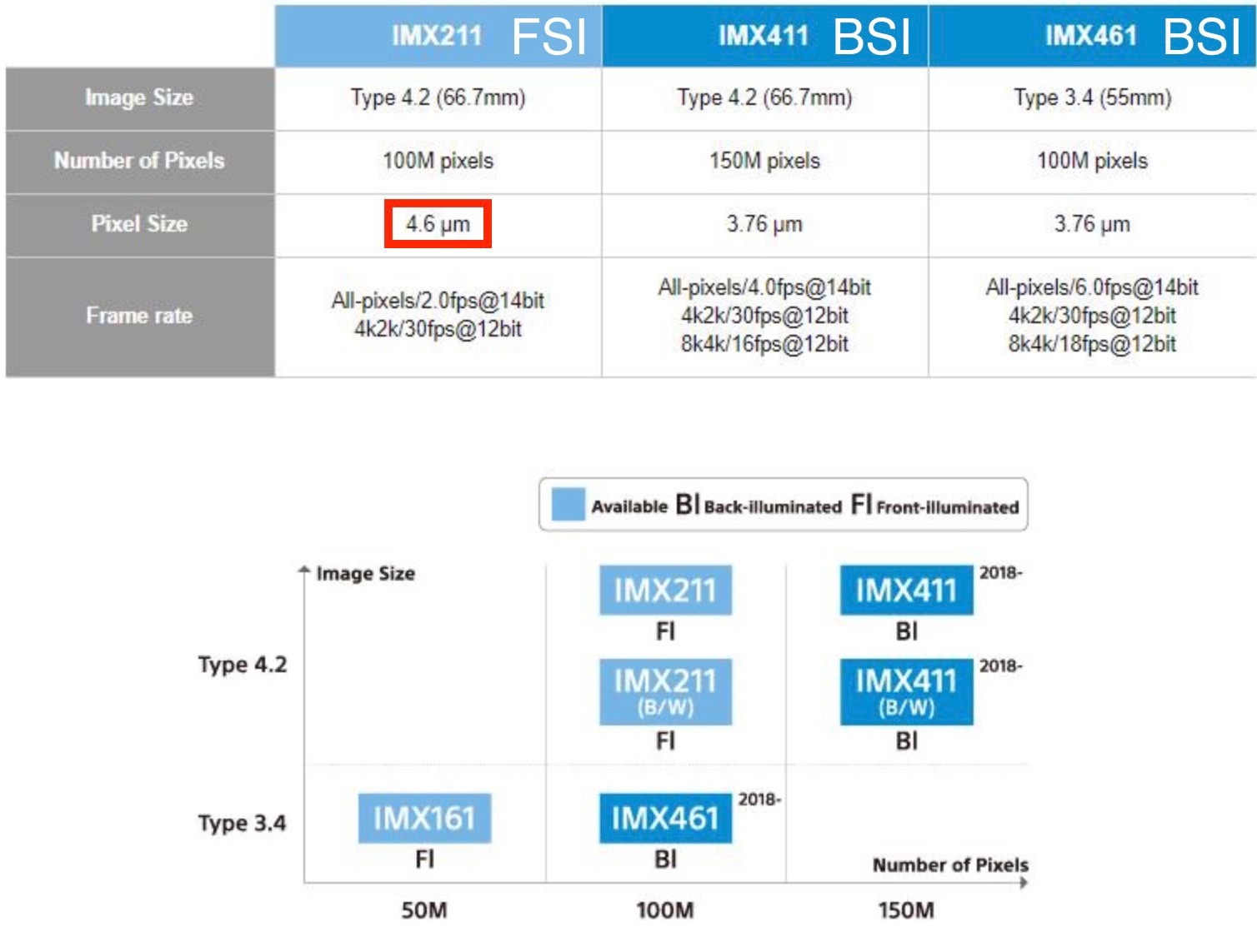

hdmesa Posted February 17, 2024 Share #1498 Posted February 17, 2024 (edited) 1 hour ago, Jeff S said: I didn’t write anything about the SL2. The M10R/M sensors are different. I think Stefan referred to the back of the sensor when discussing changed electronics, but it was from a lengthy interview long ago. Jeff M10-R should be FSI since I don't think Sony had a BSI sensor with the pixel pitch shared by the S3 and M10-R. Both the S3 and M10-R were likely cropped versions of the Sony IMX211, which is FSI. Welcome, dear visitor! As registered member you'd see an image here… Simply register for free here – We are always happy to welcome new members! Edited February 17, 2024 by hdmesa Link to post Share on other sites Simply register for free here – We are always happy to welcome new members! ' data-webShareUrl='https://www.l-camera-forum.com/topic/364887-sl3-rumors/?do=findComment&comment=5043138'>More sharing options...
Jeff S Posted February 17, 2024 Share #1499 Posted February 17, 2024 1 hour ago, hdmesa said: M10-R should be FSI since I don't think Sony had a BSI sensor with the pixel pitch shared by the S3 and M10-R. Both the S3 and M10-R were likely cropped versions of the Sony IMX211, which is FSI. Welcome, dear visitor! As registered member you'd see an image here… Simply register for free here – We are always happy to welcome new members! Toni Felsner, S3 Product Manager, said that the S3 sensor architecture was produced specifically for that camera and not shared by any other camera. No wonder Leica needed to spread costs across two other products. https://www.reddotforum.com/content/2018/09/photokina-2018-the-leica-s3/ Jeff Link to post Share on other sites More sharing options...
hdmesa Posted February 17, 2024 Share #1500 Posted February 17, 2024 (edited) 38 minutes ago, Jeff S said: Toni Felsner, S3 Product Manager, said that the S3 sensor architecture was produced specifically for that camera and not shared by any other camera. No wonder Leica needed to spread costs across two other products. https://www.reddotforum.com/content/2018/09/photokina-2018-the-leica-s3/ Jeff "You will not see this sensor technology in any other camera." – Sounds like cryptic marketing speak. Fujifilm recently called the new GFX 100 II sensor "all new" but turns out it's the same sensor as the 100/100S with some tweaks. If Toni was referring to BSI in that quote, then it would have been a false statement since BSI sensors had been around for a few years and were in use at the time. Then you have the curious case of the pixel pitch being identical to the IMX211. That would be crazy odds to randomly share a pixel pitch of 4.6 μm with a Sony sensor in production at the time. My guess would be either that Leica had Sony manufacture some sort of unique modification to the underlying IMX211 silicon – or Toni was excluding the Phase One cameras when making that statement, as Phase One cameras were largely irrelevant to the broad consumer photographic market and the only other camera system to use the IMX211 I believe. Edited February 17, 2024 by hdmesa Link to post Share on other sites More sharing options...
