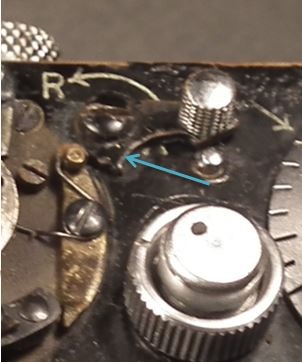

camera was originally IA from 1930 and had fix mounted Elmar. Top cover is version from after April 1937, this would be thus the earlieast conversion date. Body cover with vulcanite has been renewed as well, is without lugs because model II does not have it as well. Chromed pin on A/R level could be because during conversion one modification has been added (when shutter es spanned and you move lever to R position the shutter runs without opening, before this modification it run with tze speed set on the dial). This modification trequired new A7R lever and I assume that at the time of coversion Letz did not have anymore lever with nickeled knob. Detail supporting this assumption is not visible on any photos, but visible as well when the top cover is on - A/R lever has a sort of camb

Maybe it will be more clear on these photo's.
