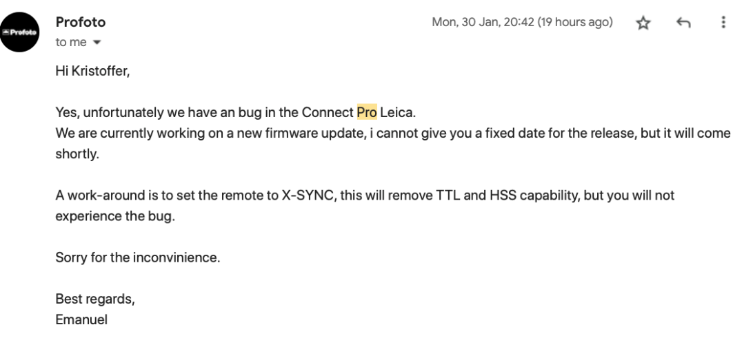

Kristofferpaulsen Posted April 3, 2023 Author Share #42 Posted April 3, 2023 Okay so today I was shooting, and thought I had my non-ttl Connect Pro on the camera, as I was in the studio and knew I wouldn’t need TTL/HSS etc.. I tend to do that as I know the batteries will last longer (okay now that I think about it, shooting in the manual mode on the Leica one is probably the same..). While I was shooting a glitch developed where after 5-10 shots the SL2 would freeze, and I’d have to take the battery out to get it going again. Really weird. Then i noticed the power on my D2 had dipped down to three.. weird.. I’m there trying all the things, restarting Capture One, swapping lenses, restarting the camera, restarting the computer.. All of that.. But then I realise I’m on the Connect Pro for Leica, not the TTL one, so I change to the other trigger (non-ttl), and hey we’re in business and everything is fine. I realised that I’ve hardly actually used the TTL version since the update, as I’ve been mostly in the studio when I’ve been using it.. I checked firmware after, connecting my phone and bringing up the Connect app, and sure enough there was another firmware update. I’m not sure if it was just the one that came out on 20th March (or whenever it was), but I thought i’d chime in and share my experiences to anyone else who just updated their camera, and not the trigger. (Although I feel like I did update the trigger.. maybe..). It was super weird behaviour, that the trigger would make the camera freeze after five or so frames. Spun me right out. Shows that there’s obviously a lot of communication going on between the devices. One other thing I noticed was that when I swapped to the non-ttl trigger, was that I had to do my disable exposure preview thing, whereas on the Connect Pro for Leica it’s obviously telling the body it’s there, and adjusts the preview automatically. Cool. Link to post Share on other sites More sharing options...

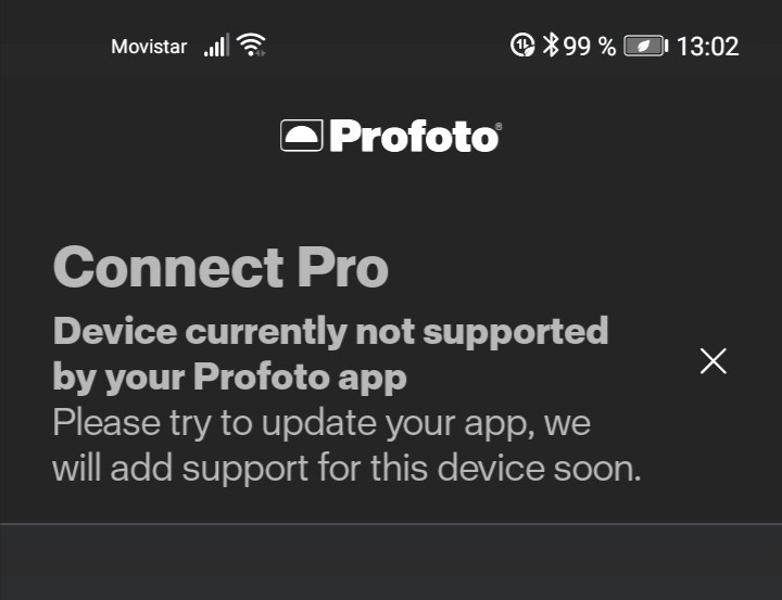

Paco Rosso Posted April 11, 2023 Share #54 Posted April 11, 2023 (edited) 1 hour ago, robb said: You need the app on your phone from profoto. Then when you connect to the unit through Bluetooth, you can update the firmware in the connect pro trigger… Robb The app says device not supported... Welcome, dear visitor! As registered member you'd see an image here… Simply register for free here – We are always happy to welcome new members! Edited April 11, 2023 by Paco Rosso Link to post Share on other sites Simply register for free here – We are always happy to welcome new members! ' data-webShareUrl='https://www.l-camera-forum.com/topic/364079-profoto-connect-pro-for-leica-problems/?do=findComment&comment=4747375'>More sharing options...
robb Posted April 11, 2023 Share #55 Posted April 11, 2023 Don’t know what to tell you. Just have to wait a bit more I guess. my unit updated new firmware couple weeks ago. Seems to be fine now. Maybe they discovered some new bugs… send them an email. Robb 1 Link to post Share on other sites More sharing options...
