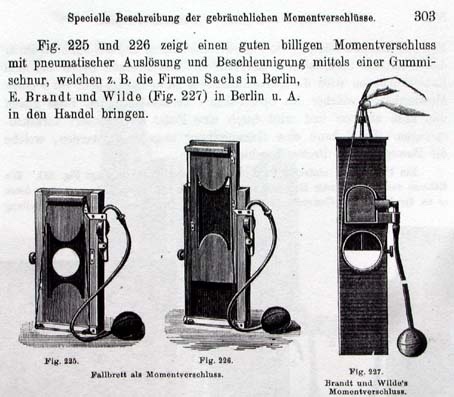

Ambro51 Posted November 10, 2022 Share #10 Posted November 10, 2022 I’m glad this is being discussed again. As to the slide, it’s fluididy of motion depends on all pieces being clean and polished. The screws holding the barrel base must not “pinch” the slide. The slide must not be bent, the area at the edge of the circle must not be bent. It tha a very subtle concave curve, in that the center is the only part that actually touches. (I could tinker with the original and in two minutes have it flicking). Oh....Gravity is an absolute constant, I did check the consistency by placing the camera touching the iPhone with the sound record feature going.....all seemed to be identical. ••••. Did the lens interchange with the Cine camera, well, let someone there check. It sure looks possible in these photos. It depends how easily the complete lens cell withdraws from the Cine camera, and if it goes into M875 and clamps in with the thumbscrew. Welcome, dear visitor! As registered member you'd see an image here… Simply register for free here – We are always happy to welcome new members! Link to post Share on other sites Simply register for free here – We are always happy to welcome new members! ' data-webShareUrl='https://www.l-camera-forum.com/topic/344929-die-mutter-der-ur-leica/?do=findComment&comment=4560622'>More sharing options...
