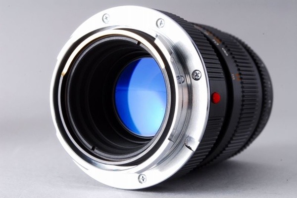

lct Posted May 3, 2022 Share #9 Posted May 3, 2022 The Rokkor 90/4 for Minolta CL is just a clone of the Elmar-C 90/4 with different filters (40.5mm vs Series 5.5). Easy way to recognize it is the "Leitz" and "made in Germany" engravings you can see below. Welcome, dear visitor! As registered member you'd see an image here… Simply register for free here – We are always happy to welcome new members! 1 Quote Link to post Share on other sites Simply register for free here – We are always happy to welcome new members! ' data-webShareUrl='https://www.l-camera-forum.com/topic/332011-minolta-m-rokkor-90mm-on-m3/?do=findComment&comment=4428401'>More sharing options...
grahamc Posted May 3, 2022 Share #10 Posted May 3, 2022 (edited) 4 hours ago, gdallas said: Thank you very much. This is I think what I had heard about. The question now is : what’s the best way to tell the difference between a 1970s Rokkor 90/4 and a lens from the 1980s? I am unlikely to be able to inspect any potential purchases physically. Can serial numbers help, maybe? As @lcthas pointed out the Rokkors made for Cl will say "Made by Leit' (in the rim of the glass, as above) . However, the CLE ones - the one you need - will say only 'Minolta' with no mention of Leitz, and no serial number in this location. ( The serial number of the CLE version is on the barrel at the bottom near the mount) I'd highly recommend this lens. I like light lenses so I bought it and the 90mm Leica 'thin' Tele-Elmarit to see how I liked them. The Rokkor is my favourite and was almost a third of the price of the tele-Elmarit. Edited May 3, 2022 by grahamc Quote Link to post Share on other sites More sharing options...
grahamc Posted May 3, 2022 Share #11 Posted May 3, 2022 Like this , but note that the 'Japan' writing at the top is from the filter I have on, it's not on the lens. Serial number location of CLE version is highlighted. Welcome, dear visitor! As registered member you'd see an image here… Simply register for free here – We are always happy to welcome new members! 1 Quote Link to post Share on other sites Simply register for free here – We are always happy to welcome new members! ' data-webShareUrl='https://www.l-camera-forum.com/topic/332011-minolta-m-rokkor-90mm-on-m3/?do=findComment&comment=4428414'>More sharing options...

lct Posted May 3, 2022 Share #13 Posted May 3, 2022 Made in Japan in engraved at the bottom of the CLE version. Welcome, dear visitor! As registered member you'd see an image here… Simply register for free here – We are always happy to welcome new members! 1 Quote Link to post Share on other sites Simply register for free here – We are always happy to welcome new members! ' data-webShareUrl='https://www.l-camera-forum.com/topic/332011-minolta-m-rokkor-90mm-on-m3/?do=findComment&comment=4428462'>More sharing options...
