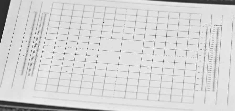

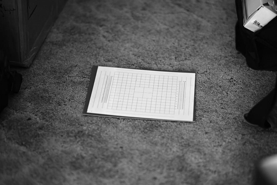

On 3/16/2022 at 7:20 PM, fotomas said:
Instead off guessing I made a quick test with the APO-Summicron 90 ASPH on an M 246. Here are the results:
Distance was about 1,7 m. Fully open, focussed with the EVF on the center of the chart.
First a overview with the total scene:
2. Detail with no filter
3. with a clear UV/IR cut filter
4. Yellow filter
5. Orange filter
6. Red filter
7. Dark red filter
8. IR 715 filter
As you can see there is a slight focus shift to back-focus the longer the wavelength got. The filters used are the top models from B+W or Heliopan.
Looks like the IR cut product the sharpest image?
9 hours ago, fotomas said:
Yes - so it is.
Which is no surprise. Any M camera has a residual IR sensitivity - which means that you get a (quite underexposed) unsharp IR image overlaid on your sharp visible-light one.
