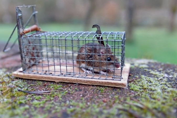

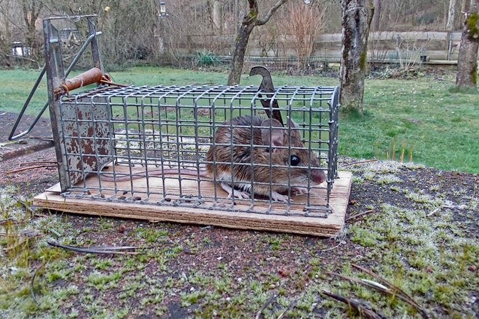

There are cameras, that allow to change the DOF in a picture. One picture taken, change in post only!

Post-focus and post f/stop yes. But no stacking. It is one (1) photo! The first picture is set at f/8 and the second at f/1.0 in post.
It is one photo from the user’s perspective. Are you sure that it did not take multiple ones at the back to achieve this?
edit: actually, the one that was shown look pretty poor (especially some of the grass on the left). So maybe it took only one picture…
edit2: I was wrong, I did not consider sensors that can get spatial information. Thanks @jankap for pointing this out  🙂
I think it's a picture from a novel Lytro camera, which is a "Light-field" camera that captures all the light rays in the field (not just one plane) at one instant and uses mathematical formulae to subtract light rays afterwards to provide the image at different apertures.  (That's my unclear explanation anyway. :lol:)
