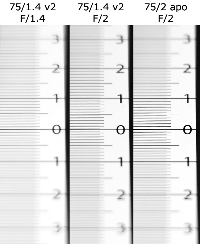

lct Posted January 5, 2021 Share #42  Posted January 5, 2021 1 hour ago, pippy said: Out of curiosity; was the focus point at minimum focus and (pardon my ignorance) is the min/focus the same for both lenses? Both at about 1m if i remember well. MFD is 0.7m on 75/2 apo and a bit less than 0.8m on 75/1.4 v2. 1 Link to post Share on other sites More sharing options...

adan Posted January 6, 2021 Share #51  Posted January 6, 2021 10 hours ago, lct said: DoF rendering of 75/1.4 v2 and 75/2 apo. Déjà vu sorry but useful IMO. Welcome, dear visitor! As registered member you'd see an image here… Simply register for free here – We are always happy to welcome new members! I quote lct's post again so the image is on this page of the thread as well. Because it shows several interesting points about optics in general, as well as the specific 75mms. 1. Yep, the 75mm Summilux shows slightly more apparent DoF than the Summicron, even at f/1.4. The upper "2" and the fine lines thereabouts have sharper edges than as imaged by the Summicron. This stems from the Summilux having spherical aberration. In effect the spherical curvature of the lens at the outer rim focuses in one plane, while the center of the lens focuses in another plane, and the concentric areas of the lens in between focus on planes in between. This is basically "focus stacking" - done by the glass rather than post-processing. https://en.wikipedia.org/wiki/Spherical_aberration (A side note on real-world lens production. Spherical lens surfaces are actually a lousy way to make lenses, because they inherently cause spherical aberration. They are however much easier and cheaper to make than ASPH surfaces - at least before 1992 or so, when precise press-molding of non-spherical (aspherical) surfaces was developed. And the mathematics of a constant-radius (spherical) lens are easier to calculate. So for about 99% of the existence of man-made lenses, they were made with spherical surfaces (at least approximately). But lens designers eventually began combining multiple elements of different glasses in part to correct the problem (and in part to correct other aberrations).) 2) I rather like using fast teles with a little such spherical "focus stacking" with rangefinder cameras. It is more accomodating to mis-focusing in fast-moving situations - one gets a wider range of "sharp enough to use." 3) It also creates a smoother transition from sharp to fuzzy. Some people like a more abrupt focus fall-off, but I think that is part of what contributes to the "clinical" label on some (not all) modern ASPH lenses. At any rate, a question of taste and not "good" or "bad." 4) Spherical aberration usually also causes "focus shift" - as one stops down and removes some of the abberant rays, the plane of "best focus" shifts forward or backwards. Yet the Summilux 75 manages to avoid significant focus shift (at least between f/1.4 and f/2.0). Maybe one of the reasons Dr. Mandler apparently considered the 75 Summilux one his best designs. More generally... 5) This shows that theoretical DoF calculated for an "ideal lens" can be misleading when one uses real-world lenses. It pays to know one's tools. 6) It is also a nice illustration that DoF extends approximately twice as far into the background as it does into the foreground (compare the front and back 1s and 2s). if you want a range of, perhaps 1.5 m to 3m to appear sharp with a 50mm lens at f/16 - you need to focus at about 1.9m, not halfway between 1.5m and 3m (i.e. 2.25m). 4 2 Link to post Share on other sites More sharing options...

lct Posted January 6, 2021 Share #53  Posted January 6, 2021 At the same aperture, Summilux and Summicron 75 have more or less the same total DoF in my view. The Summilux has just more DoF in the background but less so in the foreground. Link to post Share on other sites More sharing options...

pippy Posted January 6, 2021 Share #55 Â Posted January 6, 2021 8 hours ago, adan said: 6) It is also a nice illustration that DoF extends approximately twice as far into the background as it does into the foreground (compare the front and back 1s and 2s). if you want a range of, perhaps 1.5 m to 3m to appear sharp with a 50mm lens at f/16 - you need to focus at about 1.9m, not halfway between 1.5m and 3m (i.e. 2.25m). Absolutely. My class at college was taught the "One-third-In" rule-of-thumb for obtaining best-spread of DoF very early on in the course. Philip. Link to post Share on other sites More sharing options...
