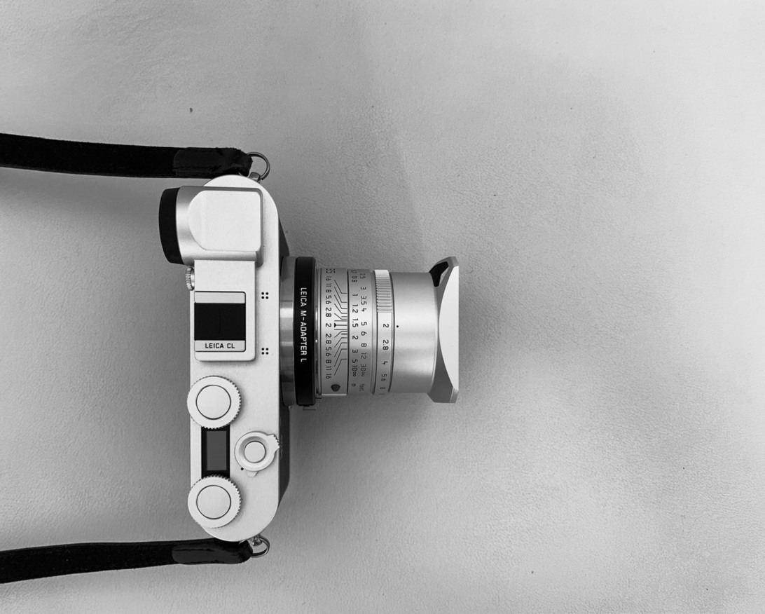

eev776 Posted April 16, 2020 Share #1 Posted April 16, 2020 (edited) Advertisement (gone after registration) Not sharp? Recently I got a brand new SUMMICRON-M 35mm f/2 ASPH. Silver 11674. Made in 2018. I use it on my CL (Made in 2019) and it’s not sharp as I thought it would be, especially at wide open. I’m kind of disappointed, thinking maybe I’m doing something wrong, because some shots coming out sharp, basically sharpness of this lens is not constant. Is it maybe because it’s on CL? For example I’m comparing it with my APO-Summicron-M 90mm or Summilux-M 50mm, both lenses at wide open or one more f stop perform excellent. I was shooting Summicron M 35mm at day time handheld on the street, ISO100, Shutter 1/1000, f2 - most of images are not sharp. Took a test with tripod indoors, f2 is still not sharp as other Leica M lenses. Anybody has the same issues? Welcome, dear visitor! As registered member you'd see an image here… Simply register for free here – We are always happy to welcome new members! Edited April 16, 2020 by eev776 Quote Link to post Share on other sites Simply register for free here – We are always happy to welcome new members! ' data-webShareUrl='https://www.l-camera-forum.com/topic/308604-not-sharp-new-summicron-m-35mm-f2-asph-silver-11674-on-cl/?do=findComment&comment=3954803'>More sharing options...

jaapv Posted April 16, 2020 Share #3 Posted April 16, 2020 The lettering on the lens looks pretty sharp to me. Aren't you confusing "sharpness" (whatever that may be) with contrast? This is an old design lens and provides a more more smooth and less clinical rendering -to my eye more pleasing- than newer examples, especially modern APO designs, the Summilux 50 is also APO, despite not being marked as such. Especially the falloff into OOF rendering is markedly different. Using the Summicron 35 on the CL is only an advantage as it cuts off the weaker corners. 2 Quote Link to post Share on other sites More sharing options...

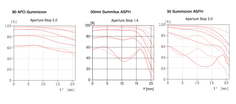

adan Posted April 17, 2020 Share #12 Posted April 17, 2020 (edited) Let's go to the MTF charts (Leica's own): Welcome, dear visitor! As registered member you'd see an image here… Simply register for free here – We are always happy to welcome new members! Personally, I always found the 35 Summicron non-ASPH (v.4) to have a bit better raw resolution (not the same as MTF) at the center, compared to the ASPH. Over multiple samples of each. However the ASPH does have higher contrast (slightly) and holds up farther into the corners. Less coma/astigmatism - although not coma-free: note the divergent sagittal (solid) and tangential (dashed) lines, compared to the tighter spacing for the 90 and 50. BTW, astigmatism can look like camera shake (smeared in one direction ||| but not the other —). Let's face it, when one pays $900-1400 more for the 50 and 90, one is getting something for one's money. Edited April 17, 2020 by adan 2 Quote Link to post Share on other sites Simply register for free here – We are always happy to welcome new members! Personally, I always found the 35 Summicron non-ASPH (v.4) to have a bit better raw resolution (not the same as MTF) at the center, compared to the ASPH. Over multiple samples of each. However the ASPH does have higher contrast (slightly) and holds up farther into the corners. Less coma/astigmatism - although not coma-free: note the divergent sagittal (solid) and tangential (dashed) lines, compared to the tighter spacing for the 90 and 50. BTW, astigmatism can look like camera shake (smeared in one direction ||| but not the other —). Let's face it, when one pays $900-1400 more for the 50 and 90, one is getting something for one's money. ' data-webShareUrl='https://www.l-camera-forum.com/topic/308604-not-sharp-new-summicron-m-35mm-f2-asph-silver-11674-on-cl/?do=findComment&comment=3955305'>More sharing options...

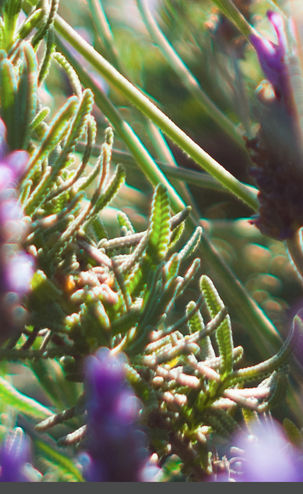

eev776 Posted April 17, 2020 Author Share #16 Posted April 17, 2020 (edited) Taken f2. Should been sharper in top center of cactus. Welcome, dear visitor! As registered member you'd see an image here… Simply register for free here – We are always happy to welcome new members! Edited April 17, 2020 by eev776 Quote Link to post Share on other sites Simply register for free here – We are always happy to welcome new members! ' data-webShareUrl='https://www.l-camera-forum.com/topic/308604-not-sharp-new-summicron-m-35mm-f2-asph-silver-11674-on-cl/?do=findComment&comment=3955347'>More sharing options...

eev776 Posted April 17, 2020 Author Share #18 Posted April 17, 2020 3 hours ago, adan said: Let's go to the MTF charts (Leica's own): Welcome, dear visitor! As registered member you'd see an image here… Simply register for free here – We are always happy to welcome new members! Personally, I always found the 35 Summicron non-ASPH (v.4) to have a bit better raw resolution (not the same as MTF) at the center, compared to the ASPH. Over multiple samples of each. However the ASPH does have higher contrast (slightly) and holds up farther into the corners. Less coma/astigmatism - although not coma-free: note the divergent sagittal (solid) and tangential (dashed) lines, compared to the tighter spacing for the 90 and 50. BTW, astigmatism can look like camera shake (smeared in one direction ||| but not the other —). Let's face it, when one pays $900-1400 more for the 50 and 90, one is getting something for one's money. This is interesting, I guess that is why people get more expensive Summilux-M 35mm. But I must say that my APO-Summicron 90mm still sharper than Summicron 35mm. Quote Link to post Share on other sites More sharing options...
jaapv Posted April 17, 2020 Share #19 Posted April 17, 2020 1 hour ago, eev776 said: Taken f2. Should been sharper in top center of cactus. Welcome, dear visitor! As registered member you'd see an image here… Simply register for free here – We are always happy to welcome new members! The top center is simply out of focus. 1 Quote Link to post Share on other sites More sharing options...
