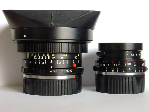

pippy Posted April 13, 2020 Share #56 Â Posted April 13, 2020 (edited) 18 hours ago, Dennis said: Â ...I prefer an appropriate DOP for that particular shot, rather than a sharper image....Did you know DoF at F/22 ? Would love to know, please. So we can know the range is, from infinity to .... at F/22, F/16 and F/11. And I will tell you if it worth to go from 95% sharp at F/11 to 0% at F/22... Well, I've had a good look at the scale engraved on the lens (if that is any use!) and... f11 = less that 50cm - infinity. Actual focus mark = 100cm. f16 = approx 30cm - infinity. Actual focus mark = 70cm. f22 = VERY approx (it is MILES off the scale) approx 15cm - infinity. Actual focus mark = (approx) 50cm. Philip. Edited April 13, 2020 by pippy Link to post Share on other sites More sharing options...
