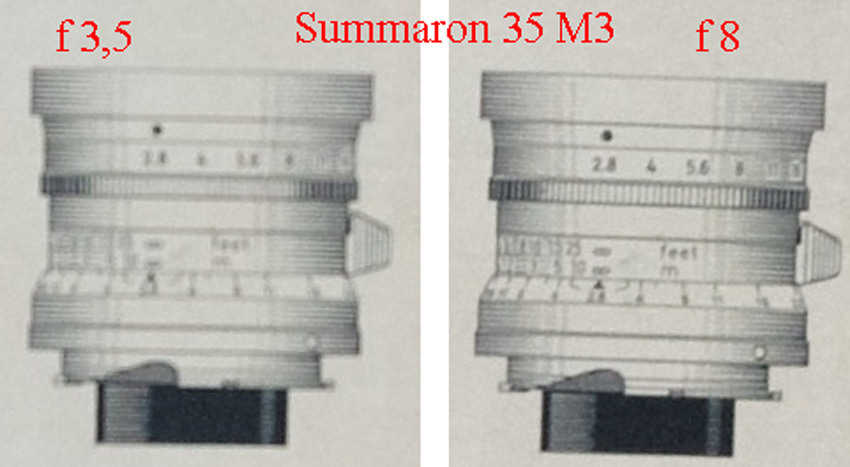

luigi bertolotti Posted March 22, 2020 Share #8 Posted March 22, 2020 (edited) 45 minutes ago, fabianoliver said: Hi Luigi, this picture was take at 3.5, the only light is the sky..... Hum, I confirm my idea... there is some issue : I took a pair of trivial shots (M240, jpg Out Of Camera) with my lens which is a "twin" of yours : Summaron 3,5 with goggles (s/n 1.555.644) , one at f 3,5, the other at f8 (focus on the Leitz box) Welcome, dear visitor! As registered member you'd see an image here… Simply register for free here – We are always happy to welcome new members! Not great difference, globally.. a bit more of vignetting at 3,5 Edited March 22, 2020 by luigi bertolotti Link to post Share on other sites Simply register for free here – We are always happy to welcome new members! Not great difference, globally.. a bit more of vignetting at 3,5 ' data-webShareUrl='https://www.l-camera-forum.com/topic/307685-summaron-3535-questions-and-pictures/?do=findComment&comment=3936714'>More sharing options...
luigi bertolotti Posted March 22, 2020 Share #9 Posted March 22, 2020 (edited) And with an heavy crop, as excpected, detail (drawing onto the box) is sharper at f8 : Welcome, dear visitor! As registered member you'd see an image here… Simply register for free here – We are always happy to welcome new members! Edited March 22, 2020 by luigi bertolotti 1 Link to post Share on other sites Simply register for free here – We are always happy to welcome new members! ' data-webShareUrl='https://www.l-camera-forum.com/topic/307685-summaron-3535-questions-and-pictures/?do=findComment&comment=3936716'>More sharing options...

fabianoliver Posted March 22, 2020 Author Share #12 Posted March 22, 2020 Hi, Thanks Pippi, and Luigi! for take the time to upload your test!! I see a big difference in contrast, with my copy with both diaphragms.... and I don't see a big difference in contrast between 3.5 and 8 in your tests ( as mine has). I think the best I can do is a CLA, and seen what happens then....I hope just a CLA resolves all the problems... I keep in touch!, and thanks again to all of you! thanks Luigi! Fabian 1 2 Link to post Share on other sites More sharing options...
