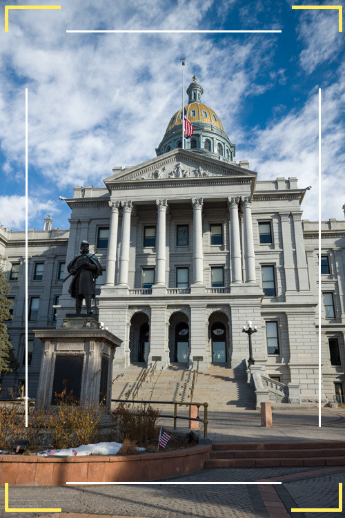

adan Posted December 18, 2019 Share #2 Posted December 18, 2019 That is correct. I haven't tried it myself yet, but am on the watch for a used version of the current 21 "dual-FF/M8" finder, since I use both focal lengths. For me it is not just a question of not seeing the built-in 28 lines, but of better showing the "perspective" a 28 delivers (big foregrounds-small backgrounds), and also accuracy - the external finders show more of the final 28mm picture than the internal lines. The image below shows what the camera's internal 28mm lines show (~"32mm" FoV - white lines), and what the "M8 lines" of the 21mm external finder (or a true 28mm finder) will show (yellow lines), and what is in the final picture. Welcome, dear visitor! As registered member you'd see an image here… Simply register for free here – We are always happy to welcome new members! 2 2 Link to post Share on other sites Simply register for free here – We are always happy to welcome new members! ' data-webShareUrl='https://www.l-camera-forum.com/topic/304529-use-of-21mm-brightline-finder-on-m-a-for-28mm-lens/?do=findComment&comment=3875555'>More sharing options...
ArneNorris Posted December 18, 2019 Author Share #3 Posted December 18, 2019 Andy, This really confirms my intuitions about using the 28 on my M-A. Thank you for taking the time to explain things so well. The image you provided showing the viewing angle differences is extremely helpful. Thank you for taking the time! Arne Link to post Share on other sites More sharing options...
