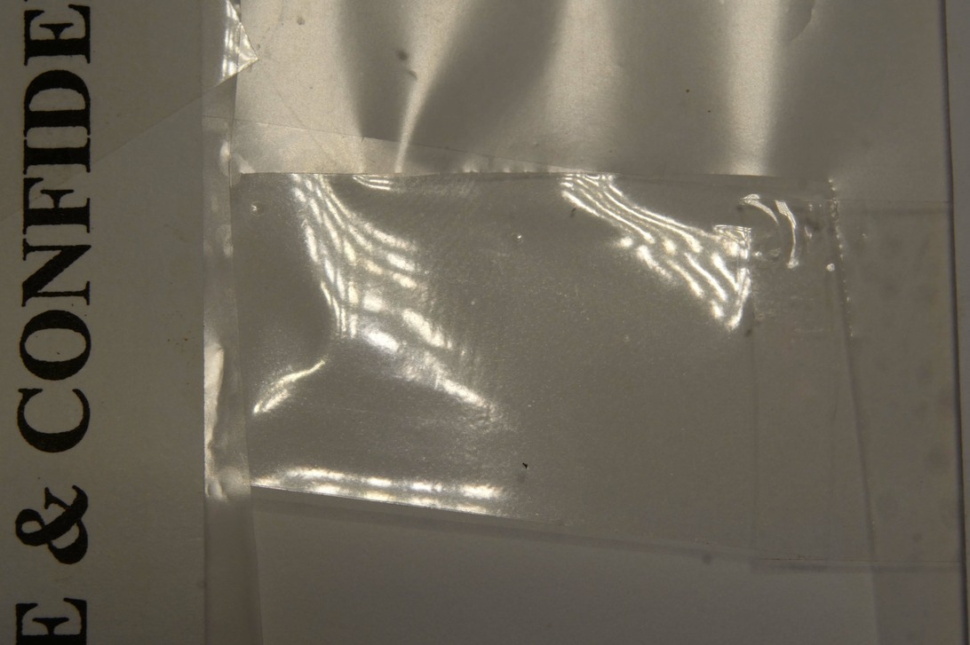

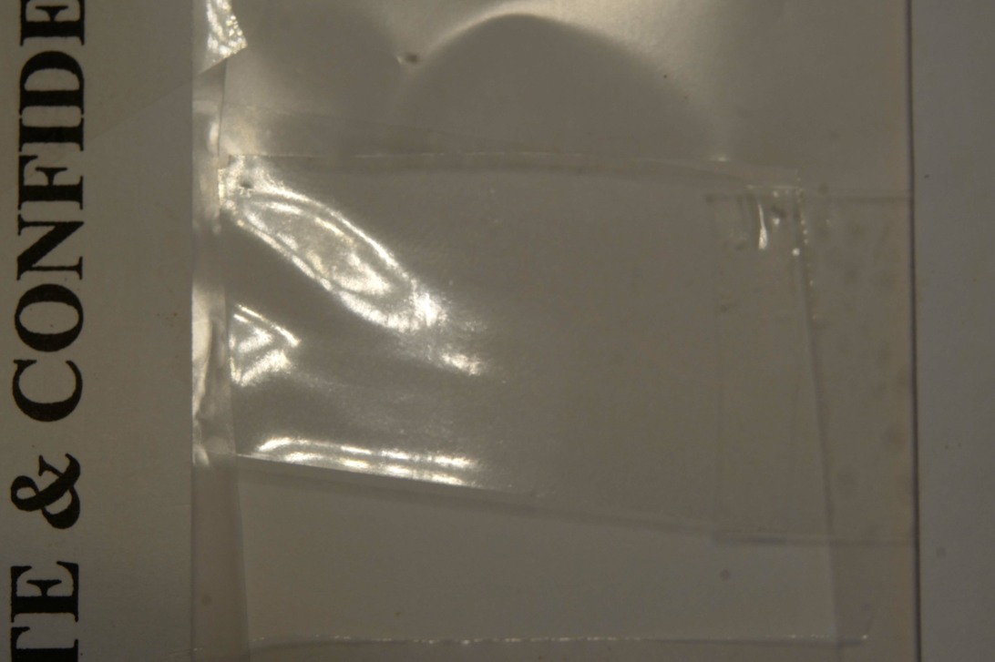

SrMi Posted October 6, 2020 Share #41 Posted October 6, 2020 Advertisement (gone after registration) 4 hours ago, Eclectic Man said: Regarding my Rocket blower (though this may affect other makes). I just tested it by taking a piece of sellotape(R) and using the blower on it. The result is quite disturbing: It seems that instead of cleaning the sensor, it is actually depositing little bits of debris on the sensor. Before (sellotape is clean): Welcome, dear visitor! As registered member you'd see an image here… Simply register for free here – We are always happy to welcome new members! And after blowing with the Rocket: At lest two large particles at centre bottom and just right of centre top after blowing. No wonder my sensor needs cleaning. Any suggestions for a clean blower? When using Rocket Blower, you may have lifted dust surrounding the tape which then landed on the tape. I have some blowers with filters at air-intake, but find them too much a hassle. Remember to hold the camera upside down when using the blower. Link to post Share on other sites More sharing options...
