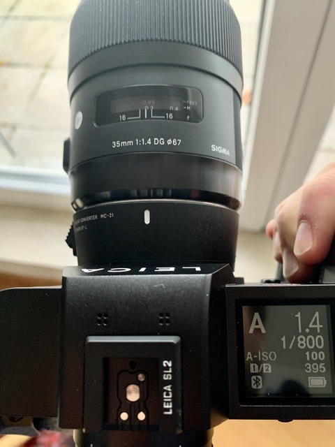

What about MC-21 and SL2 ? Working or not ?

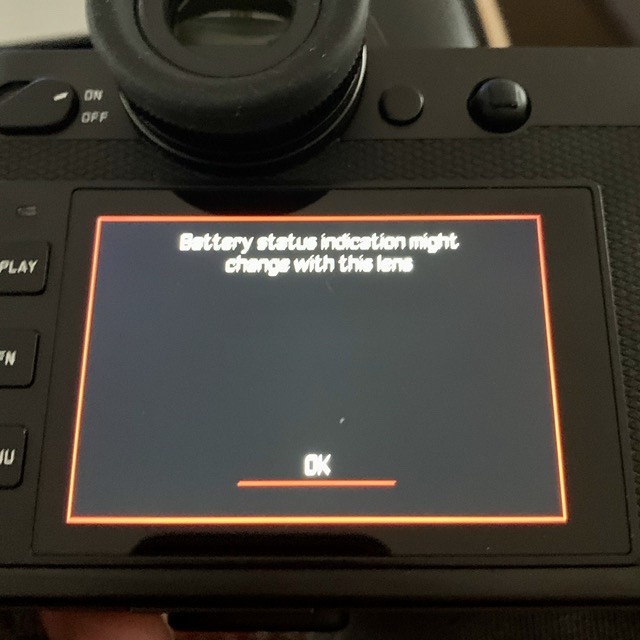

I am able to use the MC-21 with a Sigma 35mm F1.4 Art EF-Mount. Autofocus is slow but not too bad. There’s a message every time you change to the MC-21 from a native l-mount lens, stating “battery status indication might change with this lens”
I have tried myself both adapters now - the Sigma 21and the Novoflex. Both work together with the SL 2 just as the Novoflex did it with the SL. Not better not worse woth the lenses I tried and which are my only ones from Canon. Used lenses were the Canon 180 mm Macro, the 100 mm Macro (old one, not L) and the MP-E 65. Last one has no AF at all, the other two can be used with AF but not really when used in very short distance = macro use. The magnification possbility of the camera works.
I get the same massage as mentioned above - but it results in no problem.
There's a firmware update for the MC-21 from Sigma: https://www.sigma-global.com/en/download/lenses/firmware/mount-converter_mc21/sa-l/
Try it,  it may get rid of the battery message. I had a similar warning on the SL 601 & CL with the Sigma 45mm lens.  After doing the lens FW update the message has gone.
