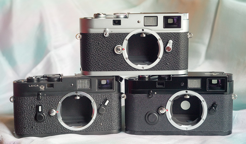

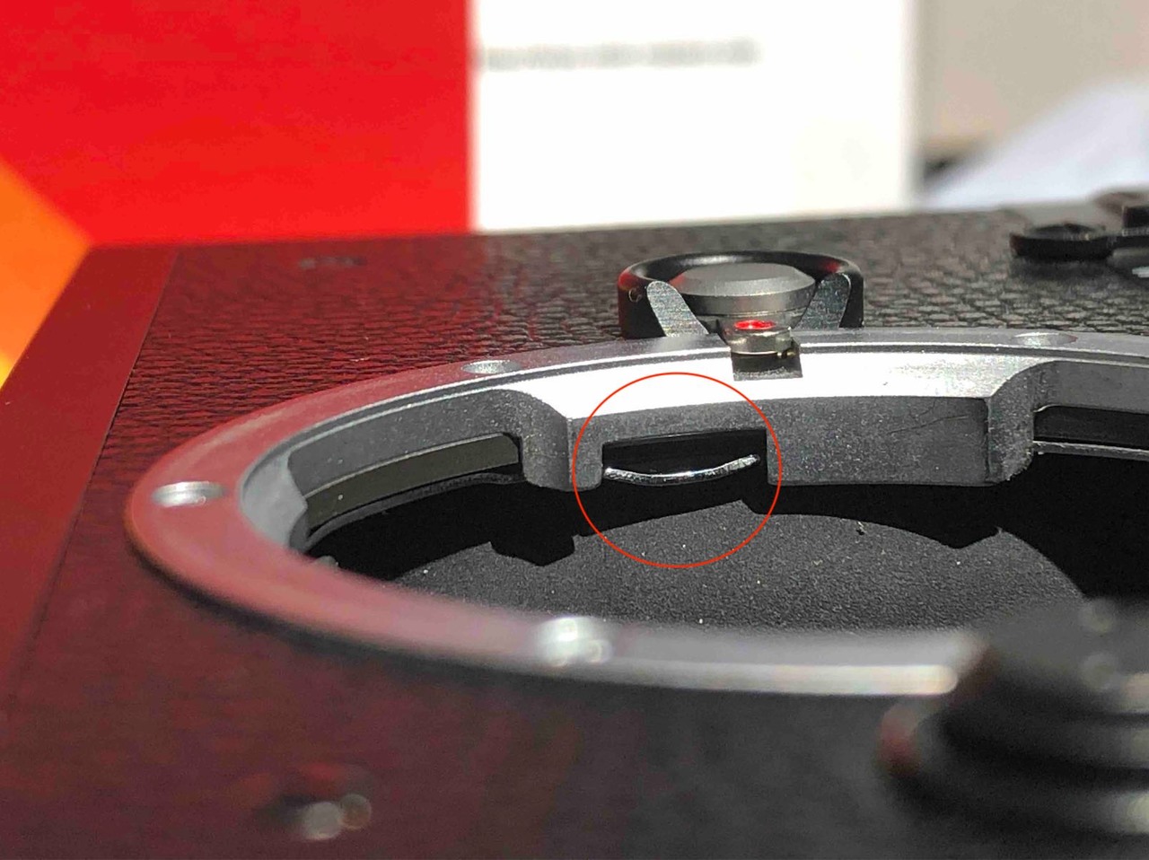

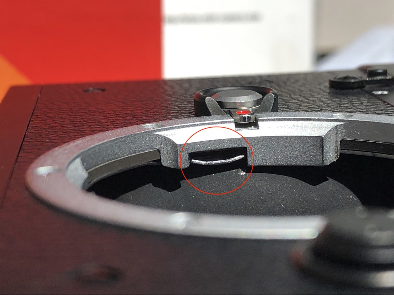

a.noctilux Posted August 4, 2019 Share #17 Posted August 4, 2019 (edited) Years ago, some loose mount in my Ms, not the lenses mount/unmount cause that I think. To cure this loose lens mount, by then Leitz/Leica tech took some minutes to bent the spring in the mount. After that the Ms can operate without loose/wear for years. I don't know if this kind of know-how is still available : just bending the spring but not too much or too little. Have a look at these mounts from M4/MP/M-A. M-A and M4, no "baffle" as seen on MP's chamber. So with good amount of spring bending ( by good tech who knows how to do this of course ) without unmounting the lens mount, this can be cured quickly. Welcome, dear visitor! As registered member you'd see an image here… Simply register for free here – We are always happy to welcome new members! Edited August 4, 2019 by a.noctilux Link to post Share on other sites Simply register for free here – We are always happy to welcome new members! ' data-webShareUrl='https://www.l-camera-forum.com/topic/299190-new-m-a-lens-seating-problem/?do=findComment&comment=3791328'>More sharing options...

adan Posted August 6, 2019 Share #19 Posted August 6, 2019 On 8/4/2019 at 11:22 AM, a.noctilux said: Have a look at these mounts from M4/MP/M-A. M-A and M4, no "baffle" as seen on MP's chamber. I don't the baffle has any affect on lens mounting - especially for the two lenses the OP mentioned. It does have a lot to do with whether the camera has an internal meter, however. No baffle, no meter - MA, M4 (and M4 variants) Baffle, meter - M6, M6ttl, M7, MP The baffle is there to prevent spurious light or flare hitting the meter cell and messing up the meter reading. (BTW - I wish Leica would put a baffle into the M10 - it flares with any 90 I've tried and could use the extra "internal lens hood." But that's for another thread.) Link to post Share on other sites More sharing options...
