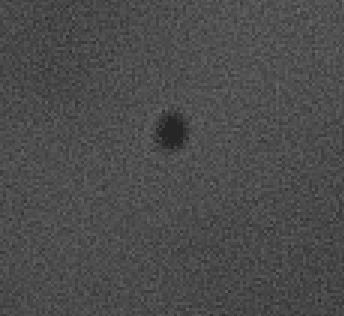

Magnus_L_Andersson Posted March 10, 2019 Share #1 Posted March 10, 2019 (edited) Advertisement (gone after registration) Got my Mk1 from one of the first batches and sadly with corrosion and a replaced sensor after long battles before Leica officially recognized the problem. I recently learnt, from posts here how to find out which one that was used, that I got the 52 version, and not the 53. Have not used the camera that much since the replacement way back, due to an analog M-A obsession for a while, but picking up my Mk1 I noticed some worrying dots again (see enclosed snapshot). Worth noting that I have not changed the lens since I got the camera back from sensor replacement, hence dust due lens switches should be close to zero. Friends, is this the first sign of yet another corrosion problem? I never got obvious halos in the first instance that often are highlighted, but Leica did say it was corrosion anyway. If so, it will be last time and sadly a switch to an M10-D? /magnus Welcome, dear visitor! As registered member you'd see an image here… Simply register for free here – We are always happy to welcome new members! Edited March 10, 2019 by Magnus_L_Andersson Link to post Share on other sites Simply register for free here – We are always happy to welcome new members! ' data-webShareUrl='https://www.l-camera-forum.com/topic/295078-not-corrosion-again-i-hope/?do=findComment&comment=3699560'>More sharing options...
Advertisement Posted March 10, 2019 Posted March 10, 2019 Hi Magnus_L_Andersson, Take a look here Not corrosion again... I hope. I'm sure you'll find what you were looking for!
mmradman Posted March 11, 2019 Share #2 Posted March 11, 2019 What date you had sensor replaced, are you sure you have the the corroded sensor replaced with the latest version? To get better idea what is the proportion of image crop showing that anomaly, looks small but not typical dust, could be bad. Link to post Share on other sites More sharing options...
jaapv Posted March 11, 2019 Share #3 Posted March 11, 2019 It does look like corrosion, but one would need to inspect the sensor to be sure. If your sensor was replaced more than five years ago, I fear that Leica will hit you with the 50% charge. However, if it is just this one spot, you could simply treat it like a dust spot and clone it out. If you have Photoshop, make a droplet. Or, alternately, take advantage of Leica's trade-in offer. Link to post Share on other sites More sharing options...
Magnus_L_Andersson Posted March 11, 2019 Author Share #4 Posted March 11, 2019 mmradman, the sensor was replaced 2015705 and as I wrote it was replaced with a version 52 that I think is the old one. The spot is the the regular size of those often showed as bad ones. jaapv, hoped that you would have said that it was definitely not corrosion. I have sent Leica an email today with dng, and it was replaced 2015/05 so we will see what they want to do. The sad thing is that my camera was from the first batch to Sweden (#2) and I spotted these weird things very early on and if it has to got to Germany again it will be the fourth time and up till now it has spent almost a year in services. /magnus Link to post Share on other sites More sharing options...
Magnus_L_Andersson Posted March 12, 2019 Author Share #5 Posted March 12, 2019 UPDATE: Corrosion was confirmed by Leica based on dng, and camera will be sent to Germany and I have to decide on sensor replacement or upgrade. Sadly, upgrade to M10-D was not possible to get, hence it boils down to sensor replacement or leaving the monochrome world for an M10-P. Since, based on comments here there seems to be some kind of consensus that the 246 Monochrom cannot offer the same "feeling" as the the M9 version, or? How would you do? If I go for M10-P, then it will be the M-A that will have to do the b/w work, and the M10-P to be the color camera. In other words, opposite to my current approach. In summary, after 3 visits to Leica before they in May '15 replaced the sensor it's time for the 5th and last (?) visit to Germany... 😞 Link to post Share on other sites More sharing options...

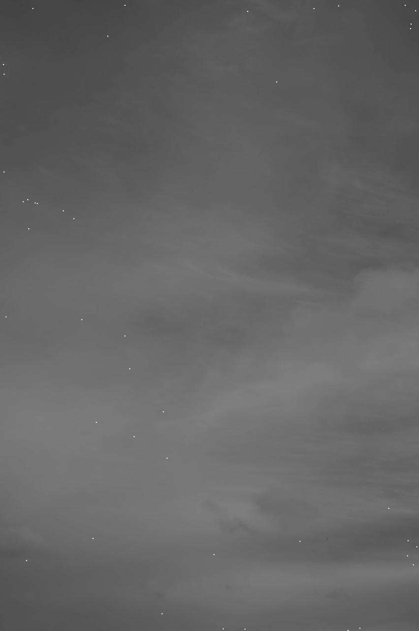

Magnus_L_Andersson Posted March 20, 2019 Author Share #14 Posted March 20, 2019 Waiting for feedback from Germany, but looks like they stick to the official prices for replacements and upgrades. A thorough pixel peeping reveals that first signs of corrosion was possibly already occurring in March ‘17, ie almost two years after sensor replacement. However, both then and now I would have interpreted the spots as dust. Not until early this year I would have started to get annoyed by the amount of “dust” and probably sent the camera for cleaning, then realising it was corrosion. Hence, shit happens and for some several times... Have been catching up on everything written on the MM1, MM2 and M10 knowing that b/w is my preferred digital mindset. For color I have the M-A and film with the characteristics I would anyway try to replicate by simulation if I would use a camera like the M10. Hence, then it boils down to sensor replacement or MM2, or the need for better low light properties than offered by MM1 when going above ISO 3200, But, even up to 6400 the MM1 noise looks “nice” according to several “experts”. So, as it feels right now most probably I will replace the sensor and use the money I “save” on not upgrading to get a Summaron 28/5.6 and wait for 2021 and a most probably ridiculously expensive M11 with >50 MP. /Magnus Link to post Share on other sites More sharing options...
