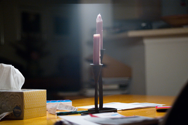

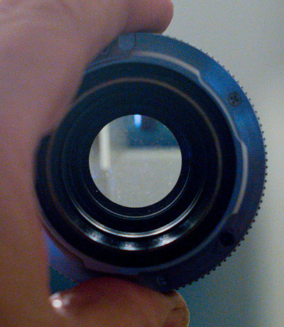

adan Posted February 1, 2019 Share #22 Posted February 1, 2019 (edited) 4 hours ago, RayD28 said: BTW, I'm assuming your photo with the redline is to show an example of flare but my inexperienced eye just can't see it. Is the flare on the store front or on the grate in the foreground? No, that sample was to show the resolution and fine details in the grating. Here's what the flare looks like, shot under my "acid test" for flare - my dining-room table with a chandelier overhead just outside the picture. Note "column" of foggy flare down the center. This example with no lens hood. Welcome, dear visitor! As registered member you'd see an image here… Simply register for free here – We are always happy to welcome new members! And another more "real-world" example - the bright sky top right (and beyond the picture area) is producing the veiling flare and "graying out" the contrast and crisp shadows. And here's what causes it - bright light(s) in front of the camera reflecting from the inside of the rear barrel, even though the barrel is blackened and partly ribbed. I have not yet found any lens hood that really helps - it's that extreme (if and when the light is in just the right (or wrong) place). I even tried to make my own "gobo"ed hood by taking the best of Leica's own hoods - the metal 12575 - and adding a slip-on rubber cap over the hood, and cutting out a rectangle in the cap to block any light not actually in the field of view. Worked better, but still occasionally allowed "leakage" - and was clunky and large and sort of spoiled the "ultra-small lens" experience. Plus the chopped-up rubber cap fell apart after a month or so. I'm considering whether I can make some kind of round, black-paper "baffle" to fit inside the back of the lens, to block those reflections Otherwise, I'm better off if I simply avoid any shooting into the light. Or at least test the light. Light inside the picture area often produces less flare than light just outside the picture. Edited February 1, 2019 by adan 1 Link to post Share on other sites Simply register for free here – We are always happy to welcome new members! And another more "real-world" example - the bright sky top right (and beyond the picture area) is producing the veiling flare and "graying out" the contrast and crisp shadows. And here's what causes it - bright light(s) in front of the camera reflecting from the inside of the rear barrel, even though the barrel is blackened and partly ribbed. I have not yet found any lens hood that really helps - it's that extreme (if and when the light is in just the right (or wrong) place). I even tried to make my own "gobo"ed hood by taking the best of Leica's own hoods - the metal 12575 - and adding a slip-on rubber cap over the hood, and cutting out a rectangle in the cap to block any light not actually in the field of view. Worked better, but still occasionally allowed "leakage" - and was clunky and large and sort of spoiled the "ultra-small lens" experience. Plus the chopped-up rubber cap fell apart after a month or so. I'm considering whether I can make some kind of round, black-paper "baffle" to fit inside the back of the lens, to block those reflections Otherwise, I'm better off if I simply avoid any shooting into the light. Or at least test the light. Light inside the picture area often produces less flare than light just outside the picture. ' data-webShareUrl='https://www.l-camera-forum.com/topic/293835-90mm-leica-m-suggestions/?do=findComment&comment=3675718'>More sharing options...

RayD28 Posted February 2, 2019 Author Share #24 Posted February 2, 2019 (edited) 9 hours ago, adan said: No, that sample was to show the resolution and fine details in the grating. Here's what the flare looks like, shot under my "acid test" for flare - my dining-room table with a chandelier overhead just outside the picture. Note "column" of foggy flare down the center. This example with no lens hood. Welcome, dear visitor! As registered member you'd see an image here… Simply register for free here – We are always happy to welcome new members! And another more "real-world" example - the bright sky top right (and beyond the picture area) is producing the veiling flare and "graying out" the contrast and crisp shadows. And here's what causes it - bright light(s) in front of the camera reflecting from the inside of the rear barrel, even though the barrel is blackened and partly ribbed. I have not yet found any lens hood that really helps - it's that extreme (if and when the light is in just the right (or wrong) place). I even tried to make my own "gobo"ed hood by taking the best of Leica's own hoods - the metal 12575 - and adding a slip-on rubber cap over the hood, and cutting out a rectangle in the cap to block any light not actually in the field of view. Worked better, but still occasionally allowed "leakage" - and was clunky and large and sort of spoiled the "ultra-small lens" experience. Plus the chopped-up rubber cap fell apart after a month or so. I'm considering whether I can make some kind of round, black-paper "baffle" to fit inside the back of the lens, to block those reflections Otherwise, I'm better off if I simply avoid any shooting into the light. Or at least test the light. Light inside the picture area often produces less flare than light just outside the picture. Adan, thanks again for the great information. The real world shot you show concerns me because I could see the faring problem causing constant problems in spontaneous/reportage shots. The 11800 is so appealing but having to deal with the threat of flare is a turnoff. 8 hours ago, pico said: adan, you might be interested in painting over the glossy black with Stuart Semple's BLACK 2.0 Pico, I'm not very handy so I would never try painting any part of a lens. Do you know if it's something a qualified technician would do, and do you know how successful it might be? 11 hours ago, Fedro said: I had a TE thin 11800 that eventually fell apart and I duly bought a more recent (and in better shape) one that I still use I am not much of a 90 mm person, but that is the kind of lens that I love having as you can just put in your pocket and take out if you need reach I had the APO cron for a while but sold it as I found I was not using it often enough (too nose heavy for my taste) Federo, you and I are thinking along the same lines. I don't believe I'd use a 90mm very often but it would be nice to have a small one that could fit in a coat pocket. Did you also have problems with flaring? 13 hours ago, lct said: From f/2 to f/2.8 and less than $1,500 the choice is rather limited. Among my own copies, my favorites would be: 1. Elmarit-M 90/2.8 # 11807: A bit soft at f/2.8 but plenty sharp above. No significant flaw. Built like a tank. 2. Summarit-M 90/2.4 # 11684: A bit more acutance than the 90/2.8 above, especially at f/2.8. No significant flaw but the lens is a bit soft at corners below f/5.6. Hard to find at $1,500 but the previous 90/2.5 (# 11685) has the same optical qualities AFAIK. I have no experience with it though 3. Summicron-M 90/2 # 11123: Almost perfect but bulky. 4. Summicron-M 90/2 # 11136: Similar rendering as Elmarit above, a bit soft at f/2 which is fine for portraits, but much CA. 5. Tele-Elmarit-M "thin" 90/2.8 # 11800: The most compact 90/2.8. Similar rendering as Elmarit but flare prone when light sources are outside the frame. FWIW lct, you are another contributor that always provides thorough details and examples and I thank you for taking time to respond. I especially appreciate you mentioning the model numbers. Edited February 2, 2019 by RayD28 1 Link to post Share on other sites More sharing options...

adan Posted February 3, 2019 Share #31 Posted February 3, 2019 (edited) There is a pattern - the light source has to be 1) outside the picture area, but 2) inside the lens's image circle. As I noted in post #22, the source of the 90TEM flare is mostly reflections off the inside the lens barrel (or camera body) - behind the glass parts. If a bright light source is far enough off to the side or top/bottom, it doesn't get projected at all (it isn't within the image circle), and if it is in the picture itself, it is being projected onto the film or sensor, not the black metal around the lens or inside the camera, and thus not reflecting from anything as flare. In this schematic (approximate dimensions), if there is a bright light source within the various pink areas, it may bounce off the inside of the lens or camera and then hit the film or sensor as foggy veiling flare. A bright light in the white zones outside or inside won't produce the "reflective" flare. It also shows why a normal round lens hood will help, but not remove the chance of flare completely. My home-made rectangular "key-hole" cap+hood did quite well - but is kludgy and clunky. Thus, when I pointed the camera at the male guitarist and included the spotlight in the picture, minimal flare - and when I pointed the camera at the singer and put the spotlight well outside the image circle, no flare. Same for removing the flare in the artist-dude portrait - I just changed position so that the guilty light was farther to the right, outside the "pink zone." Welcome, dear visitor! As registered member you'd see an image here… Simply register for free here – We are always happy to welcome new members! Edited February 3, 2019 by adan 4 1 Link to post Share on other sites Simply register for free here – We are always happy to welcome new members! ' data-webShareUrl='https://www.l-camera-forum.com/topic/293835-90mm-leica-m-suggestions/?do=findComment&comment=3677179'>More sharing options...
