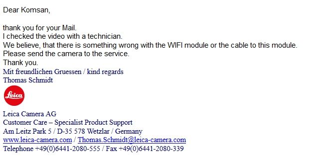

Ingo Posted February 7, 2018 Share #4 Â Posted February 7, 2018 This really looks strange. Â Have you tried to reset the camera to factory settings? Link to post Share on other sites More sharing options...
komy14 Posted February 8, 2018 Author Share #5  Posted February 8, 2018 (edited) This really looks strange.  Have you tried to reset the camera to factory settings? Yes,I try to reset camera and remove sdcard and all of adapter,But problem still it.  I email to leica support and send link video,They said   And now i contact to seller and sent link video,email form Leica support,And tell about problem.Seller full refund to me.  Thank you so much,Cheers!!! Edited February 8, 2018 by komy14 1 Link to post Share on other sites More sharing options...

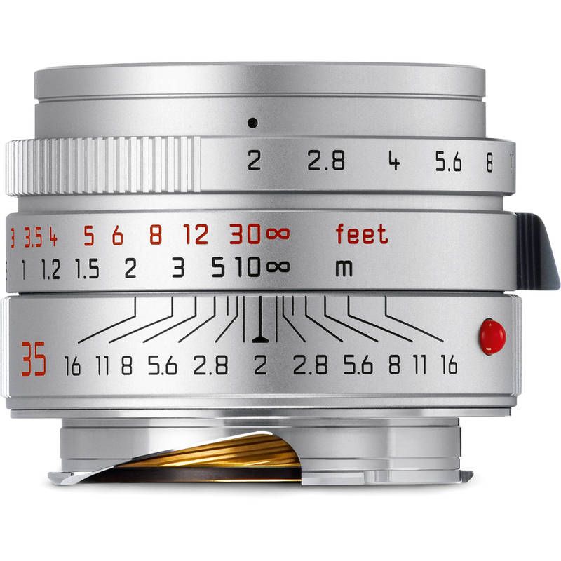

komy14 Posted February 16, 2018 Author Share #6  Posted February 16, 2018 Dear Sir,  From This reboot problem I returned camera to the seller,And seller change new camera to me.  I testing new camera with leica lens summicron 35f2 and card sandisk micro sd sandisk ultra32gb.    Everything it ok,and work fine.  I drive my car back home (about 20km),And when I arrived.  I turn switch on camera and go to Wlan menu.  Camera still reboot again!!!  What happen to my camera.  Please tell me What's happening?  Best Regards  Komsan R. Link to post Share on other sites More sharing options...
