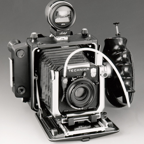

pico Posted July 7, 2017 Share #25 Posted July 7, 2017 (edited) My vision is so bad that focusing on a ground glass is out of the question. The only way, other than a pinhole, that I could shoot LF is with a rangefinder. And my LTM Leicas are just so much easier. You have not lived until you have done large format, or at least 6x9cm medium format. I hope your vision is no worse than mine. Look to a Linhof Super Technika with the added viewfinder. If you use perspective controls then first use rangefinder focus, pop the back open and make small adjustments. A lot of LF users would admit they use minimal, trivial perspective controls. Be happy. Oh, if you like wide-angle look into Silvestri cameras. There are more simple options for MF. . Edited July 7, 2017 by pico 1 Link to post Share on other sites More sharing options...

tllabron Posted July 11, 2017 Share #40 Posted July 11, 2017 You have not lived until you have done large format, or at least 6x9cm medium format. I hope your vision is no worse than mine. Look to a Linhof Super Technika with the added viewfinder. If you use perspective controls then first use rangefinder focus, pop the back open and make small adjustments. A lot of LF users would admit they use minimal, trivial perspective controls. Be happy. Oh, if you like wide-angle look into Silvestri cameras. There are more simple options for MF. ---------------------------------------------------------------------------------------------------------------------- I loved my Linhof Master Technika camera. I carried it once into the mountains to the head waters (beginning waters) of the Colorado River here in the USA, I got stunning pictures. That is when I was younger and could pack the 17 pound Gitzo tripod and my Linhof and 3 lenses with plates and 2 - 6X7 roll backs up the trail. Someone asked earlier about changing film in the field and I had with my a fairly lightweight darkbag that I carried along with me and some boxes of film so if I shot all my film I could reload the plate holders. Years and years ago there were always a variety of darkbags available, but now-a-days you probably could only get one if you knew someone that had one and could talk them out of it. You just have to have a sensitive touch to mark your film box and your storage box to remember which is which when you are performing the job. Just don't do it in a hurry at the last minute when you need it yesterday, because you may make a mistake you will regret. I used my Linhof when I was in Iceland and took pictures of the waterfalls and geysers and the beautiful landscapes and the icelandic horse. The only place I did not take my Linhof Master Technika was on my African Safari. The longest lens I had for my LF was 275mm f/5.6 Rotlar Rodenstock lens so I left it on board ship and took only my two Leica SL bodies and my lenses that included a 400mm Telyt 6.8 lens, which was on my cameras most of the time. Although I did wish I had the Linhof when were arrived at Mount Kilimanjaro National Park and I was not able to record on 4X5 a shot of the mountain and the plain. I was beautiful. There also was some discussions about drums. I had a Beseler motorized base with variable rotation control and a 8X10 Drum and a 16X20 drum for developing prints and also developing my 4X5 negatives and slides. You must be sure to rotate the drums slow enough as to make sure the fluids are contact with the film but fast enough to give you good developments times. A way of finding this technique out is to develop TRI-X film at different speeds. The faster the speeds the courser the grain is the slower the speed the finer the grain is the result. I have to admit that I have no idea if this is what will happen with the newer emulsions being used today beccause I have not developed film in very long time, so take these suggestions with a grain of salt. Tom L.L. 2 Link to post Share on other sites More sharing options...
