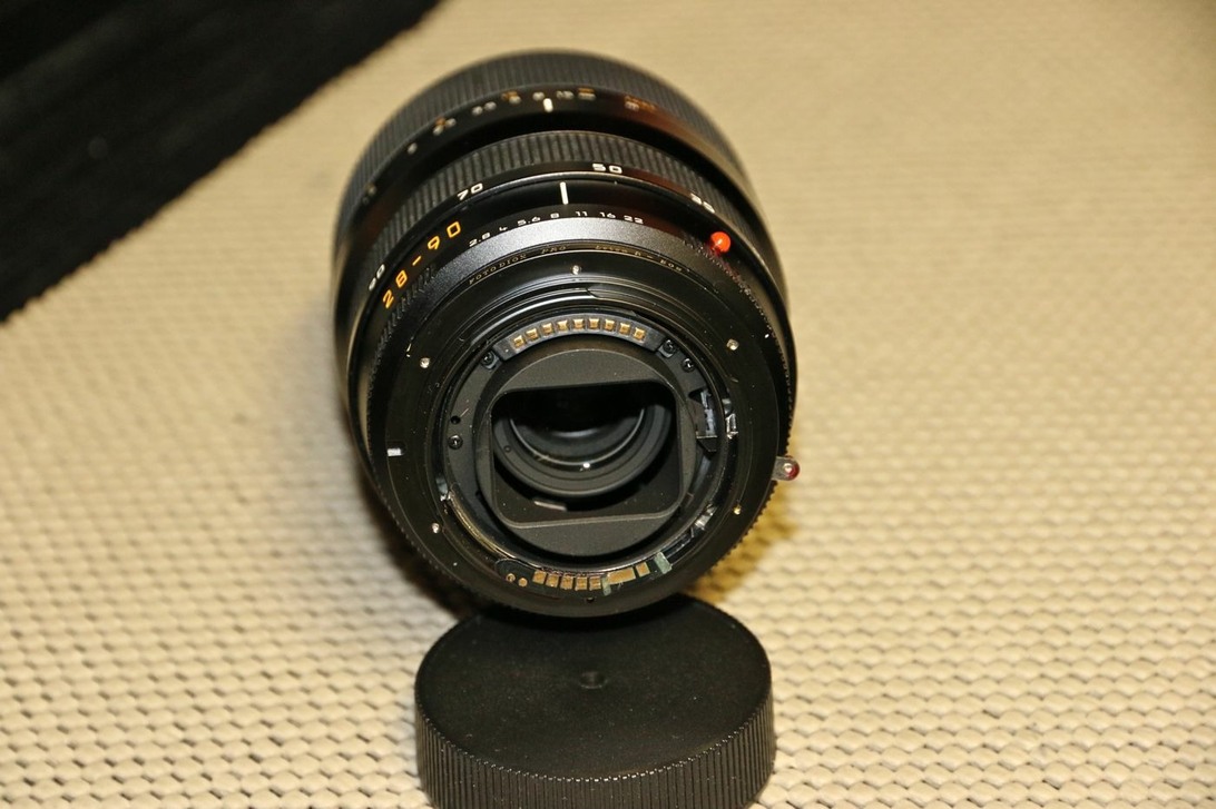

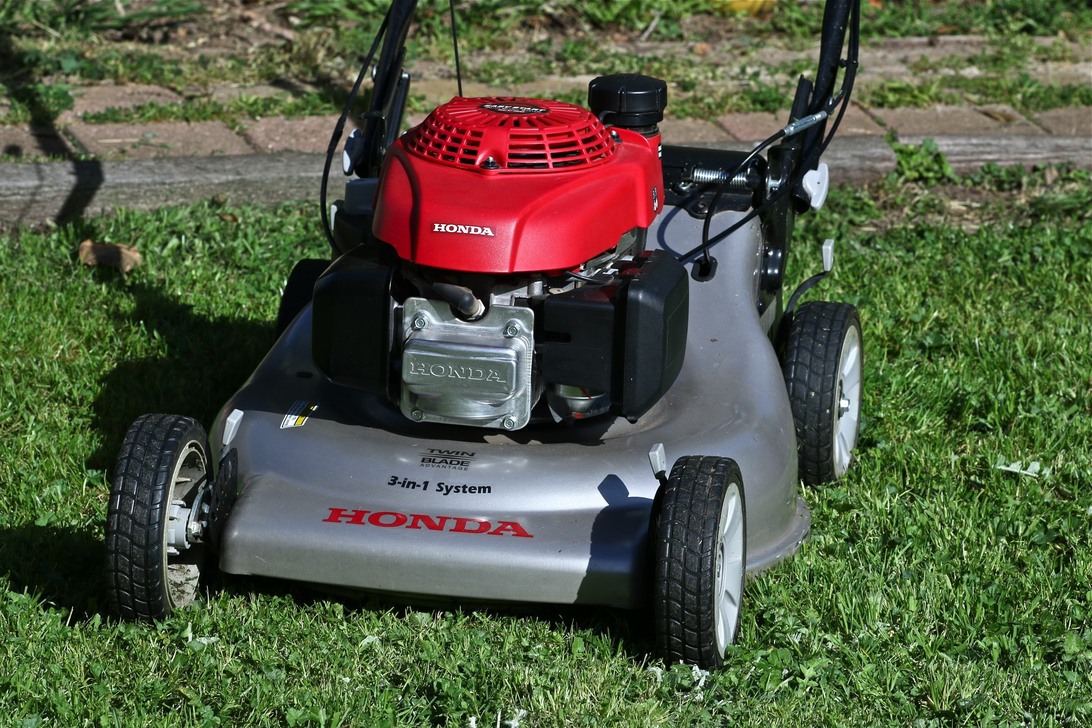

hamey Posted October 10, 2020 Share #69 Posted October 10, 2020 Personally both the Leica R to SL and the Novaflex are dumb adapters, just because the over priced Leica version transfers the Exif data doesn't make it smart. What I consider very smart is my newly acquired 58 USD Fotodiox lens mount adapter for my Leica R to Canon EOS. What so special about it, well it confirms focus confirmation by notifying me by an audible beep beep and a steady green light in the viewfinder when in focus, just like a Canon lens does, very smart in deed. I have used it on all my R lenses and all modes on the Canon and it WORKS. Two Images, one with the adapter on my 28-90mm lens and the other a shot taken of my lawn mower with focus confirmation applied. Also it can remain on the EOS body, just attach the R lenses and you are good to go. Welcome, dear visitor! As registered member you'd see an image here… Simply register for free here – We are always happy to welcome new members! 1 Link to post Share on other sites Simply register for free here – We are always happy to welcome new members! ' data-webShareUrl='https://www.l-camera-forum.com/topic/271825-leica-r-adapter-just-a-tube/?do=findComment&comment=4060486'>More sharing options...
