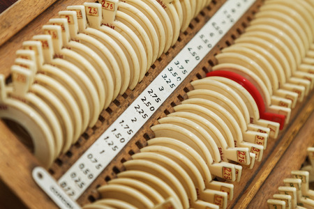

adan Posted January 29, 2017 Share #44 Posted January 29, 2017 Except, your Optometrist doesn't understand the Leica VF demand on your eye's accommodation. Take your M (10, 9, 240 whatever) with you. Once upon a time, the major camera makers provided their dealers with diopter sampler wheels - this one from Contax/Yashica, but I know Nikon made them, and am pretty sure Leica did at some point: http://camerabooks.com/Images/Products/CS-CameraStuff/CS1284-IMG_9234.jpg You mounted it on your camera eyepiece, and turned the wheel to find which correction lens worked best. Presumably, despite or in addition to, their massive self-contained diagnostic machines, optometrists/opticians still have drawers full of single lenses you can hold up with thumb and forefinger to the M viewfinder, and see what they do - probably easier to find an optometrist than a well-equipped camera store, these days. http://us.123rf.com/450wm/jirivondrous/jirivondrous1508/jirivondrous150800011/44286419-optician-with-set-of-trial-frames-and-trial-lenses.jpg?ver=6 That's it for me on this thread - can't stand trying to type "diopter, optician, optometrist" correctly any more. Link to post Share on other sites More sharing options...

jaapv Posted January 29, 2017 Share #50 Posted January 29, 2017 Take your M (10, 9, 240 whatever) with you. Once upon a time, the major camera makers provided their dealers with diopter sampler wheels - this one from Contax/Yashica, but I know Nikon made them, and am pretty sure Leica did at some point: http://camerabooks.com/Images/Products/CS-CameraStuff/CS1284-IMG_9234.jpg You mounted it on your camera eyepiece, and turned the wheel to find which correction lens worked best. Yes, they did; I have one, I'll dig it up and post. Link to post Share on other sites More sharing options...

jaapv Posted January 29, 2017 Share #54 Posted January 29, 2017 Never heard of this sounds interesting though, thank you for posting it. Voilà: Welcome, dear visitor! As registered member you'd see an image here… Simply register for free here – We are always happy to welcome new members! (I see my M3 is rather dusty... ) Edit: More clear on a chrome camera: Link to post Share on other sites Simply register for free here – We are always happy to welcome new members! (I see my M3 is rather dusty... ) Edit: More clear on a chrome camera: ' data-webShareUrl='https://www.l-camera-forum.com/topic/268759-m10-rangefinder-considerably-greater-accuracy/?do=findComment&comment=3199986'>More sharing options...
