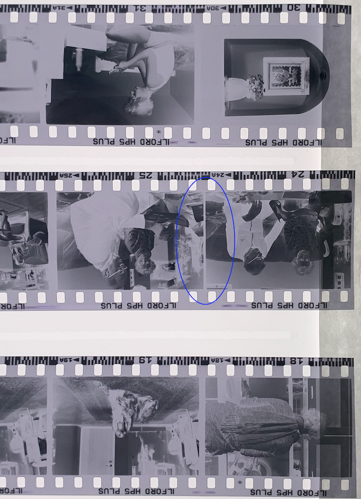

semi-ambivalent Posted February 13, 2016 Author Share #21  Posted February 13, 2016 Advertisement (gone after registration) Yes the frame spacing is dictated by the winding mechanism. If there is no slippage or wear in the mechanism then the distance from centre of each frame to the next should be consistent. The area/size  of each exposure is unaffected by the image circle as it overlaps the film gate by some margin by design. I agree with what Tom explained at #9 .You may get some small variation from the nominal 24x36 film gate dimensions due to the film register  (in different camera designs) and different lenses. As I recall using wide angles was where I noticed this.  I'm not sure how I noticed this thread as I havent shot film for some years. I think because I measured (with vernier calipers) frames from an M3 some time back.  As long as the original poster with his MP has found the discussion helpful it's worthwhile. My MP is just fine, thank you, and learning something is always worthwhile. My epiphany came when NB23 mentioned the wide angle aspect and I realized that rangefinders could put a lens element much closer to the film (than an SLR) so the light rays could get "under" the film gate a bit and produce a larger image. I bet if I looked the image edges are also not as clean or distinct because of this but I'm enjoying a perfectly mediocre cabernet tonight and feeling rather lazy. Just glad the MP is not misbehaving, it's such a nice camera.  Prost!, or something, s-a 1 Link to post Share on other sites More sharing options...

gabrielaszalos Posted May 13, 2020 Share #22  Posted May 13, 2020 (edited) I have also noticed the irregular spacing on my new MP. Happened two times on my latest roll. I have looked through older rolls too (past 20) and I did notice that occasionally it happened that two frames were closer together than others (never overlapping). Frankly I will abstain from contacting Leica Customer Care because I am pretty sure they will ask me to send the camera in and it’s not something I want to do... Not sure if normal or not. My Pentax K1000 doesn’t seem to have it. Perhaps it was too cheap to have mechanical problems (sarcasm). In the photo below, the larger spacing is the norm and the smaller ones is the exception. Welcome, dear visitor! As registered member you'd see an image here… Simply register for free here – We are always happy to welcome new members! Edited May 13, 2020 by gabrielaszalos Link to post Share on other sites Simply register for free here – We are always happy to welcome new members! ' data-webShareUrl='https://www.l-camera-forum.com/topic/256625-mp-frame-spacing-showing-some-variability/?do=findComment&comment=3972352'>More sharing options...

250swb Posted May 13, 2020 Share #26  Posted May 13, 2020 This really is a non-story, sometimes the film slackens a bit, the roll slackens inside the cassettte, if it does slacken you get slightly uneven frame spacing next time you wind on. Link to post Share on other sites More sharing options...
gabrielaszalos Posted May 14, 2020 Share #27  Posted May 14, 2020 Advertisement (gone after registration) 12 hours ago, 250swb said: This really is a non-story, sometimes the film slackens a bit, the roll slackens inside the cassettte, if it does slacken you get slightly uneven frame spacing next time you wind on. I am no expert (by far) in Leica internals but I don’t see what slack in the cassette has to do with the other side of the camera. For this to happen, there would in theory have to be slack between the teeth advancing the sprocket holes and the sprocket holes themselves. Link to post Share on other sites More sharing options...
250swb Posted May 14, 2020 Share #28  Posted May 14, 2020 (edited) 2 hours ago, gabrielaszalos said: I am no expert (by far) in Leica internals but I don’t see what slack in the cassette has to do with the other side of the camera. For this to happen, there would in theory have to be slack between the teeth advancing the sprocket holes and the sprocket holes themselves. Maybe you run with the camera, or the camera gets giggled up and down in the boot of the car, etc. all these things can cause a fraction more film to unwind from the cassette so it's not wound as tight through the film gate. Some films are springier so they can push out of the cassette more or resist relaxing back more than others at different times as they unwind. I'm just saying it's not a mechanical mystery, stuff happens. And the pressure plate is to keep the film flat, it's not a clamp. Even the way people move the advance lever can introduce a small mismatch, an old street photographers trick before digital was to advance the film with lots of tiny movements of the lever so they don't appear to be taking photographs but just composing them, this can cause uneven frame spacing. If you want to start a new topic please do it, I'm not trying to stop you, but maybe it would be useful to make it for all 35mm film cameras, not just Leica, because they will all have uneven frame spacing from time to time. Edited May 14, 2020 by 250swb 1 Link to post Share on other sites More sharing options...
gabrielaszalos Posted May 14, 2020 Share #29  Posted May 14, 2020 Thanks for taking the time to write that. It makes sense to me to some extent, and I would not be able to argue with you  The only thing I'd be curious of is to hear if other MP owners see this, but I assume that you probably also do, given your replies. I will wait to hear back from Leica (because I wrote to them too, to ask) and perhaps open a new topic if I feel necessary. I'm just afraid that they might give me the usual default "send it in for us to check it" answer, which I frankly don't want to do because you're probably right and this doesn't seem to be a problem. Link to post Share on other sites More sharing options...
TomB_tx Posted May 14, 2020 Share #30 Â Posted May 14, 2020 I don't have an MP, but I've seen such slight variation in frame spacing at times on a number of cameras, including Leicas. Fit of the film on the sprocket holes makes sense. I also don't consider it an issue. 1 Link to post Share on other sites More sharing options...
wizard Posted May 14, 2020 Share #31 Â Posted May 14, 2020 Over the years I have experienced variations in frame spacing a number of times, both on my Leica M cameras as well as on other cameras. It has never bothered me as long as consecutive frames do not overlap. 1 Link to post Share on other sites More sharing options...
