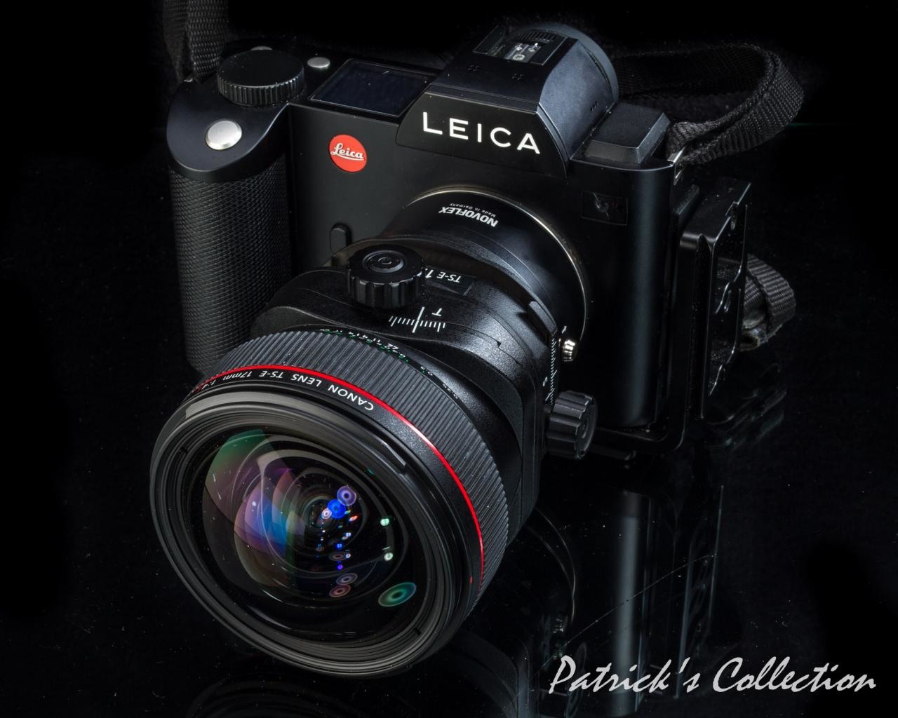

fcomarin69 Posted October 30, 2015 Share #7 Posted October 30, 2015 (edited) Advertisement (gone after registration) I have adapt the Canon TS 17mm and the 24mm II on the T with the Fotodiox EOS-L/M and M to T with ok results since focusing is the problem here. However yesterday during a pre-launch here in Singapore, I mount the 24mm on the new SL with tripod and I like the results. The focusing was easy thanks to the peaking focus. (I have pre-aperture in the lenses at f8 since still no way to communicate the EOS with the LEICA, please listen "metabones"). Now, I only was able to use the camera for 15 minutes and next week I book a full drive test with the camera and I will be using this 2 lenses without any hurry and I will be able to be more selective and challenge the lenses + SL and se how respond the optics and the sensor. Edited October 30, 2015 by fcomarin69 1 Link to post Share on other sites More sharing options...

RoySmith Posted October 30, 2015 Share #11 Posted October 30, 2015 I have adapt the Canon TS 17mm and the 24mm II on the T with the Fotodiox EOS-L/M and M to T with ok results since focusing is the problem here. However yesterday during a pre-launch here in Singapore, I mount the 24mm on the new SL with tripod and I like the results. The focusing was easy thanks to the peaking focus. (I have pre-aperture in the lenses at f8 since still no way to communicate the EOS with the LEICA, please listen "metabones"). Now, I only was able to use the camera for 15 minutes and next week I book a full drive test with the camera and I will be using this 2 lenses without any hurry and I will be able to be more selective and challenge the lenses + SL and se how respond the optics and the sensor. How does one "pre-aperture" the lenses at f8? Link to post Share on other sites More sharing options...
mgrayson3 Posted October 30, 2015 Share #12 Posted October 30, 2015 Put lens on Canon camera at f/8. Stop down manually. Remove lens. (Not sure if camera needs to be turned off before removing the lens.) 2 Link to post Share on other sites More sharing options...

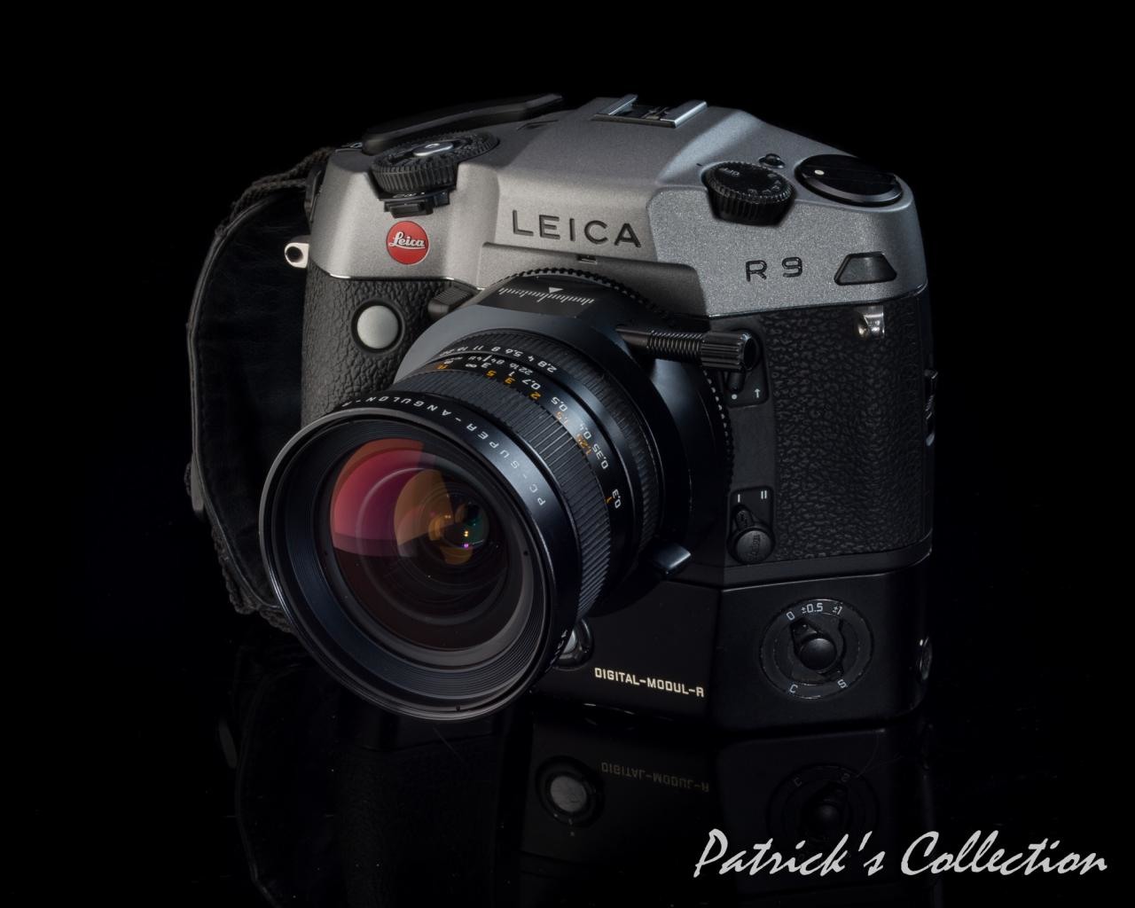

Manolo Laguillo Posted October 30, 2015 Share #13 Posted October 30, 2015 Yevgeny, I use the Schneider Kreuznach Super-Angulon-R 2.8/28 PC since at least 2011 with my M's (M9, MM and M240), with beautiful results. The copy of the lens is of course important: there are some which are ok, others are so so, some are bad... The last I've found was new, and works as it should. The Nikkor PC lenses are ok (28 and 35), with a caveat: look at the amount of shifting, and don't go beyond that limit. There is also the PA Curtagon, again for the R. But I don't have experience with it at all. 1 Link to post Share on other sites More sharing options...

fcomarin69 Posted November 2, 2015 Share #15 Posted November 2, 2015 How does one "pre-aperture" the lenses at f8? As mgrayson3 said. Once is set to F8 or F11, turn off the canon camera or any other that you use with a electronic adapter from EOS to xxx , then remove lens. It should keep the aperture without problem. Link to post Share on other sites More sharing options...

steppenw0lf Posted February 24, 2017 Share #20 Posted February 24, 2017 Why don't you use the R 28mm shift lens ? It is excellent (I used it already on the R cameras). I also thought about adapting some midrange lenses, but found it in the end too tedious. The R 28 PC-Super-Angulon is good enough for me and still relatively handy. http://www.overgaard.dk/Leica-M-Type-240-aka-Leica-M10-digital-rangefinder-camera-page-33-The-Leica-R-Lenses-on-Leica-M240-Catwalk.html (after the middle of the report). 1 Link to post Share on other sites More sharing options...
