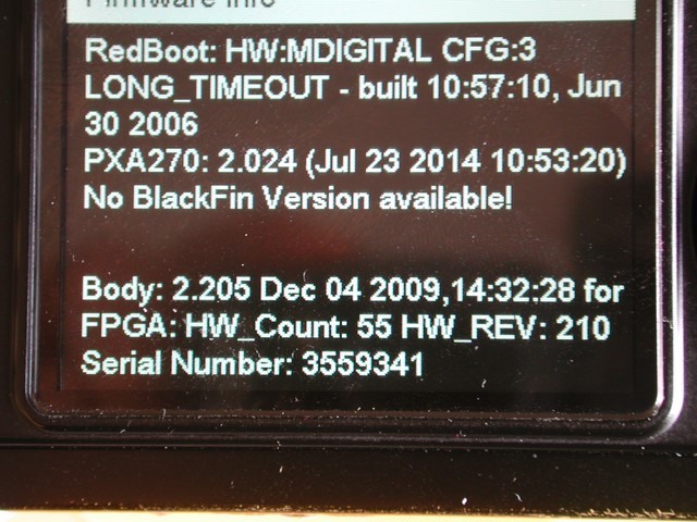

artem Posted January 30, 2017 Share #42  Posted January 30, 2017 Good evening,  I made the same mistake today, without reading this Thread, did update today my M8 with SN, 3199xxx to FW version 2.024 and was suprised to see that when I take any picture the red light blinks long and nothing happens..  Then did find the older FW 2.014 and did go back to FW 2.014 and everything works again..  Will never upgrade my FW again.. unless there is a reason to do that..  Cheers  Martin Link to post Share on other sites More sharing options...
1696413486 Posted February 28, 2017 Share #43 Â Posted February 28, 2017 I have the simmiliar problem: Â Yesterday I tried to upgrade my M8 to 2.024 but it told me failed.And then I try to upgrade again but it tells me the battery is too low for upgrade(which was 100% full). and then I open my camera and it says the firmware is 2.024, but I can't take shot with it. The shutter just do not respond and makes no sound. I wonder if I can roll back to 2.014, but it seems my camera won't recognize the file. Is there any resolution for this? Â It just like a piece of iron and can do nothing now. I went to the Leica store they just suggest me to send it to germany WTF!? Â HELP ME PLS.... Â Â Link to post Share on other sites More sharing options...
1696413486 Posted February 28, 2017 Share #44  Posted February 28, 2017 Good evening,  I made the same mistake today, without reading this Thread, did update today my M8 with SN, 3199xxx to FW version 2.024 and was suprised to see that when I take any picture the red light blinks long and nothing happens..  Then did find the older FW 2.014 and did go back to FW 2.014 and everything works again..  Will never upgrade my FW again.. unless there is a reason to do that..  Cheers  Martin Could you pls tell me how did you go back to FW 2.014? That would be very helpful for me,thank you! Link to post Share on other sites More sharing options...
lct Posted March 1, 2017 Share #45  Posted March 1, 2017 Welcome to the forum. You may wish to try this:  1/ Download "m8-2_014.upd" and "m8-2_024.upd" files here: http://tinyurl.com/z2lz8kw http://tinyurl.com/gqymvtq  2/ Make sure your battery is completely charged. Choose another card and format it with SD Formatter. Copy the "m8-2_024.upd" file to it, switch the camera off, insert the card in it, switch the camera on and try to redo the firmware update. If the firmware update screen doesn't appear, press the shutter button and hold it down until you see it.  3/ If this does not work, format again the card with SD Formatter. Copy the "m8-2_014.upd" file to it, switch the camera off, insert the card in it, switch the camera on and try this earlier firmware update. Again if the firmware update screen doesn't appear, press the shutter button and hold it down until you see it.  Hope this helps. Link to post Share on other sites More sharing options...

sixteen pads Posted March 3, 2017 Share #48  Posted March 3, 2017 Hey 169837498734  I have gone through this nightmare few months ago. With my Leica m8.2 , while upgrading the firmware to 024.  The only solution I found after multiple tests, cards, wipes and whatever other solution I could think of was to call up Leica and tell them the firmware update has corrupted my camera. The camera went to NJ Leica and was brought back to life free of charge. Came back with 024 firmware version but cleanly installed , with no issues.  So If I were you and were willing to part with your camera for few months, this sadly would be the only solution that I have found to remedy this firmware crisis. Leica service people know about this bug and seem to be willingly wanna help to fix it.   good luck ! Link to post Share on other sites More sharing options...
