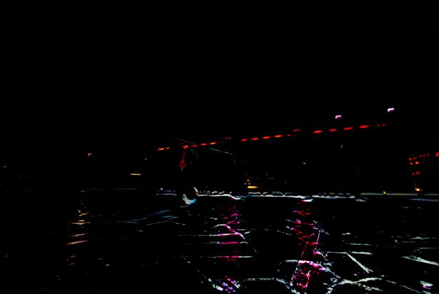

Farel Posted June 9, 2018 Share #38  Posted June 9, 2018 It hapen again yerterday .. grrr   https://www.l-camera-forum.com/uploads/gallery/album_5885/med_gallery_40126_5885_70628.jpg Quote Link to post Share on other sites More sharing options...
Steve Ricoh Posted June 11, 2018 Share #39  Posted June 11, 2018 It hapen again yerterday .. grrr   https://www.l-camera-forum.com/uploads/gallery/album_5885/med_gallery_40126_5885_70628.jpg Is the shutter making a different sound when this happens, ie like it hasn't tripped correctly? I knew instantly that I had a black frame by the shutter noise. Chimping would confirm. Quote Link to post Share on other sites More sharing options...
