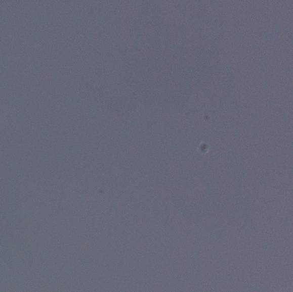

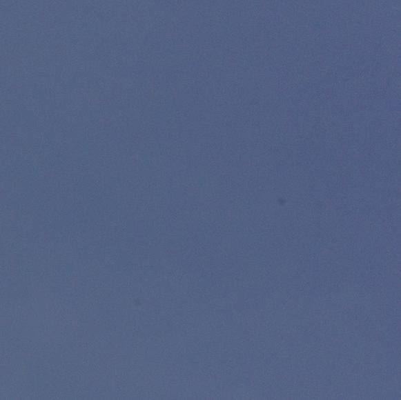

Ok, here's the shocker, I've now gone back into photoshop and had a good look at several blower brush sensor cleaning test shots I made in August 2013 which clearly show many of these weird circular rings with central dark spots and compared them with shots made a week or so ago and the more recent shots show far fewer of these marks although they do appear larger.
There was some confusion on my part evident in this earlier post caused by spots on the sensor that I had subsequently managed to remove and were therefore neither de-lamination nor corrosion.
I've now had a chance to thoroughly re-examine files taken over a period of about 18 months. The first test I have was created in June 2013 and shows how the problem started. It appears in the same place in subsequent tests and in each test the number of the rings with dark centres and lighter outer halo on the sensor has increased. I believe this to be de-lamination which seems to be the precursor to corrosion.
The first image was made on the 29 June 2013, the second today. Both were shot with the same 35mm lens at 1/125 sec at f16. Both are shown at 100% and are towards the top right of the sensor. The sensor now has about 20 of these spots in total.
What to do? I own a two year old M9-P in immaculate condition with less than 1,000 actuations that I couldn’t sell even if I wanted. I can’t afford to be without the camera for more than a month or so. It seems the turnaround for the “repair” is far greater. If that’s the case it would mean that through no fault of my own I would have to dig deep in my pockets and buy another camera, which perhaps understandably is not something I’m keen to do. I’m also less than happy with a replacement substandard sensor; not my idea of a fix. If I leave it and do nothing the problem is only going to get worse. At this stage if Leica were to offer a fair upgrade that’s probably the route I’d take but thus far there has been no such fair offer.
Not a happy bunny.
http://www.keithlaban.co.uk/M9_P_Test1.jpg
http://www.keithlaban.co.uk/M9_P_Test2.jpg
Edited by KeithL

I would say it's not worth sending the camera away for a few delamination spots. I sent mine when it had over 100. Of course that is unless it's nearing the end of its warranty, then it is highly recommended :)
Well, it's over two years old now which means it's out of warranty. But Leica have said on this forum they will in any case "fix" it for free if it's under three years old, so I have some time on my side to watch for developments.
